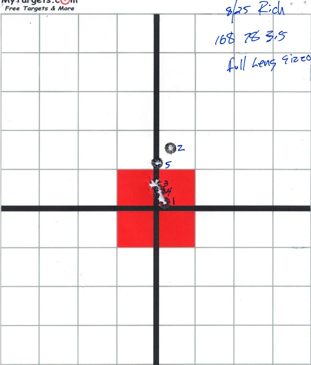

    I just posted the same problem in the reloading section.
    I also shoot a 300 win mag off the bench without a brake. I chrono all my rounds, very close in std deviation, small ES, etc, etc. Played with loads etc, etc. Still get vertical, driving me crazy.
    I am going to the range on Wednesday to see if the solution works, but all indications are that it is related to pulling the stock too hard into your shoulder to reduce recoil. Diagonal stringing I was told was related to increasing shoulder pressure as you pull the trigger, maybe subconsciously, again a shooting technique defect related to anticipating the heavy recoil. I solved the diagonal problem with consistent shoulder pressure, now I need to lighten-up on the shoulder weld in general. This makes sense as if you are pulling into the shoulder, the barrel will have more of a tendency to lift as recoil starts.
    This makes even more sense as I have been known to screw-up the money shot, where I get the first three or four in nearly the same hole, maybe .25moa at 100yds, and the 5th goes high. Could have something to do with pulling the gun in closer to firm things up for the last shot?
    The chrono on this one shooting 168 AMAX with 78gr H1000 and mag primers:
    2,904
    2,917
    2,936
    2,930
    2,930
    for a std dev of 12.9, not my most consistent, but o.k. as these were unfired, full-length sized, new brass.
    Alternatively, it could also be related to inconsistent eye relief but I think the shoulder pressure is the culprit as I have a process that gets me to the same eye relief.
    Let me know if you get anywhere, good luck.

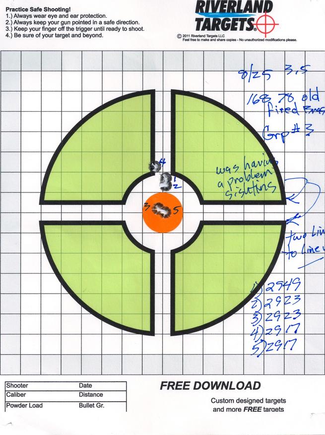

    Here's another example where I relaxed after shots 1,2 so 3 went in the hole, then tight for 4 and relaxed for 5.
    Chrono was on the sheet:
    2,949
    2,923
    2,923
    2,917
    2,917
    for std dev of 12.6.
