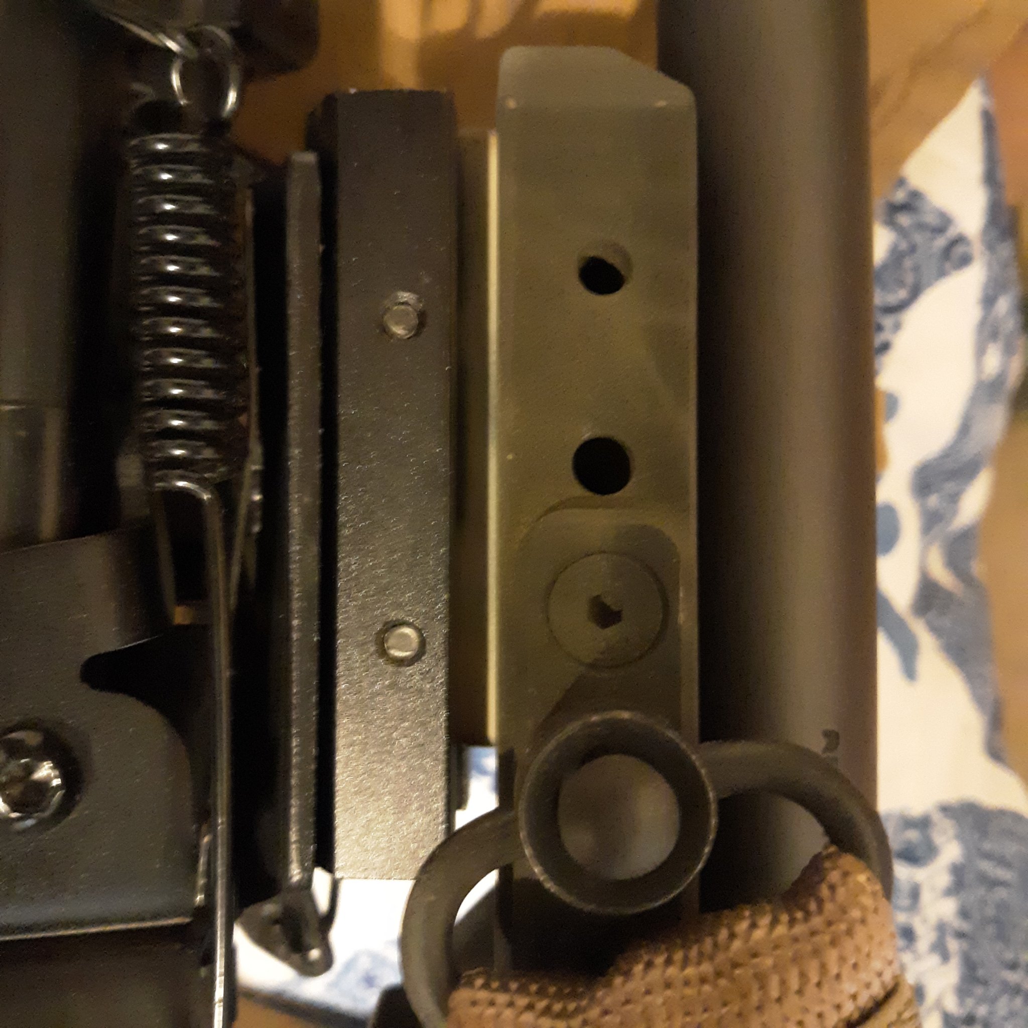

Necro thread. But I have been fighting vertical lately. I raised my bipod to get more of my chest off the ground. I then wrapped my thumb around the pistol grip. I found when putting my thumb on the shelf I was pushing forward with my thumb while squeezing the trigger.

I am pretty sure I have a problem with " if using a rear bag, giving up on the shot...basically relaxing the rear bag hand at the same time the trigger is pressed (if its this you should be able to see it on recoil...your rifle will be pointed high after the recoil impulse)"
Either that or the butt stock is too low on my body and recoil is pushing it down, but it happens with a heavy 22lr so... probably not that? I think I am going to set up a gopro to be pointed at my support hand the next time I go out and see if it catches me in the act. (It does not happen during dry fire practice).
Dry fire your mind knows what is going on. Get the rear supported really good. So that you are not using your rear hand. Try it. That is what I had to do. Good luck!
I like to envision myself holding the trigger pull and hold as the bullet is flying to the target till impact.
like I’m guiding a missile.
