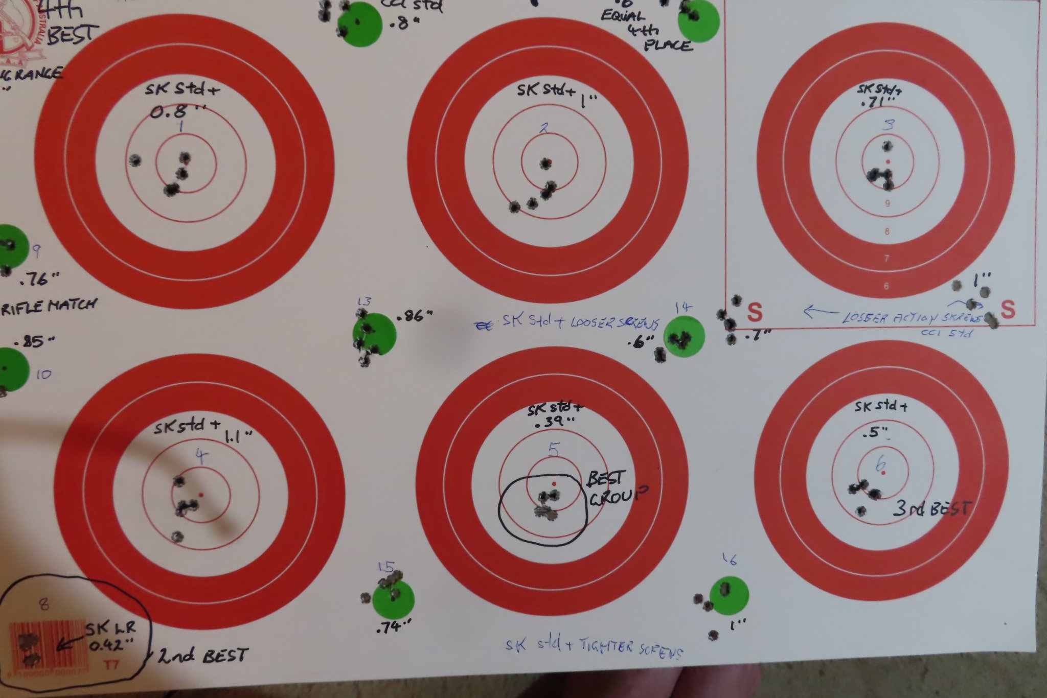

Well I went to the closer indoor range again and the long saga seems to be resolved.
The first 2 shots were on target and I shot a few .4" groups at 50m.
No wild vertical stringing at all.
I think cleaning the bolt fixed it and I tried backing off and tightening the action screws just to see.
It shot fine at all torque settings so it's not sensitive to that.
I didn't shoot any real good single-ragged holes but got a couple of .4" touching groups so that will do me.
It felt so good and has been months.

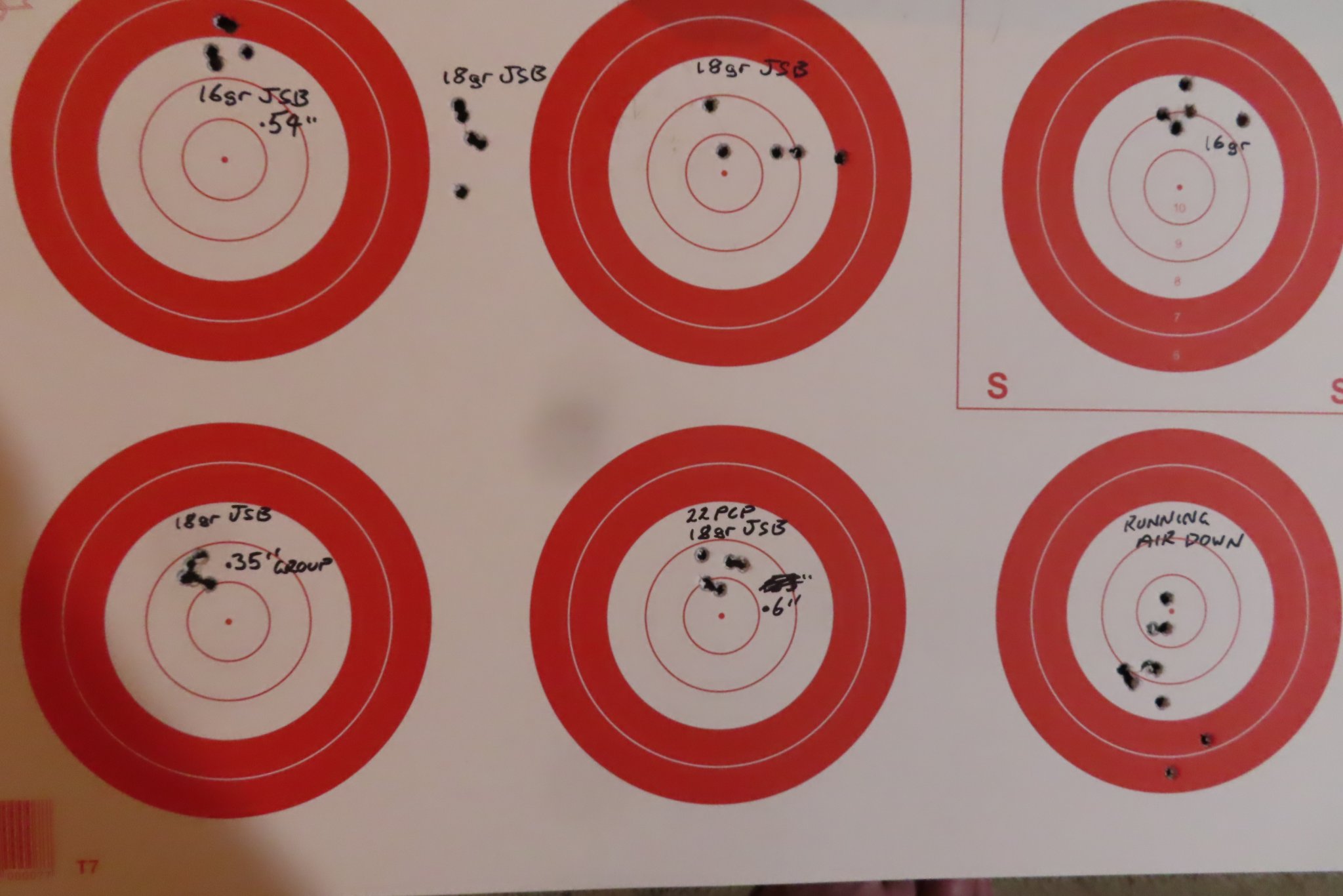

The other pea-shooter, a .22 PCP air rifle also shot like a laser when I thought it had lost a bit.
Shot 2 groups under .4" at 50m so that is still shooting fine as well.
I just have to verify that it shoots well again outdoors and all's well that ends well.
