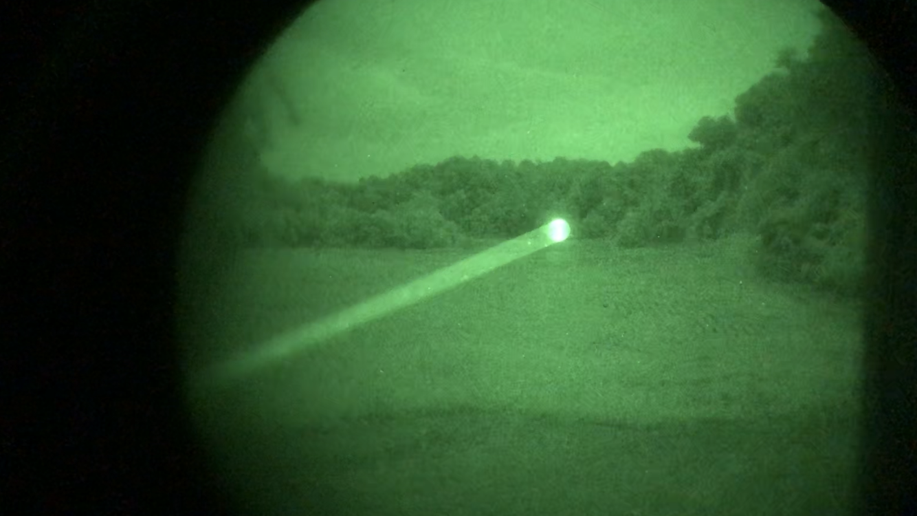

    Yeah, once you pop that Training Bra off that puppy, here is what she will do at 1,000 yards. :LOL:
    Reactions: Jgunner
