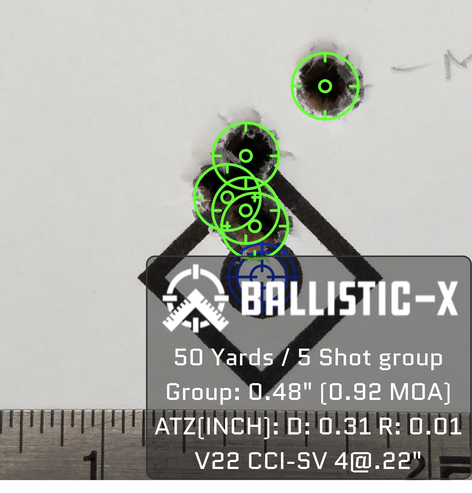

Try CCI SV 50rd paper boxes. It will tighten the head space issue and should shoot with Eley Club. In my Vudoo the SV smokes the two different lots of Club I've shot.

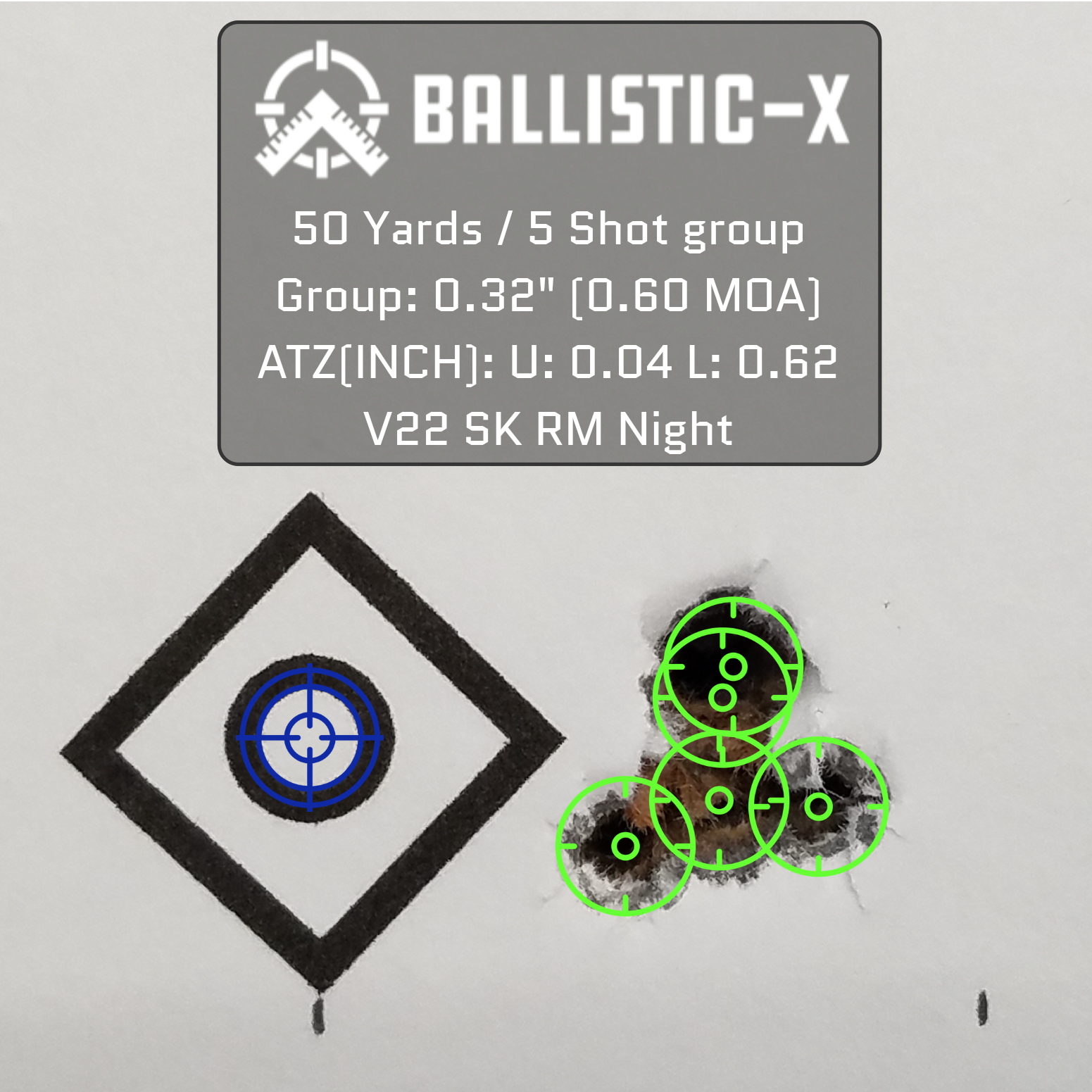

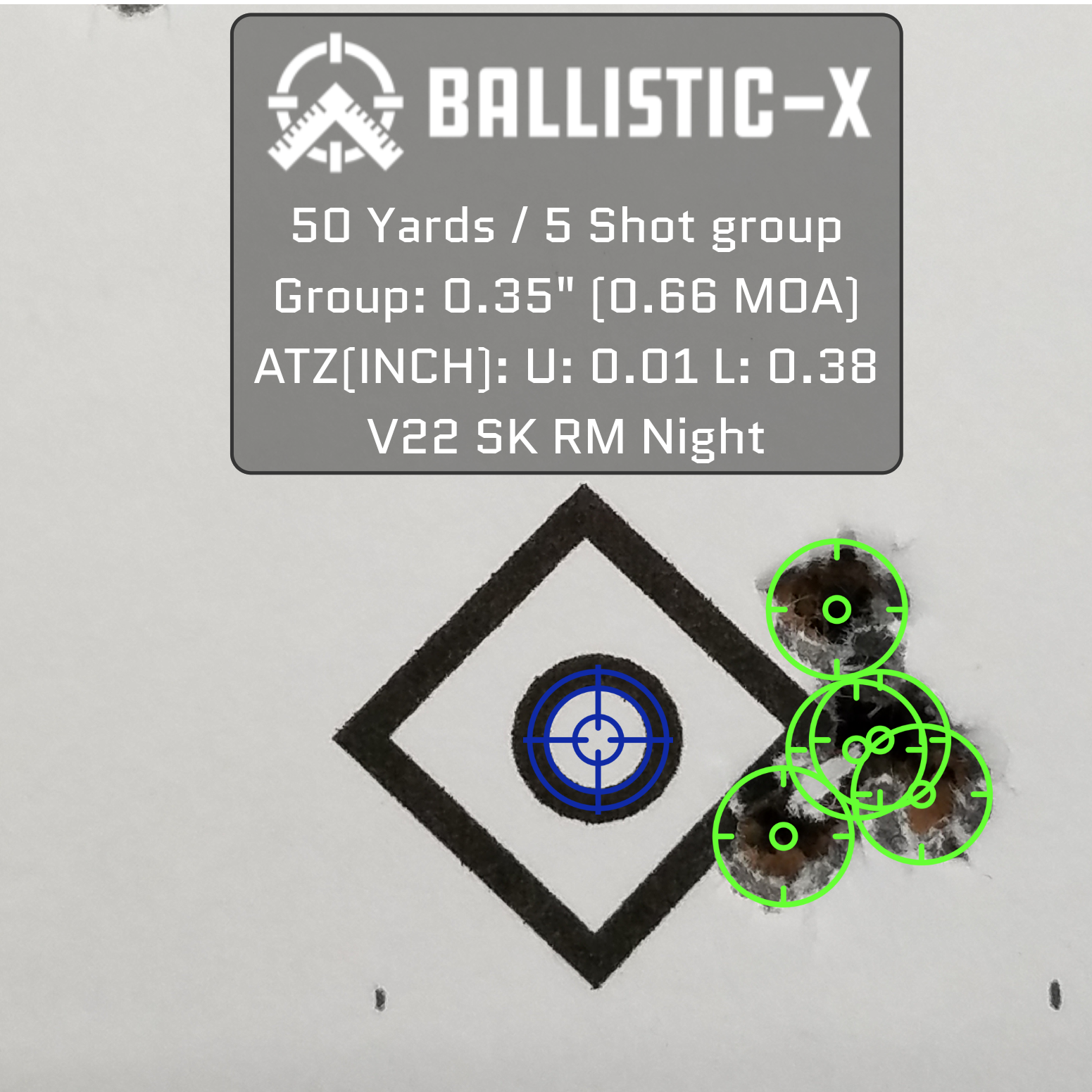

Lapua CenterX. I haven't had good success with anything else. Sometimes I feel like the only guy with a rifle that won't shoot ragged holes with cheap bulk ammo.
Ballistic-X-Export-2020-04-06 22:09:57.556663.png
Ballistic-X-Export-2020-04-06 22:12:30.371132.png
Ballistic-X-Export-2020-04-05 20:52:13.101114.png
My Vudoo shoots respectable with the lots of CCI SV I have. Center-X has never came close to the case of SK Rifle Match I have at 50/100/200 yds.

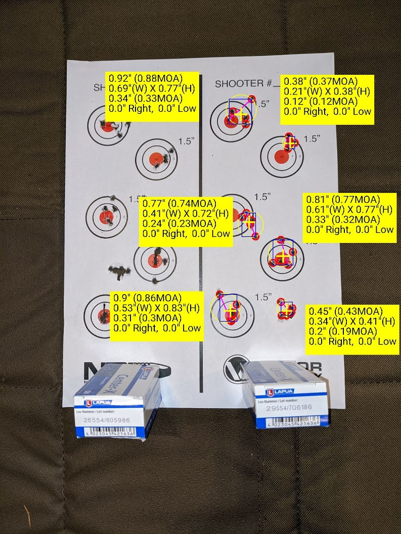

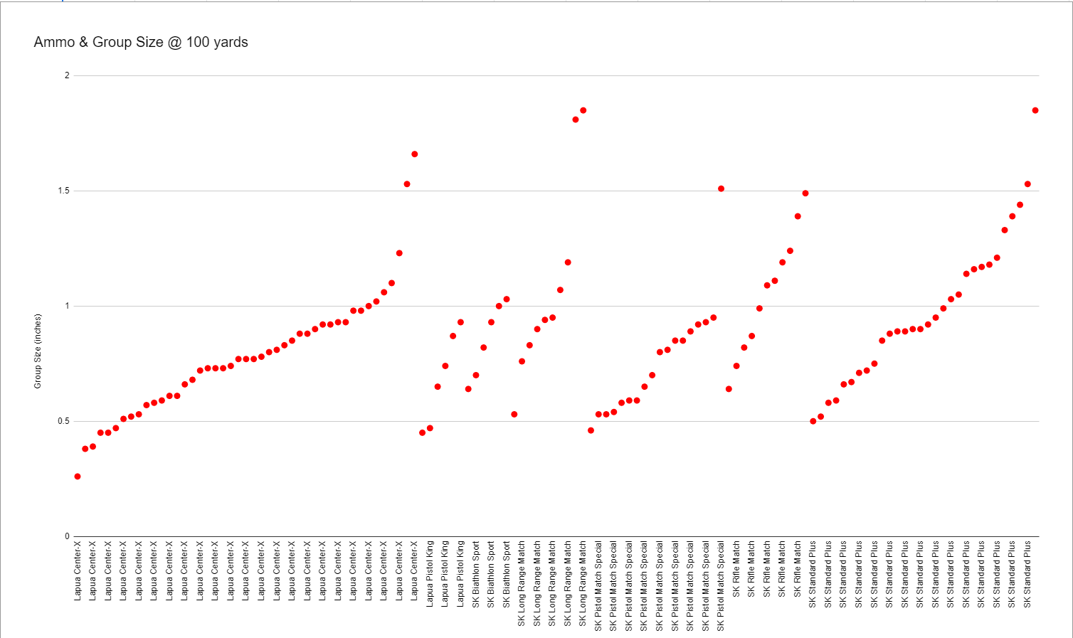

Littlepod your experience with CX matches my own. Would you happen to know the first two digits of the lot #"s and can you please report the rifle used for the stats? As for Wolf ammo about two years ago Lapua stopped making it and Eley began. You can tell which from the box and the headstamp. I would however, rank either Wolf higher than Eley Club.
Based on chronograph numbers from years of testing rimfire, Benny.
Match grade 22lr needs to have an ES of less than 40 fps to attain sub-moa at 100 yards.
The majority of the 22lr I've been shipped has been unable to attain that level of quality control.
The few batches that did do well, didn't with the next batch delivered.
Add in shooter skill level, cartridge defects, rifle, setup stability, bench, wind...
it's extremely difficult to obtain consistent sub-moa at 100 yards with rimfire cartridges.
Even the indoor test facilities run by Lapua, Eley and RWS show problems at 100 yards (meters?)
That's why lot testing is critical for those who compete at the top levels.
Trying to find the quality ammunition that will allow them to win.
They have to work at it.
