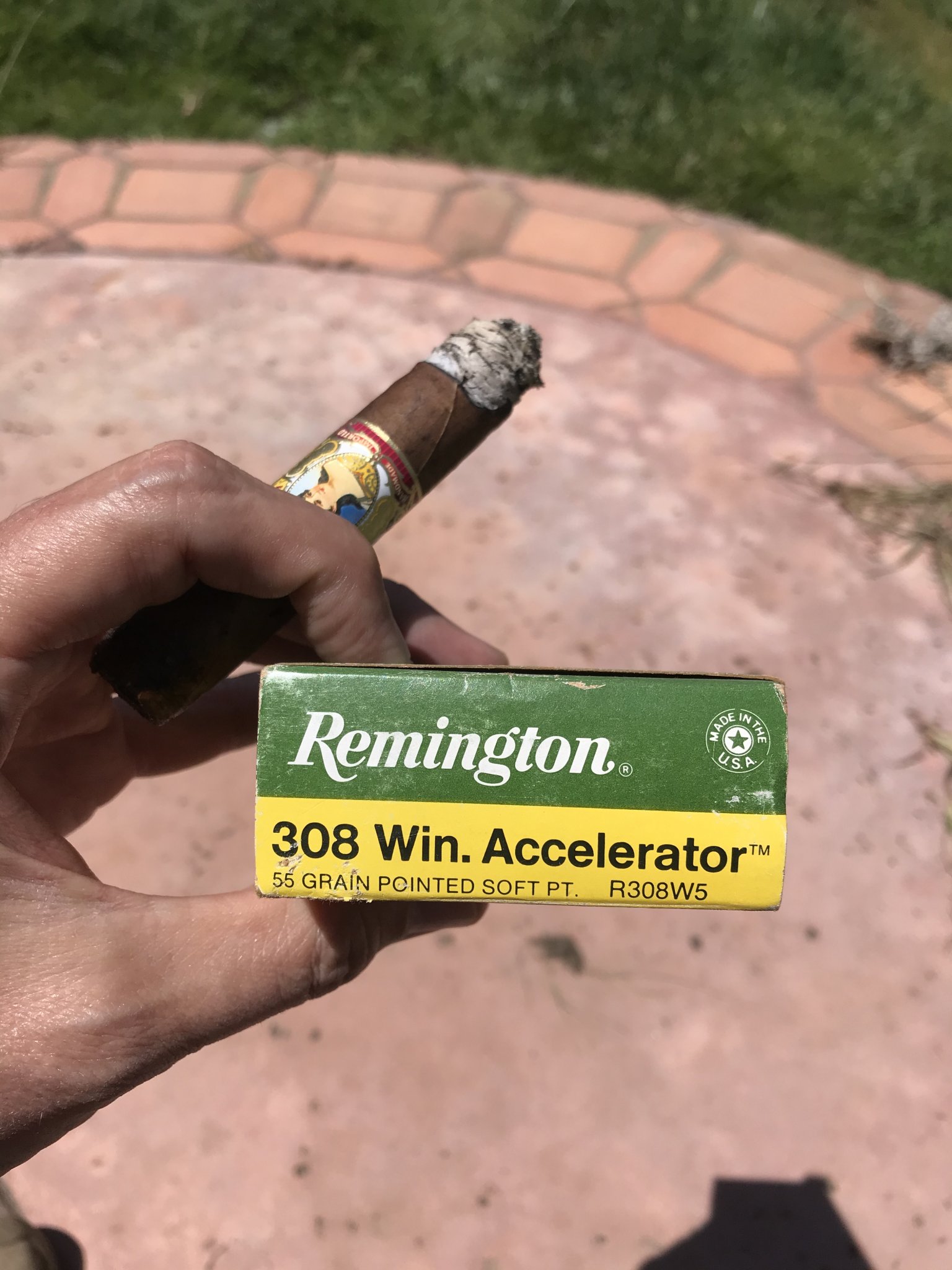

See again my childhood. You could buy sub caliber sabots to load your .50 BMG with smaller pills at super high velocity. The military version of this is the SLAP, of course. We looked at it for use in CSW - the .50 BMG variant was successful and somewhat wide spread, the 7.62 mostly flopped. Two interesting points - one of the Scandinavian countries was using a 7.62 NATO SLAP variant (@ ~4400 fps) in their sniper weapon systems and supposedly cited about a 33% degradation in accuracy; for a long time you could buy “accelerator” ammo in .30-06 that featured a little .22 cal bullet @ roughly that same ~4400 fps. No reports from me on accuracy of the latter.

If you loaded a sub caliber mono projo you could probably do it, not sure if 308 case has enough gas.
Remington got mid-high 3000s with this stuff back in the day.
