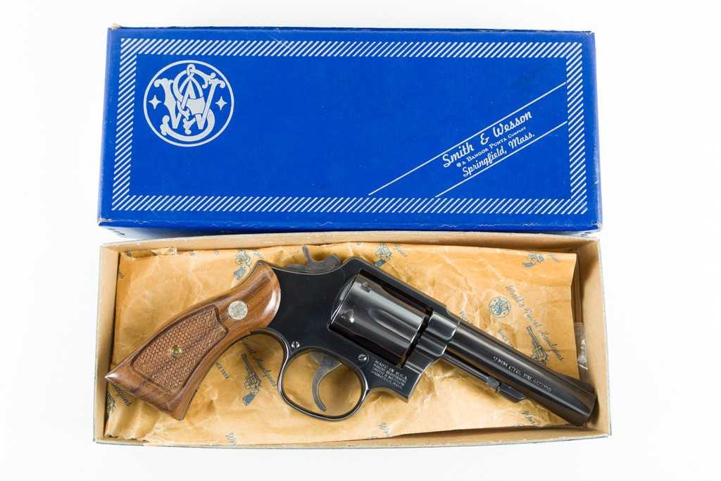

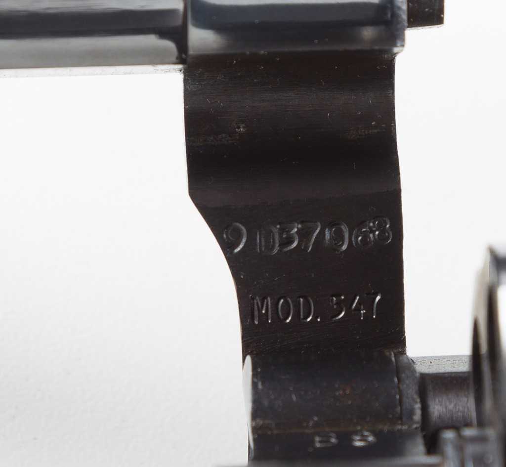

This thing is in incredible condition and is a rare find for sure. Smith and Wesson model 547 9mm revolver this has a very unique history which I'll put below.
Cash Price is $1540 Shipped and insured
The gun itself is extremely clean and has probably been fired very little I'm guessing it's spent most of its life in the original box which is included along with paperwork cleaning rod etc and the box is fully intact. This is a collectors/investment quality piece for sure.

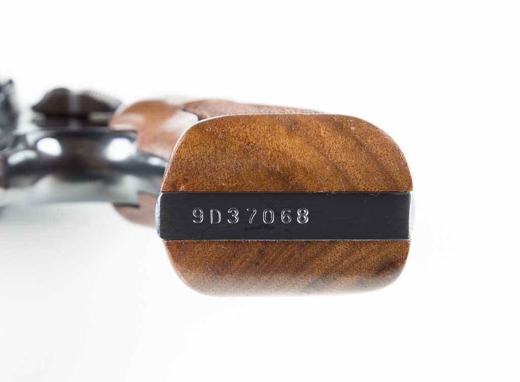

Have you ever seen a 9mm revolver that didn't use moon clips? Now you have. This is the S&W Model 547. It is a heavy barrel, 9mm (9x19) version of the legendary K-frame, 6-shot M&P revolver. S&W made 10,270 of these from 1980-1985; 6486 round with butt (and 3" barrel), and 3784 with a square butt and 4" barrel (as pictured below). Supposedly, this was the most difficult-to-manufacture revolver that S&W ever made.

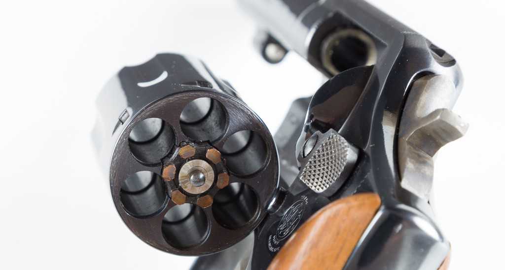

There are two problems that have to be solved before you can make a moonclip-less 9x19 revolver:
  1. How do you extract the cases?
  2. How do you keep a tapered cartridge from backing up when fired and locking up the cylinder?
Question #1 - How do you extract the cases? - was answered by Roger J. Curran of Stratford, CT in the form of patent number 4127955 - Extractor assembly for rimless cartridges. Instead of the usual "star" type extractor, the Model 547 features a horn-shaped extractor (see picture 5 above) with small beryllium-copper spring tabs that grab the rim of each case. This assembly is for extraction only; the cartridges headspace on the mouth. The device works really well - I've never had a stuck case.
The second problem - tapered cases backing out and locking up the cylinder - was a familiar one to S&W. This same issue killed the Model 53 (.22 Jet) revolver. S&W overcame this in the 547 by adding a pin (above the firing pin) that prevents the fired case from backing up (see picture 6). This solution seems to be effective, as I've never had the cylinder lock up in all the rounds I've fired. Speaking of firing pins, the one in the 547 is a floating pin. While this is common to most new S&W revolvers, it was unique to the 547 back in the day.
