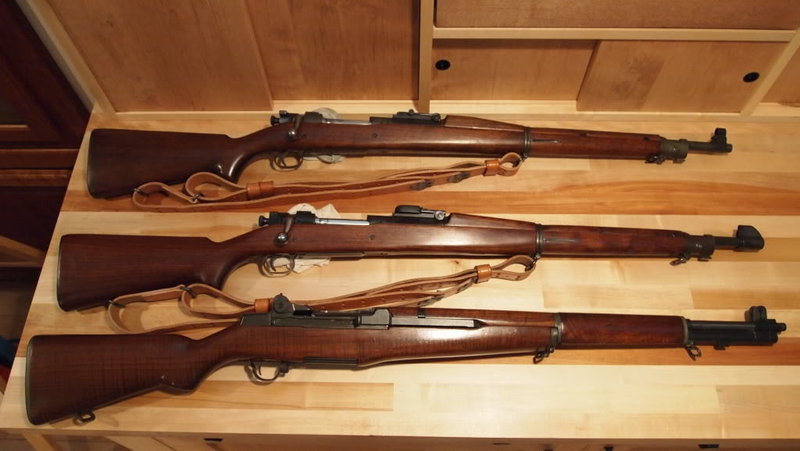

Firearms have been in my family since before I could talk. All our rifles received the strip/refinish with linseed oil treatment. It's a family thing. For me, it's also a fun process.
I've also done French polish, and did it with shellac on my old trio of Mosin-Nagant 91/30 stocks. I learned how by watching The Furniture Guys on PBS.
Back when I was much younger, and starting to come around again, I built/build stick and tissue rubber powered free flight model airplanes. I do the finishing with nitrate lacquer, and have some experience with lacquer and acetone, aka dope and thinner.
The rifles I just worked on are probably stocked with either oak of birch; I think birch. The finish is decided blonde, and I took some care to leave a trace of the reddish brown stain before I started applying the oil finish. The grain is still somewhat unfilled. I'm leaving that for the next time (and the next time..., and the next time...) we fire them and I clean them, and that;'s when I'll rub in the next coat(s) of linseed oil.
As my Dad said, "Always leave something to do for tomorrow." I'm hoping for a bunch of tomorrows.

some of the guitars I did with traditional sunburnt finish were nitrocellulose lacquer and I tinted all the shades by hand. Those were fun too.
ps those stocks may be ash too... swamp ash if they are light and open grain.
