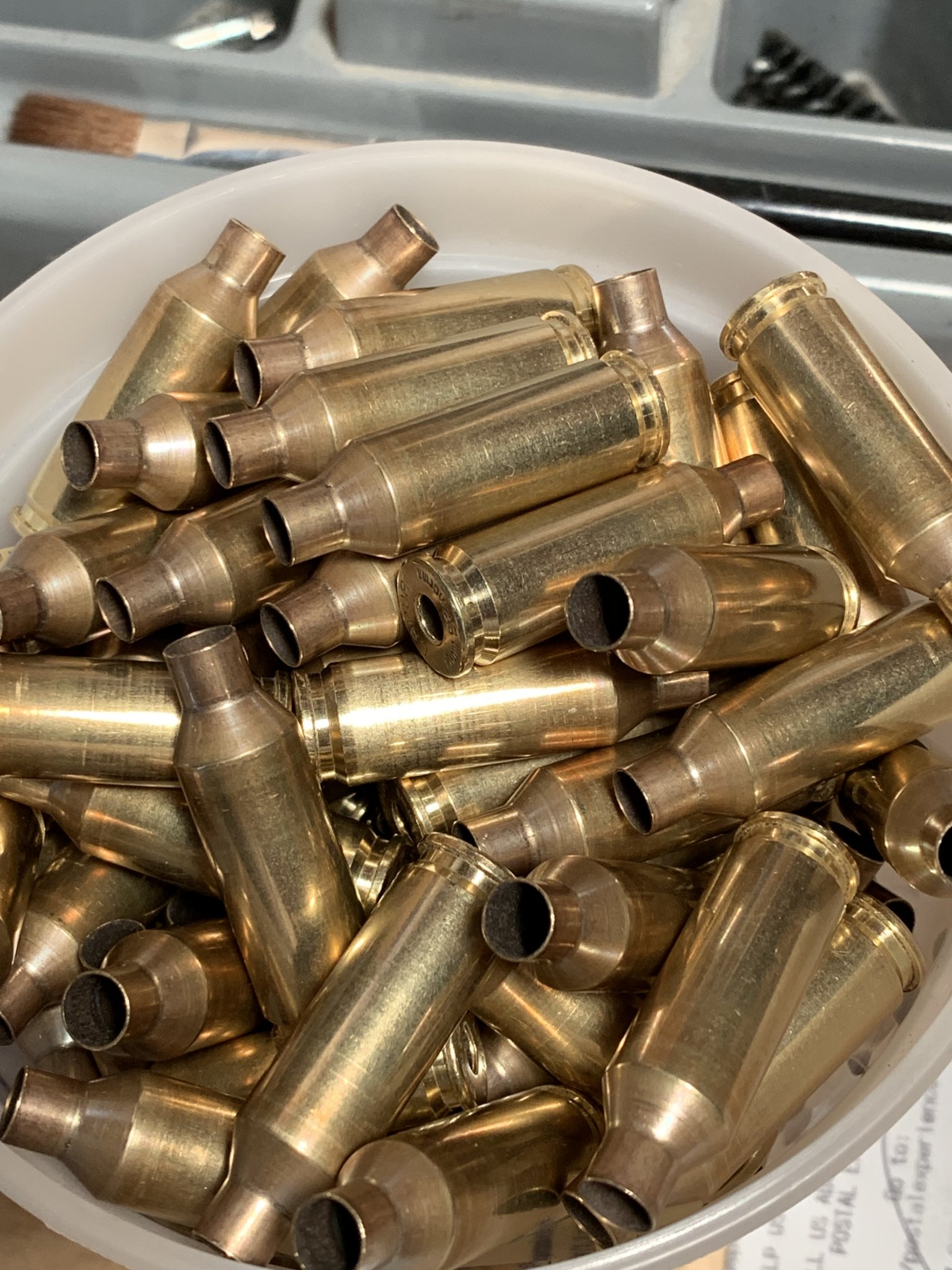

I started with pure corn but wasnt happy with the results / time. Added around 2 pounds stainless pins and it helped quite a bit. Hornady tumbler. Things went sideways from there. I had a discolored case one day and grabbed a scotch brite to try and clean it up. One thing led to another and I frequently chuck em all up and scotch brite em head to toe. Actually gotten pretty quick at it.
I started with pure corn but wasnt happy with the results / time. Added around 2 pounds stainless pins and it helped quite a bit. Hornady tumbler. Things went sideways from there. I had a discolored case one day and grabbed a scotch brite to try and clean it up. One thing led to another and I frequently chuck em all up and scotch brite em head to toe. Actually gotten pretty quick at it.View attachment 7072768View attachment 7072769
That looks good but I was hoping for less work not more. Haha

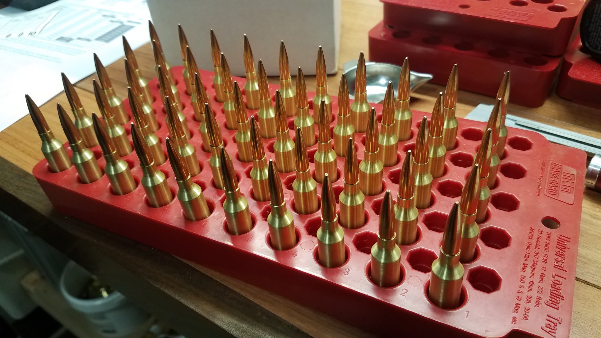

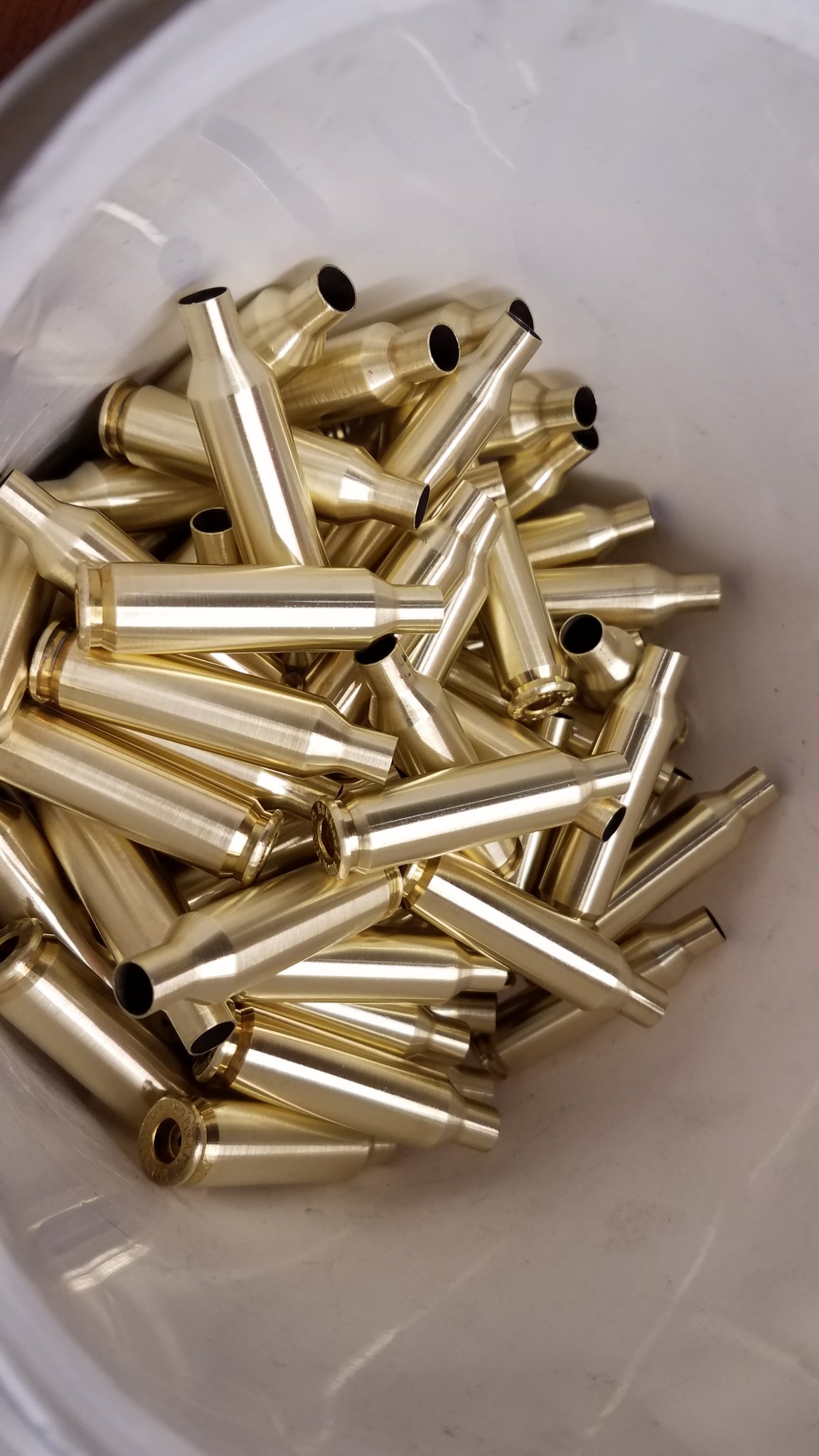

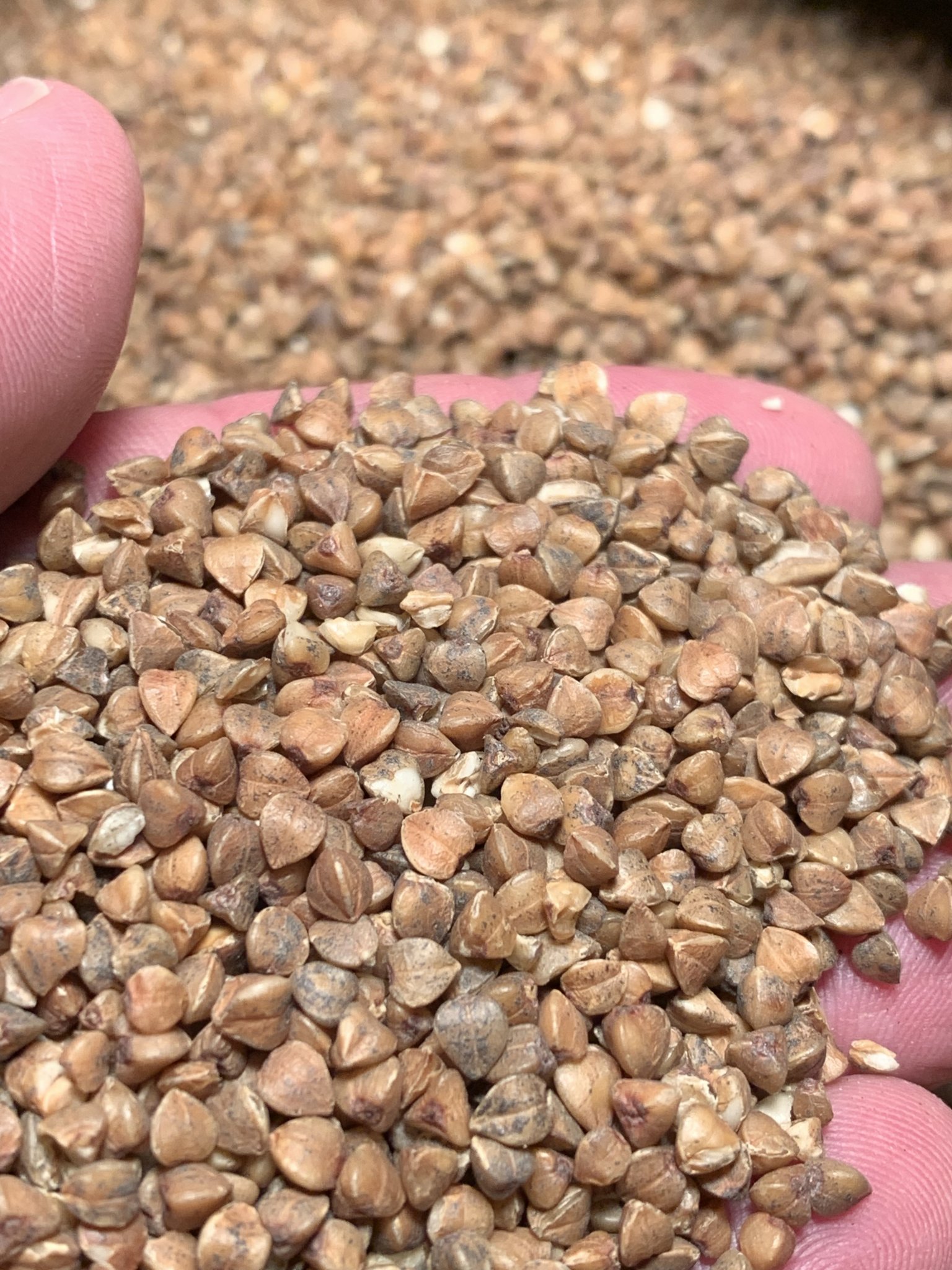

these buckwheat groats have tumbled at least 5000 cases probably closer to 8000....i sized the cases in the pic saturday after firing then tumbled for 20mins....zero dust with these...1 cap of car wax when new and run tumbler 1 hour before adding brass then when tumbling brass add 1 to 2 dryer sheets cut up into 1"-2" squares they keep the media clean and your brass shiny.

You have to use the ones I posted...plain buckwheat will turn to dust...run 1 cap of car wax and alway run dryer sheets...if you want your brass shinier make your run time longer no need for corn cob
Those are the ones I used, clicked your link. I may also be expecting more based what I like to see.
