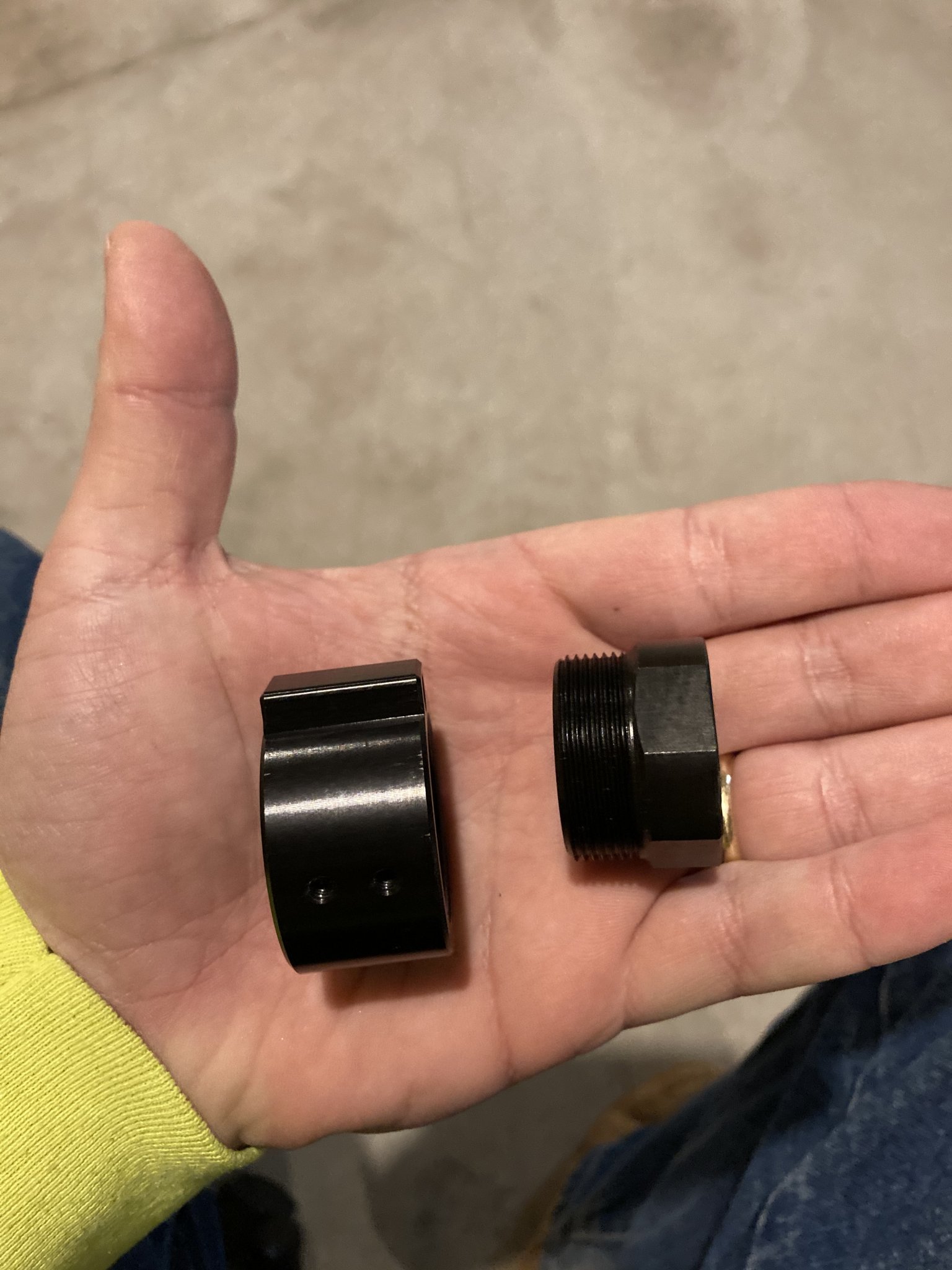

Ok that makes more sense. So it’s not actually going on the the receiver threads. Unlike most handguards where the handguard is actually clamped to the barrel nut and an anti rotation feature, this setup has nothing preventing the barrel nut from backing out. I still wouldn’t use it, but I can see where the logic comes from now.

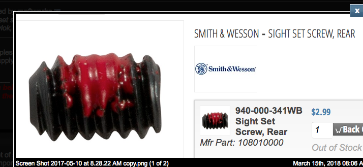

Vibra-tite VC-3 style are similar to Nylok products except available for the average joe to apply to fasteners; in contrast to Loctite variants where one color of adhesive is applied, then fasteners mated, Vibra-tite is applied to the fastener to cure / dry THEN the fastener is secured to its mate. Vibra-tite style products do not require heat to release the frictional bond and are meant for use / reuse so this style / or Nylok is commonly applied to rear sight set screws to allow for adjustment of the sight after assembly; unlike Loctite products.

An example of Nylok, note the application is not circumferential on the fastener threads; Vibra-tite is best applied in a similar fashion.
^^this, Vibratite doesn’t bond like normal loktite, you let it set up before assembly and it works sorta like nylok. Keeps stuff tight but no problem to take loose like loktite. Great stuff, after using the little one-use packages some manufacturers include with their products (like Odinworks) I bought a bottle off Amazon.
