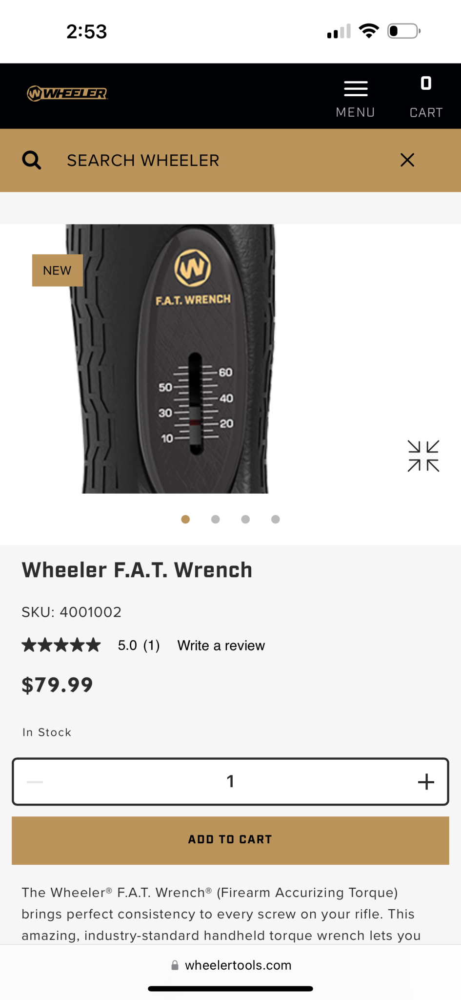

I had looked at the wheeler (and just did again) but unless I’m missing something terribly obvious it looks like a 5 inch pound increment, per the picture on their website.
Is there something that I am not seeing?
The wrench doesn't jump 5 increments. You spin the wheel on the bottom and you just stop when you hit what you want. Rough example: Do one rotation of the adjustment wheel after hitting X, to be X+1. If that makes sense.
On the FAT Wrench, the version/generation that I have, the indicator bar spans 5 in/lbs with the top of the bar used as the indicator for the desired setting. If I wanted 18 in/lbs I spin it up so that the 15 in/lb mark hits in about the middle of the bar so it'd be 17.5-18 lbs. That being said the accuracy tolerance on most torque wrenches is such that you could be +/- the indicated setting anyway so I wouldn't get too wrapped around the axle about it.

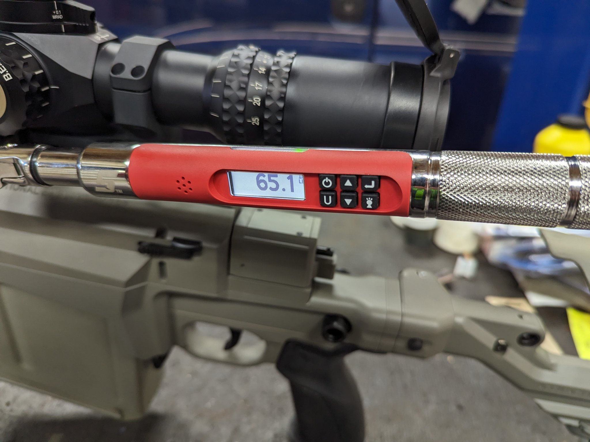

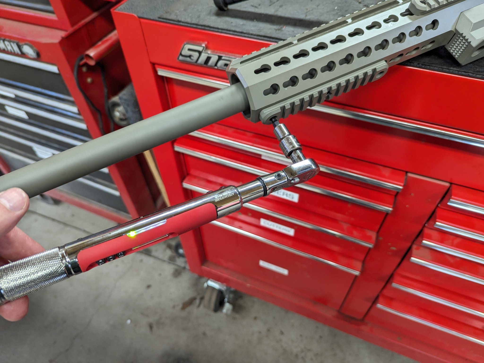

@E. Bryant, is that thing even calibrated? Engineer types have all the cool tools.
In all seriousness, Loc-tite is my vote.
Reactions: ohiofarmer
Those with the signed NIST certificates cost a whole lot more.
CDI submits them in batches…
That model, despite the price - is not sold with a NIST certificate.
It actually has the same innards as a Taiwanese GearWrench.
