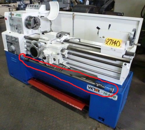

Was looking on ebay again, and saw the same stock# lathe on a different listing that I linked above, and this time it says it comes with a Sony DRO. They must have had their specs off when they first listed it and corrected it. I feel like this is a pretty sweet deal now, especially since its listed as best offer also, and only 3 hours from me. Might try to go take a look at it tomorrow if weather permits.
Here is the listing
Victor Lathe No 1640B Gap Bed 16" 23" x 40" DRO 27140 | eBay
What is the bar that looks like its attached to the tray/stand?
The bar I believe can be set to trip the carriage feed if I remember right? I ran an Osama Sr. for awhile and it had the same bar on it. Never actually used it but but I believe that that's what its for.

The victor looks like its setup for coolant, which I dont care much about other than already having the drip tray that will accomodate a high pressure flush system, but it doesnt specifically say it has coolant (I just see the pipe attached to the carriage).
