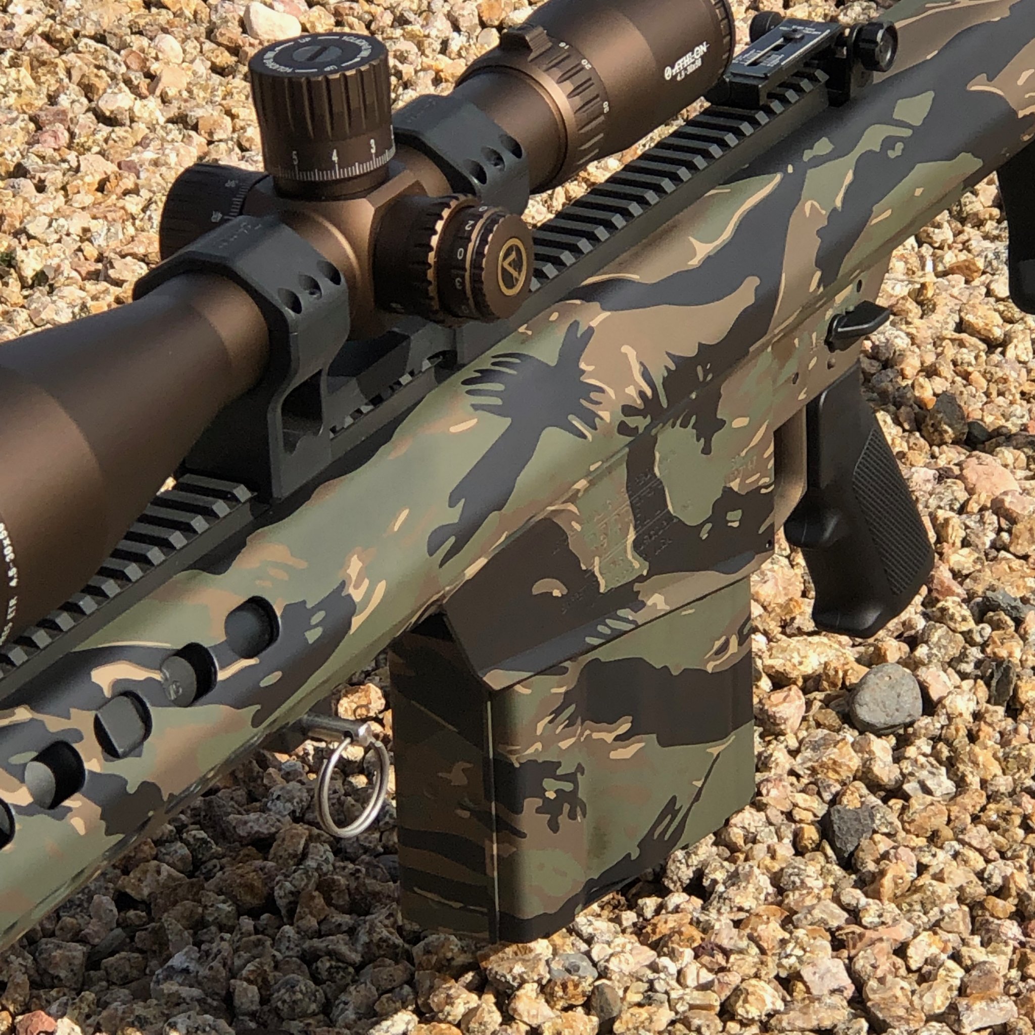

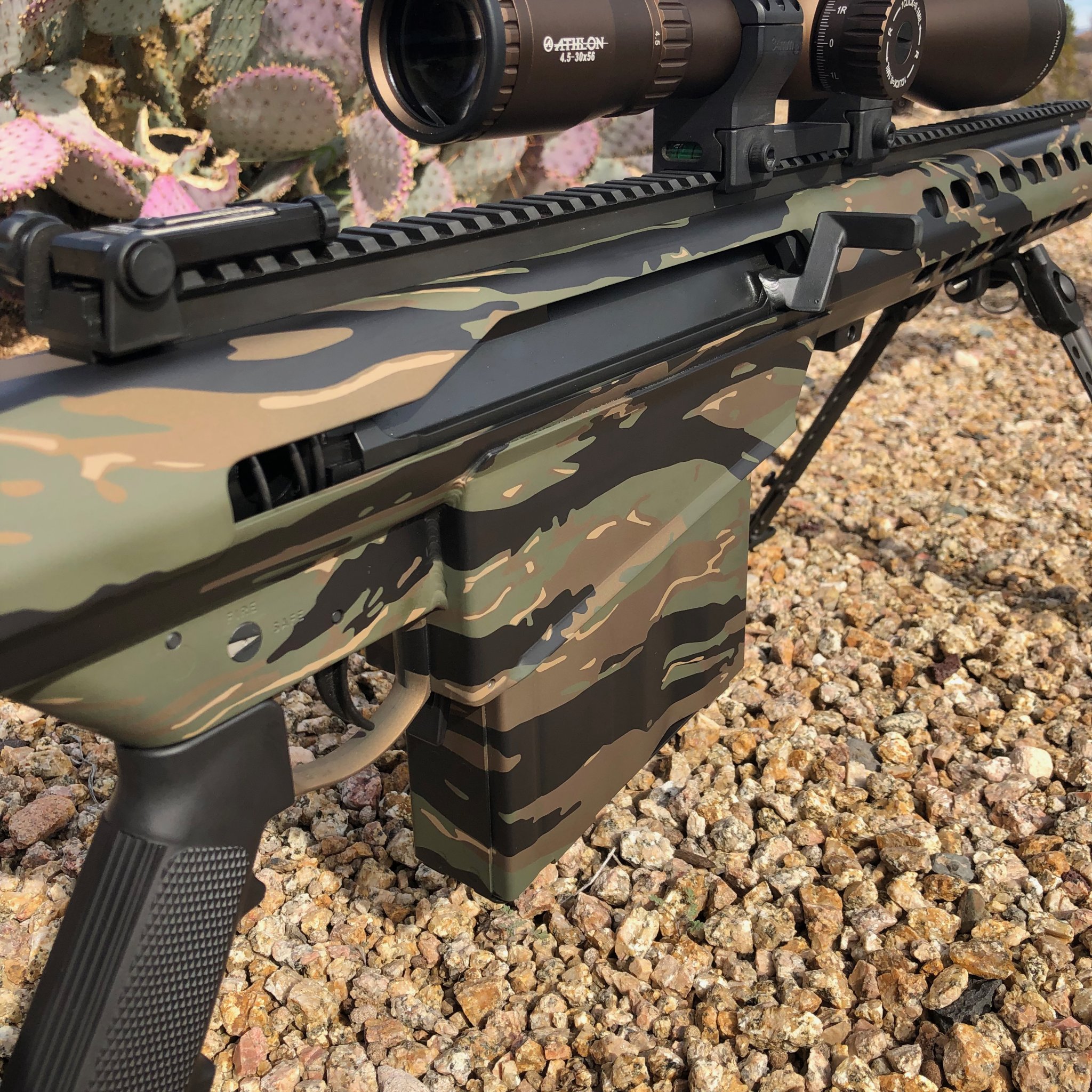

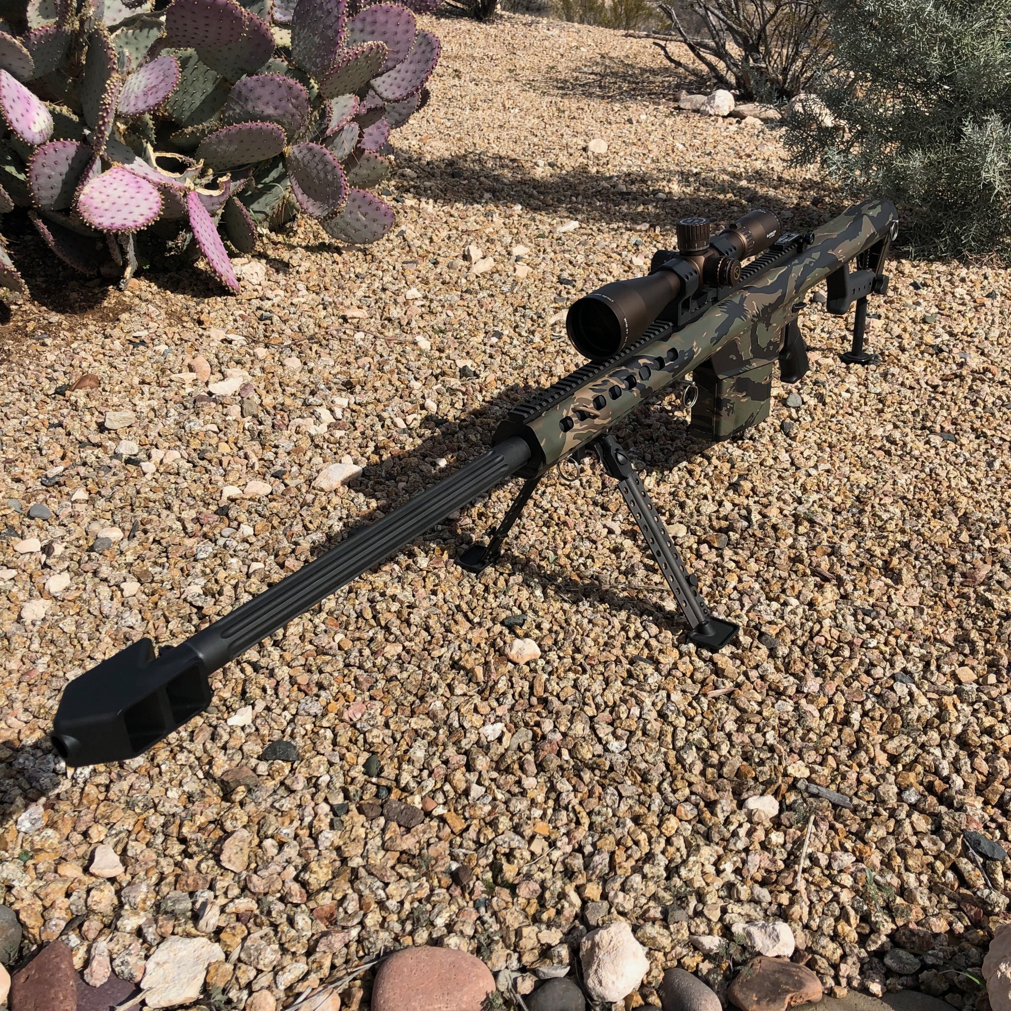

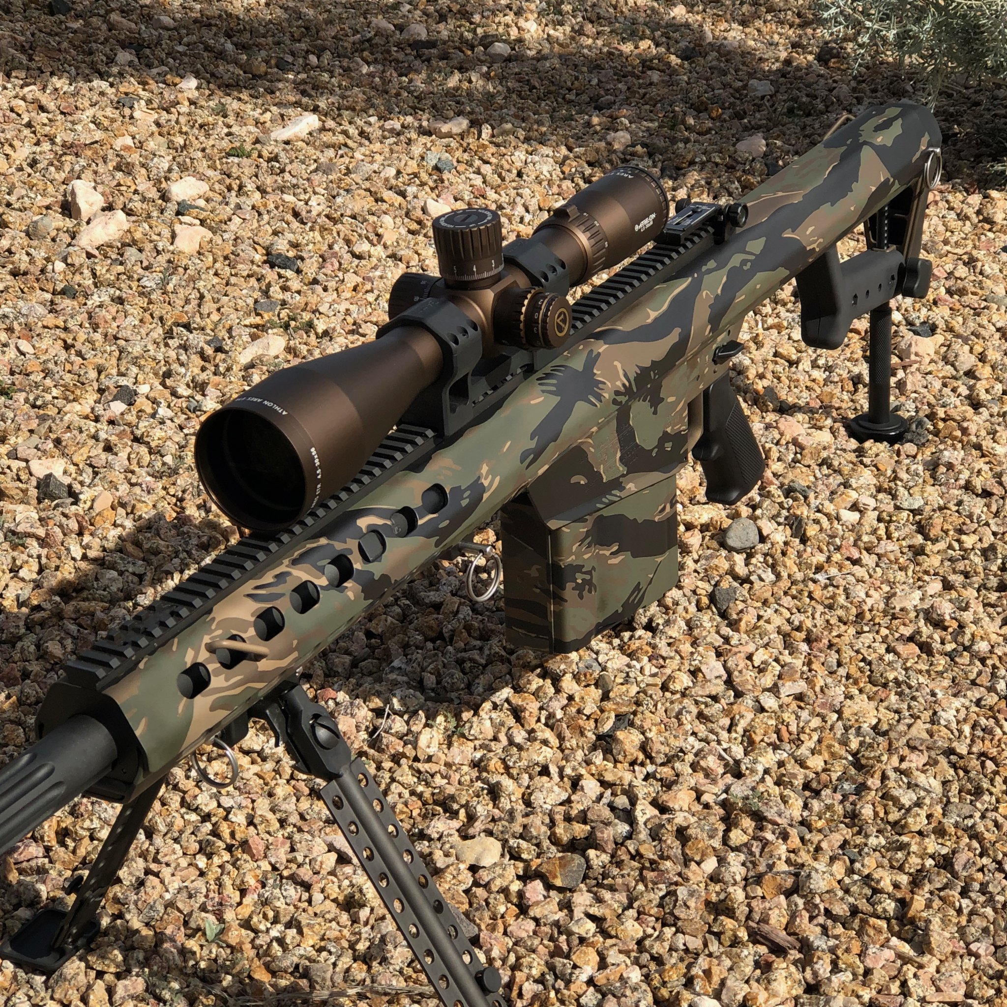

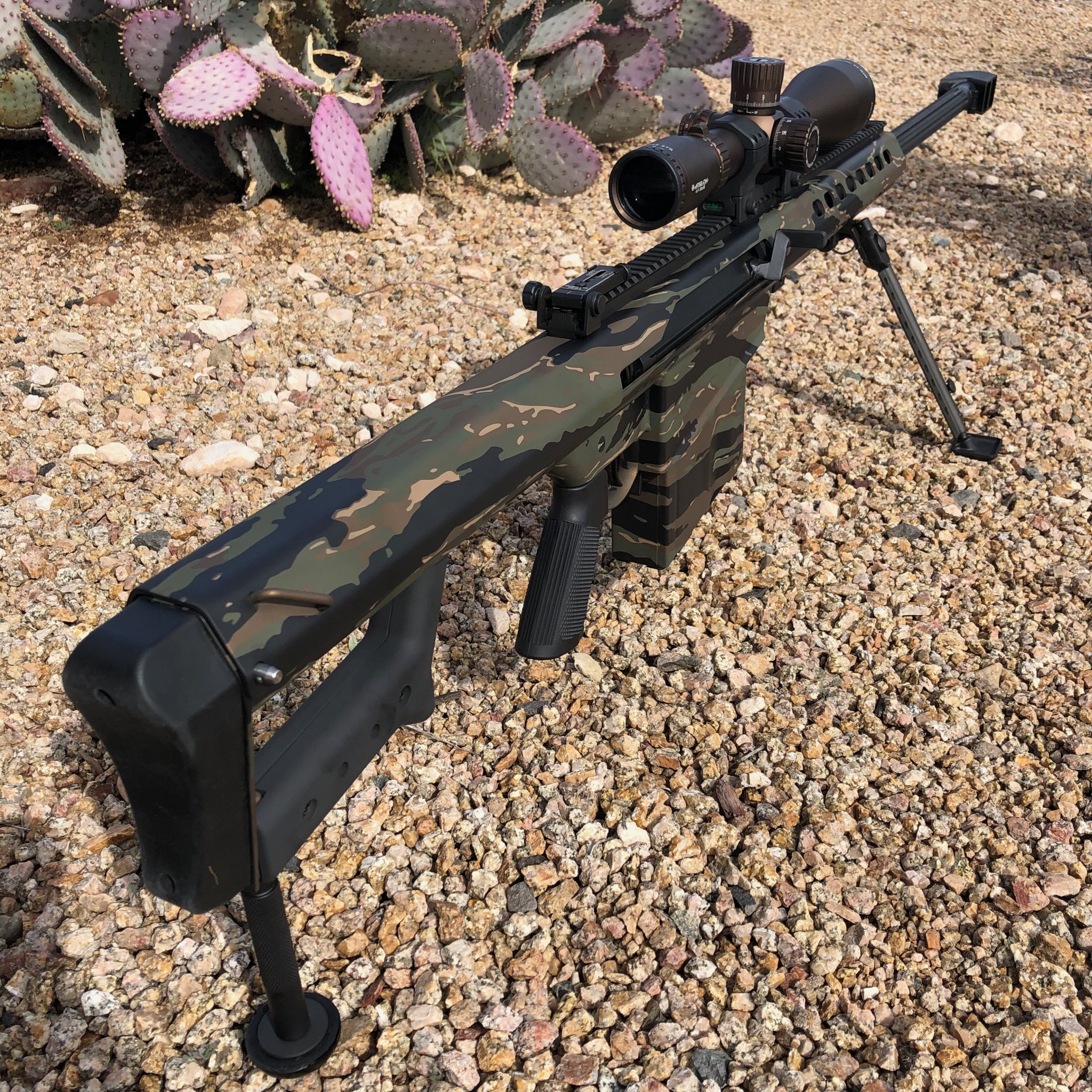

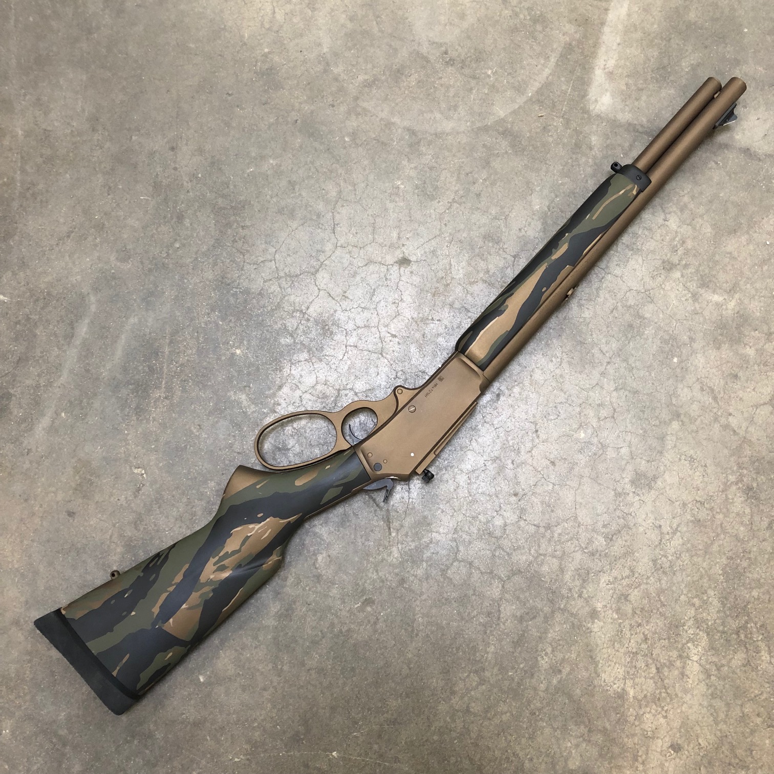

Just shipped this monster back to the owner today. We did his Barrett M82A1 in Vietnam Tiger Stripe camo using the following colors: Graphite Black, OD Green, Athlon Brown (custom mix to match the Athlon scope) and Mud Brown.

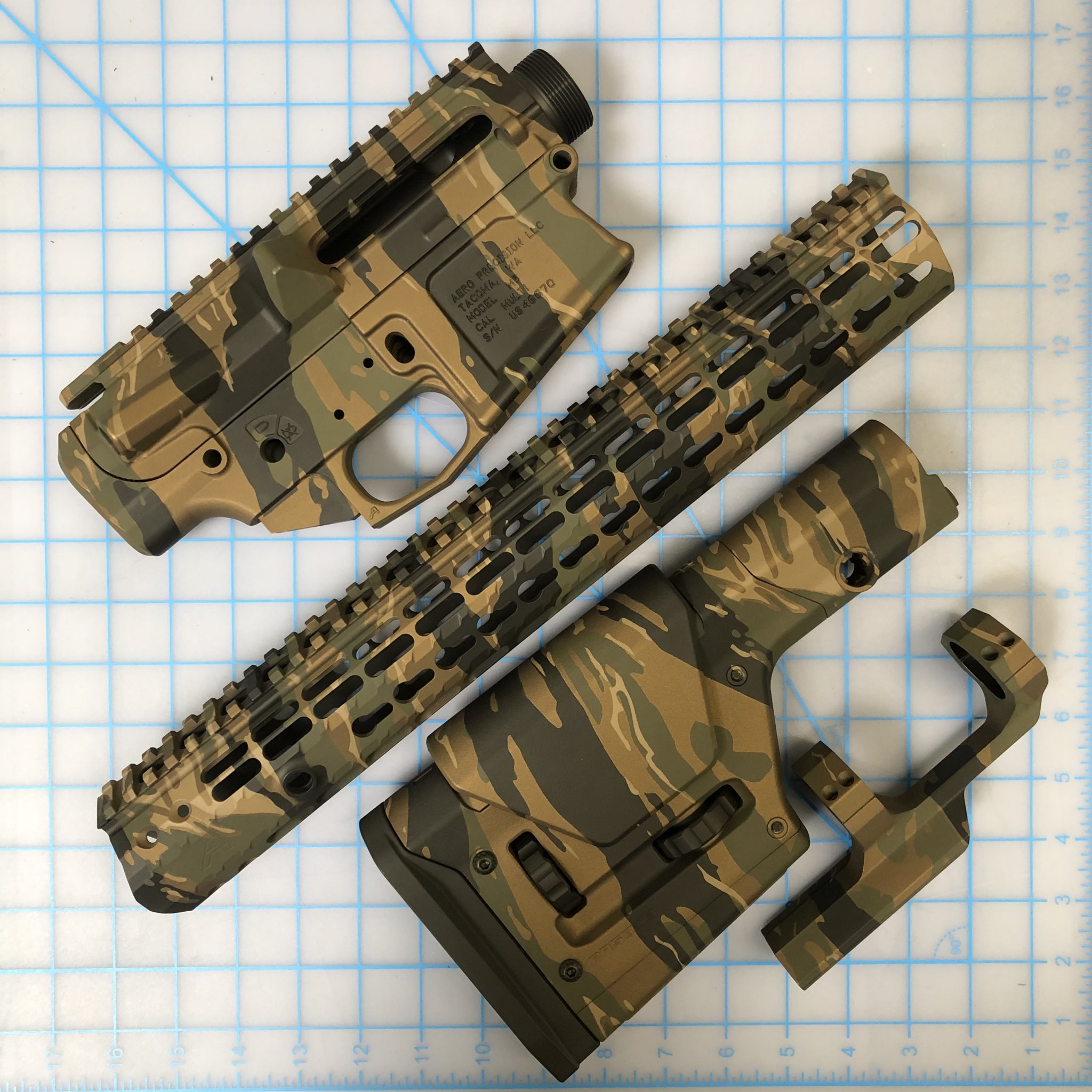

I’m going to be redoing my AR SBR in this pattern. First I want to finish a stencil aide for ARs that reduces the time/effort to apply them around features like the forward assist and shell deflector.
For future jobs I’m thinking Glock FDE might be a good replacement for the custom mix of brown. We can keep doing the custom mix but the metallic content isn’t for everyone.

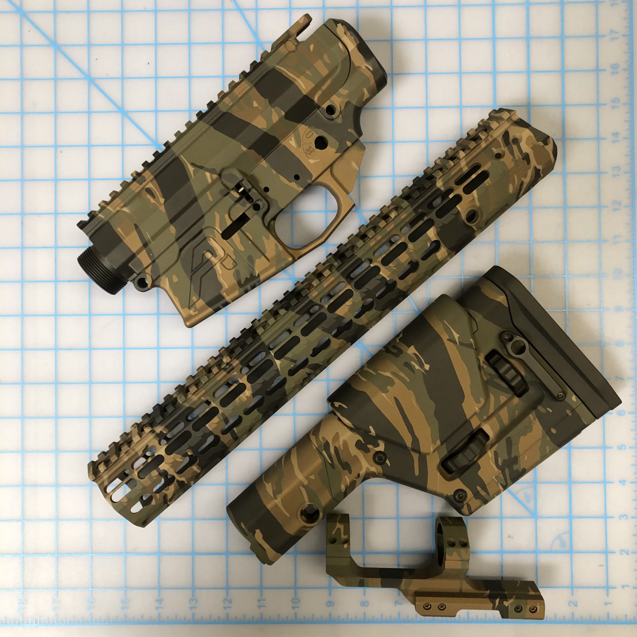

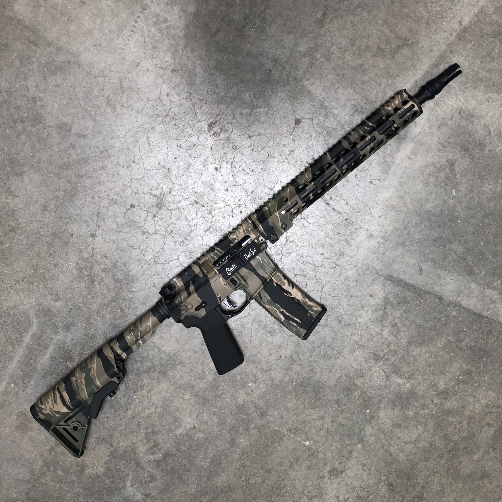

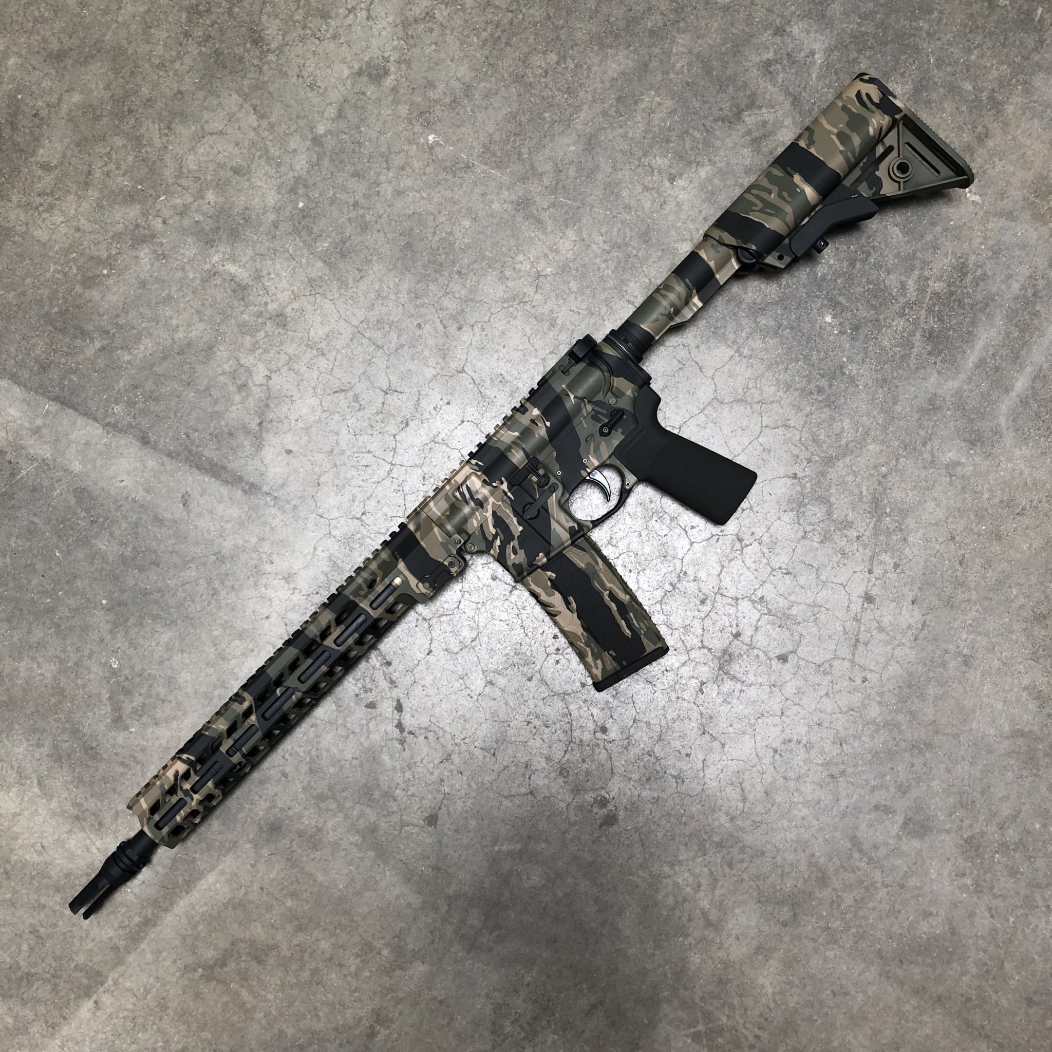

I’ve got an AR in final cure right now with this pattern, this time I rotated the stripes 90 degrees and used a flatter black. Also recently finished up a Glock slide. I’ll post pics tomorrow after everything is reassembled.

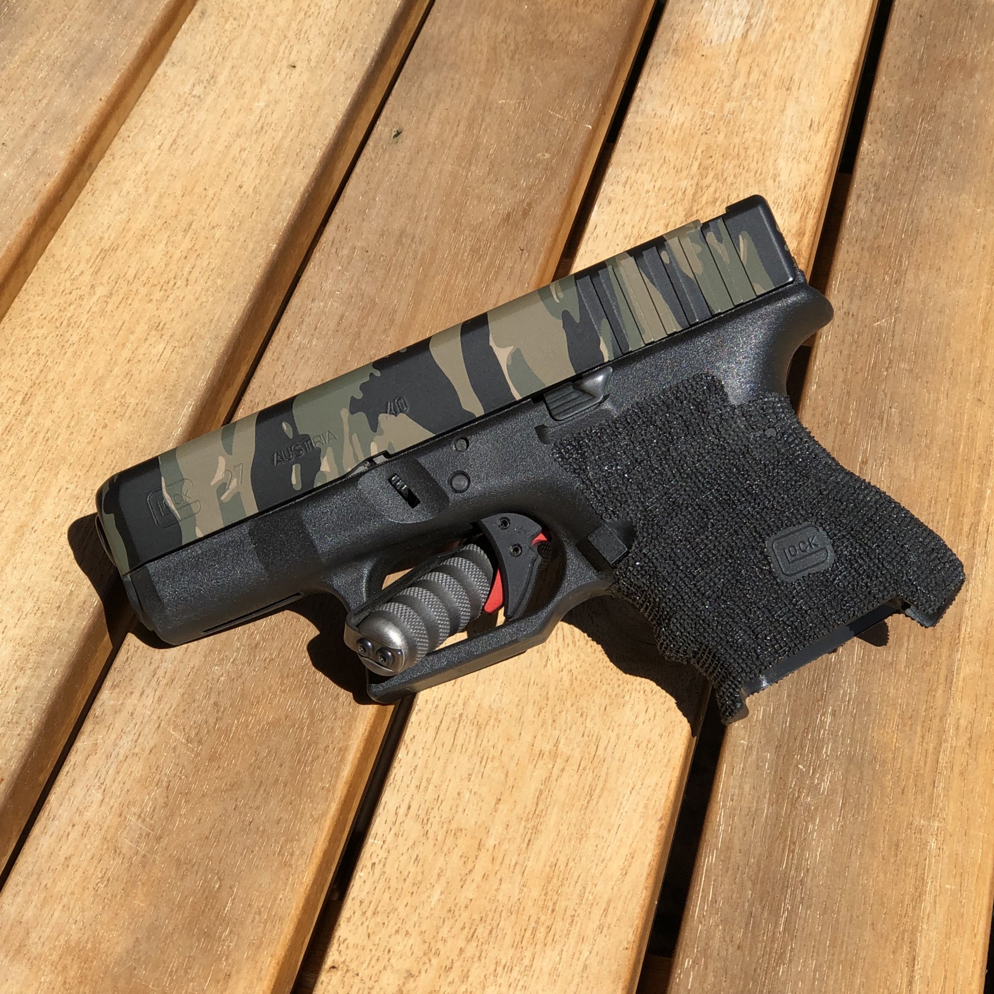

And here are a couple more projects in tiger stripe. First is a Glock 27 that we did the slide on, we replaced the custom brown mix with Glock FDE. Next is an AR that had been camped with a rattlecan. This one we used Armor Black instead of Graphite Black.
