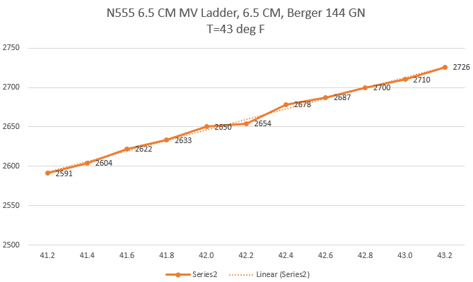

Here is how the ladder velocity test went...
VihtaVuori N555 Variable charge in 0.2GN increments
Lapua Virgin SRP Brass, no neck conditioning performed - just inspected and chamfered ID/OD
CCI BR4 Primer
Berger 144GN LR Hybrid Target, CBTO 2.177", Approximate COAL 2.870", jumping 0.070"
Max charge per VV website 43.2GN
Chronograph: Labradar
Temp: 43 deg F
Prior to firing these rounds I fired a three round group to ensure I was zeroed. This initial 3 round group w/41.6GN yielded Average MV of 2620, ES=5, STDEV=3.
41.2 2591 FPS
41.4 2604
41.6 2622
41.8 2633
42.0 2650
42.2 2654
42.4 2670
42.6 2687
42.8 2700
43.0 2710
43.2 2726 No pressure signs
Based on these results, I'll take a closer look at 42.1GN and perform a seating depth study with that charge.
