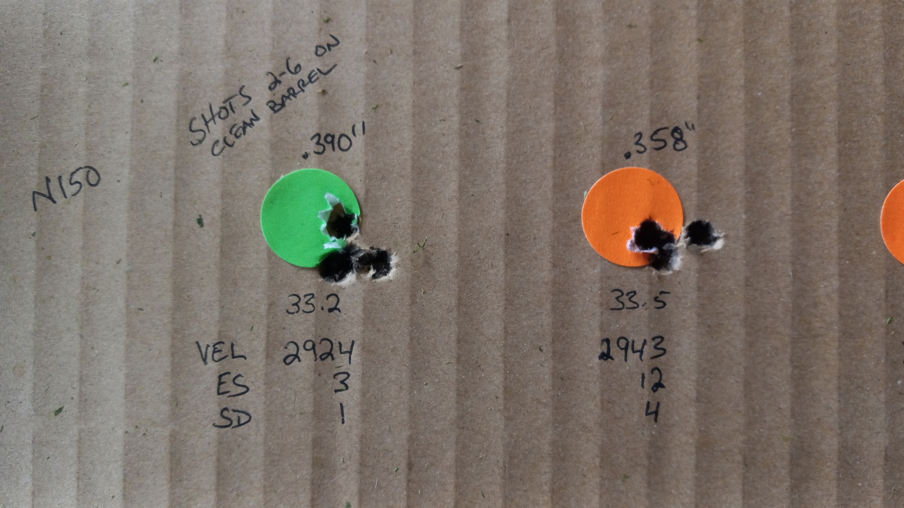

N150, 105gr Hybrids. 27" Krieger.
5 shot groups.

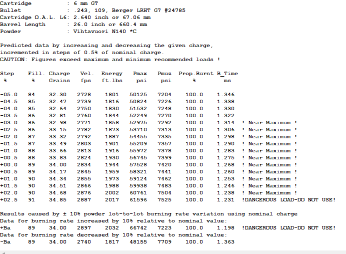

N140 may be a bit too fast for heavies - barely 90% case fill and already approaching max pressure.

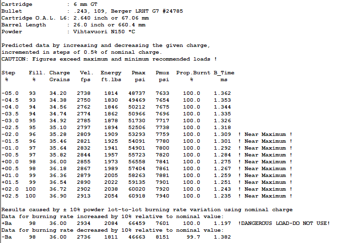

N150 is an improvement and probably the better case-fill/velocity ratio

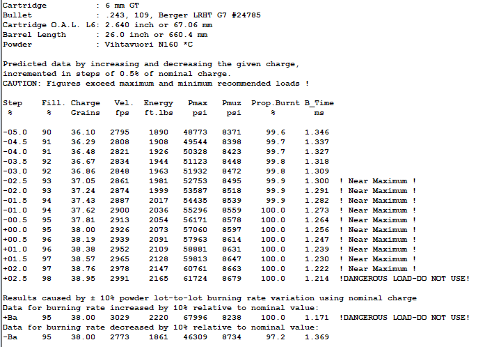

N160 will give you more velocity with lower case-fill

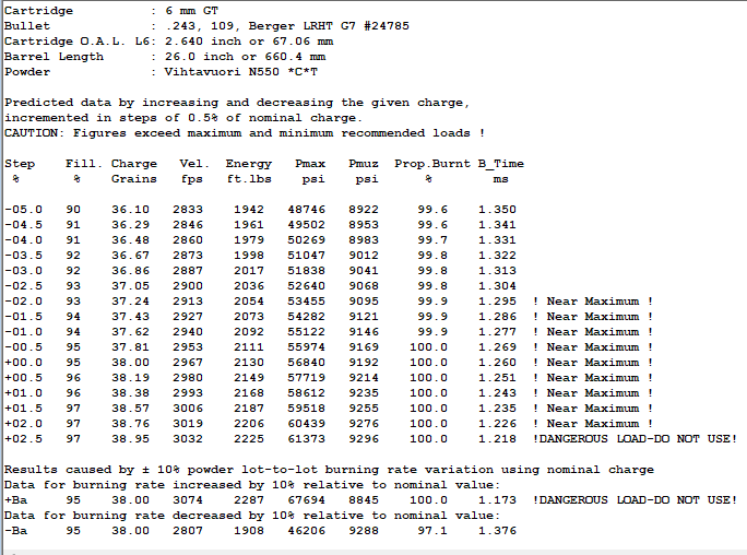

And N550 will give you even more velocity for roughly the same case-fill at the expense of faster throat erosion
The powder charge for N150 is on the high side for quickload. My real world performance over 3 barrels, 2 of them were bartlein, they ran 2890fps with 32.8g of N150 and the other barrel was a shilen which liked 32.0 of N150 @ 2860 fps.

I was reading some of the earlier comments, and looking at the Viht site, and you might be onto something about N160 being worth a try...
Its supposed lower flame temp may help with barrel life, I'm just weary of it being a little too slow to where it loses some of the magic? But it does look promising as an option closer to H4350 than Varget.
The general rule of thumb from a VV rep: use N100–series if you’re shooting rapid fire stages and want to prevent the barrel from heating up too quickly, or just to mitigate throat erosion a bit. For everything else, N500-series.
I still think N160 is going to be better optimized for the 6CM, but I don't think it will suck for the GT either. If you have a need for speed in the GT though, I'm going to guess that you'll run out of case capacity with N160 well before you eclipse the speeds you'd get with N150 or N540.
I've got 8lbs of N160 sitting here for my next CM barrel, maybe I will get into it just a bit to see what kind of velocities and accuracy I'll get with it. My 27" Krieger has definitely shown a preference for the H4350 burn rate more than it has the faster stuff like Varget. Sample size of 1 however.

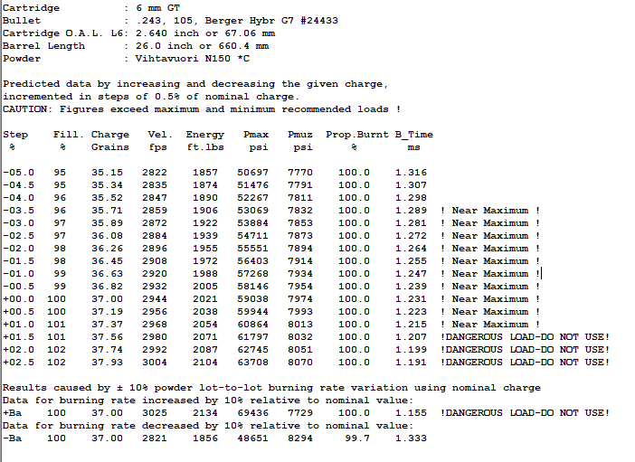

See post #6 (those are 5-shot groups). I'd personally start around 33.0 and work my way up to about 35. I only went up to 34gr, and never saw pressure, but the velocity told me that I still had some room to go up. Accuracy however, fell apart.
I don't remember my jump, but my CBTO with the 105gr Hybrid is 1.947. Actually, come to think of it I never jump tested my rifle with that bullet. I bought a box of factory ammo to test, and it was so good that I just about copied it.
SD/ES is killer! Thx for a solid starting point.
I think 33 should get me pretty close to 2850 out of a 26” barrel. I hope I’m not chasing my tail by trying something new. FWIW the node on N140 prints high .2’s to .4’s at 2890, but SD/ES ag high single digit to low teens. I kept hearing about the cartridge favoring N150 more and want to set and forget as much as I can.

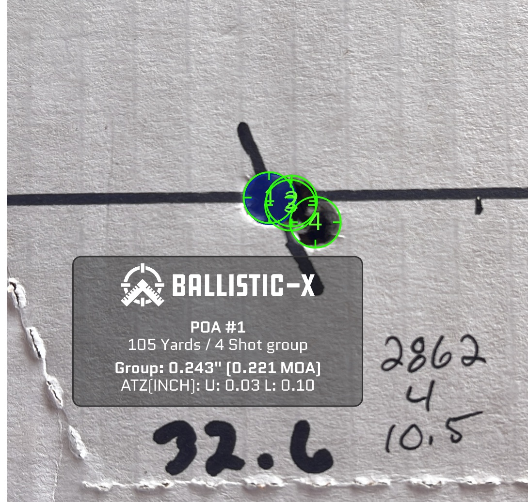

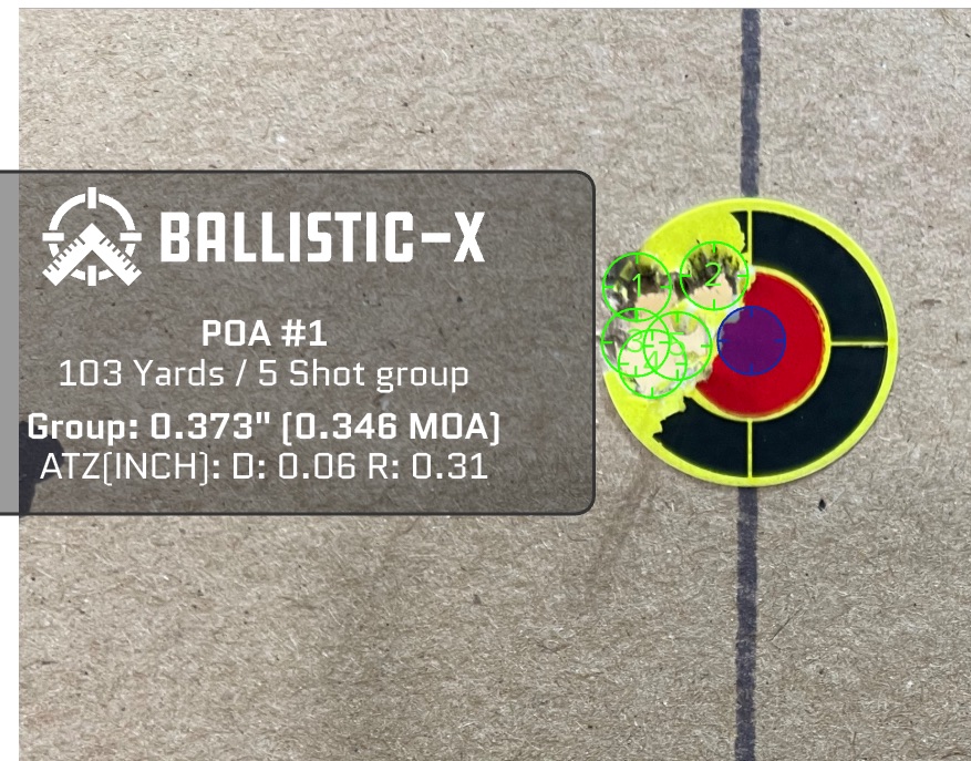

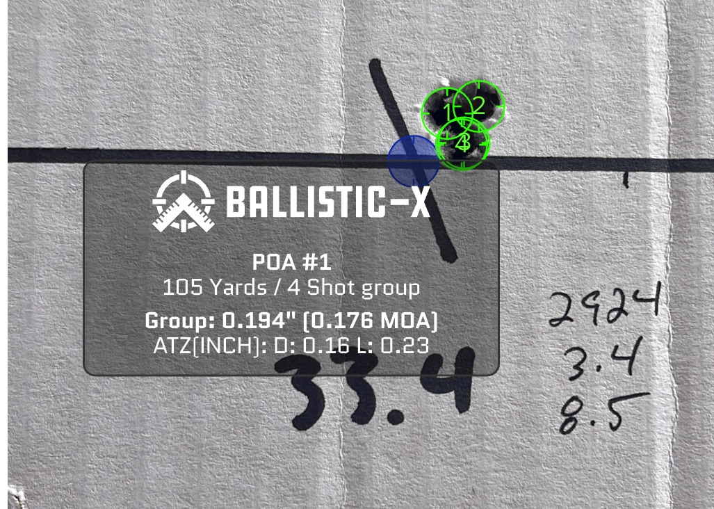

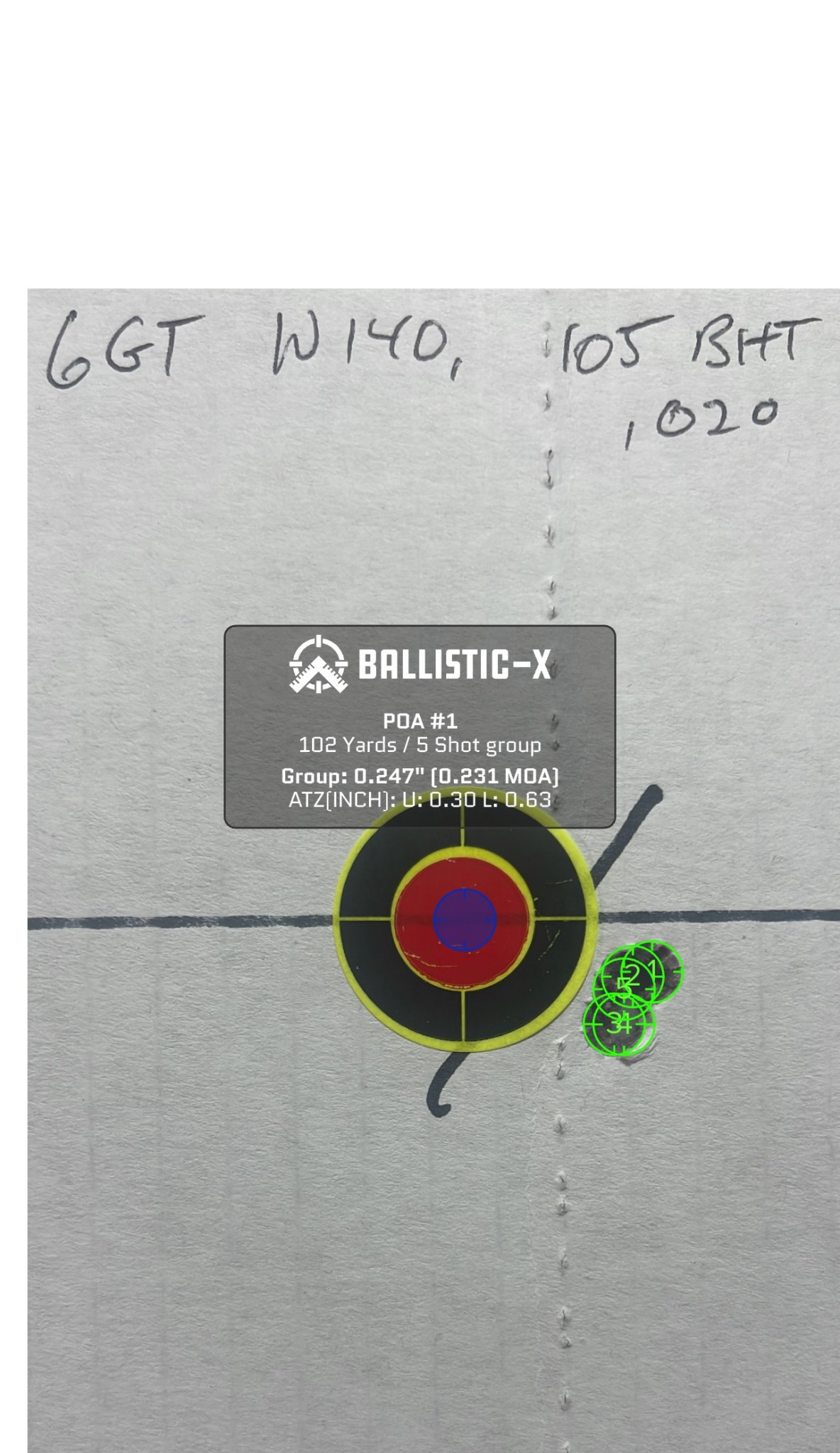

Here’s some random N140 results with 105’s. Granted some are 4 shot groups to work through ladders.
  • image_cropper_6558ADEA-6948-4274-A2A2-219CE68D6798-9760-000007A20FDD4CE0.jpeg
