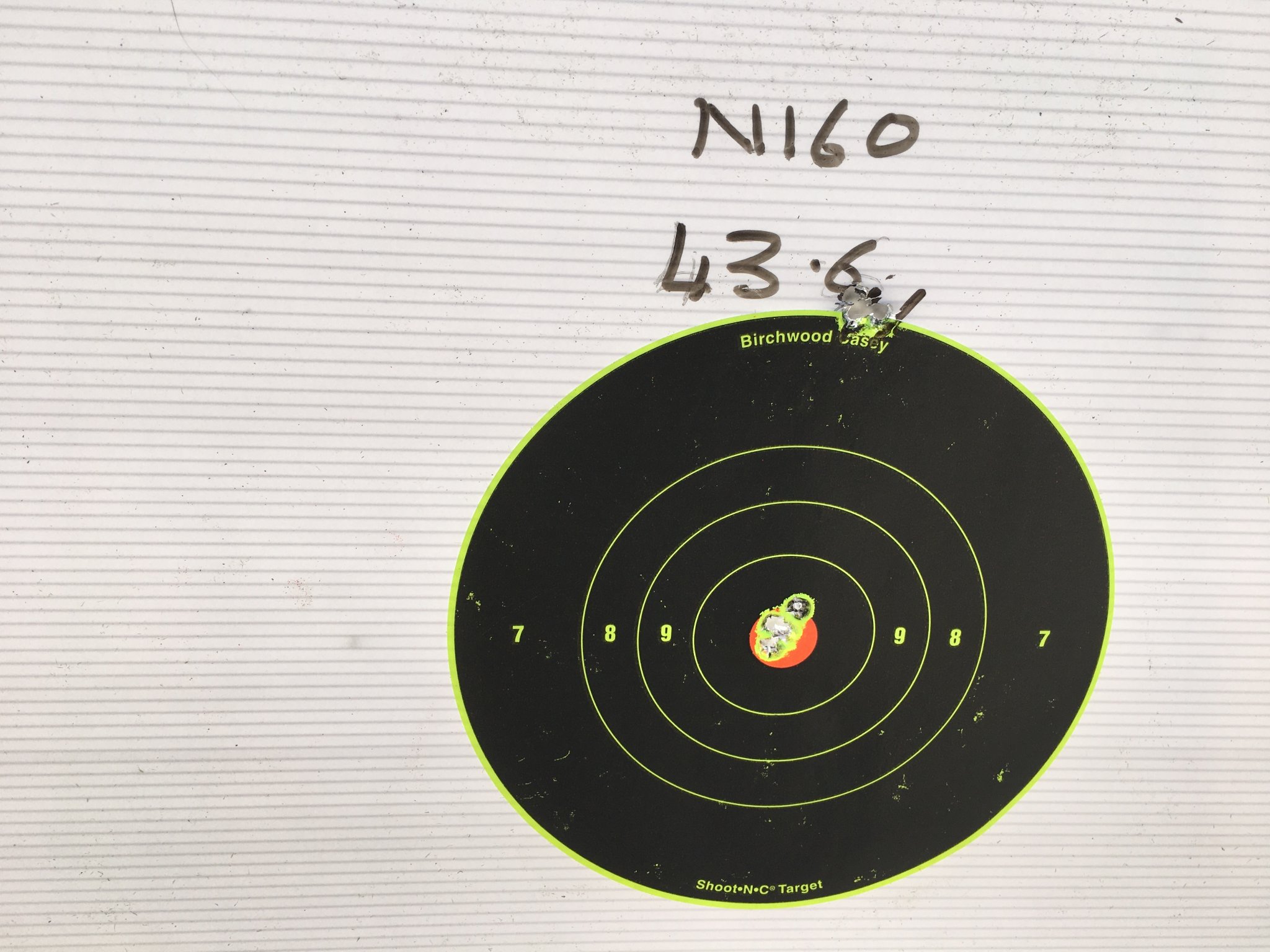

That's close enough. I don't have any but I'm was working on a trade. Hodgdon's website has several powders listed for 6.5 CM but VV wasn't one. I did find an article that recommended VV N160 as an alternate.

What kind of velocity are you getting out of that load?
