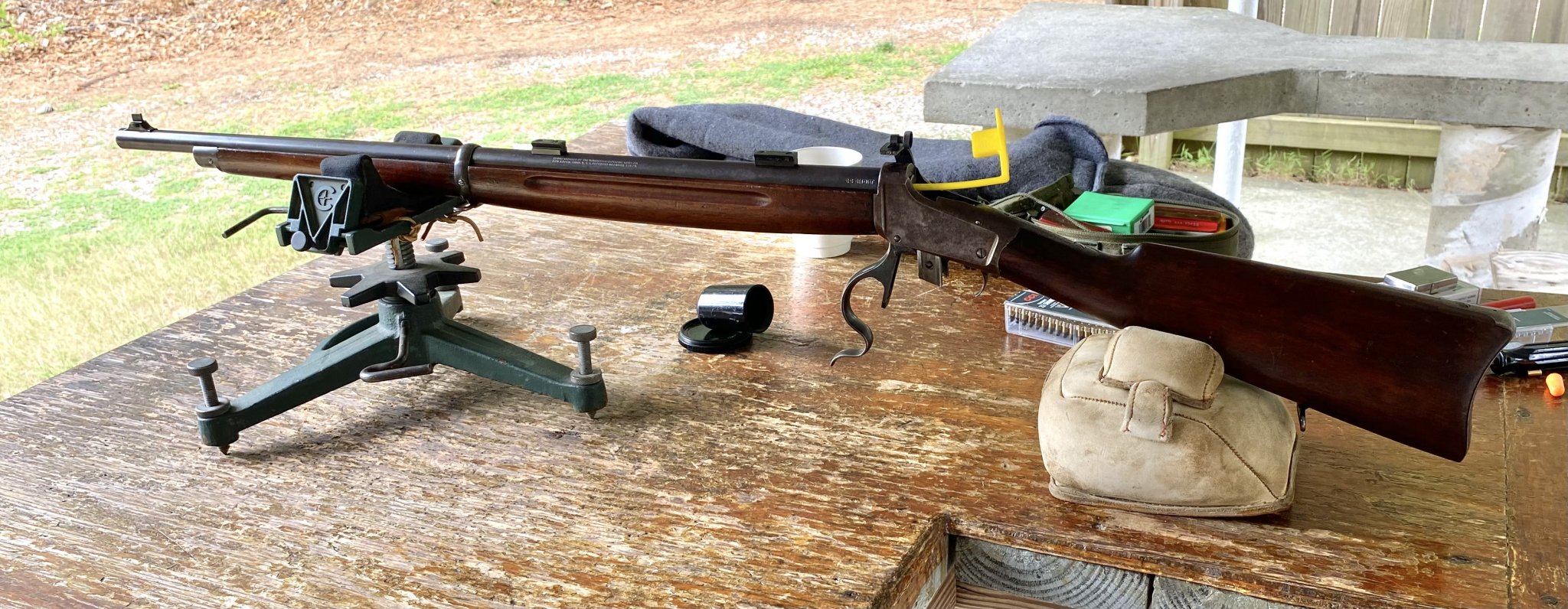

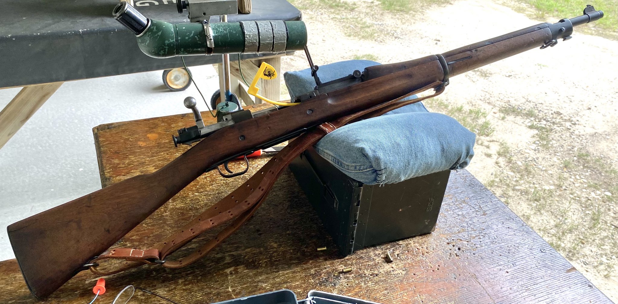

Today was vintage 22 day at the range. And being the masochist’s we are we decided to shoot at 200 yards. My buddy Ken had his Winder musket in 22 short and mine is a Springfield 03, converted to 22 long rifle.
We run the “no balls challenge “ an 8x10 target at 200 offhand. Good times! FA6F8C21-B412-439B-AC24-C88E83F344E1.jpegCF7248F6-6865-4299-9D7C-811ED062DDA6.jpeg
A good friend and fellow shooter had a Numrich kit, which was a chamber insert and barrel liner. We got to yakking at the range one day about what to do with this rifle, and he suggested building an insert/liner set up like the kit. We took it to a mutual friend who had a machine shop and basically said we need this. A few days later we had the parts. Next up we drilled out the barrel and inserted a barrel liner from Brownells. The chamber insert and liner are epoxied into place as one piece. I got the bolt off ebay and we were good to go. That's really all there was to it.
It will shoot just aboout anything, and with match ammo it is surprisingly accurate. We have debated putting an A5 scope on her, maybe next year.

steel plate of all sizes out to 200 yards, and we run what we call the no balls challenge- the 200 yard plate offhand with a Winder in 22 short. It is just a hoot. The guy who helped put the Springfield together collects 22’s mostly military trainers he has a couple M2’s. We have added the Springfield and also my my Rem no 6 falling block to the no balls challenge.
