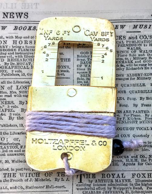

This is from a NG Marksmanship, Qualification guide from 1917, In a way those WWI era soldiers had it all over marksmanship training then we do today.
like a mil dot scope. Hold the rule, 20 inches from your eye (holding the string in your mouth makes it easy). use the mil marks on the rule getting either the height or length, and use the Range = target in yards, times 1000/mis
OK, that makes sense.
Stadia actually predate the Civil WarView attachment 7229330
The 8' cavalry marks are kinda cool..

I played with this quite a bit today. It was hard to keep the scale and the object being milled in the same focal plane. But...if I made an aperature with my other hand, or looked through a peep hole in a piece of paper, I was able to keep both in focus for a more accurate reading.
Ok It's been awhile. So please correct me. It's been a very long time :D
Height or Width of Object in yards x 1000 and then divide that by the number of mills correct?
So according to that ruler, if a target is say 6 feet tall which is 2 yards and fits within 1 inch (50 mils) then the target is 40 yards away.
you skipped a part. going with a 6 ft target. it would be 2 X 1000 or 2000 yards'
Then look at the target and using the scale, see how many mils you get. Lets say the scale measures 4 mils.
You now divide the 2000 from above by 4 which is 400. meaning your target is 400 yards away.
I finally got around to mathing this out a bit more.
I wanted the ability to use a readily available centimeter ruler for a bit finer graduation that was already divided into tenths.
If you make the string 19.6 inches long instead of 20 inches, then you get 20 mils per centimeter rather than 50 per inch.
