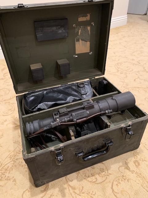

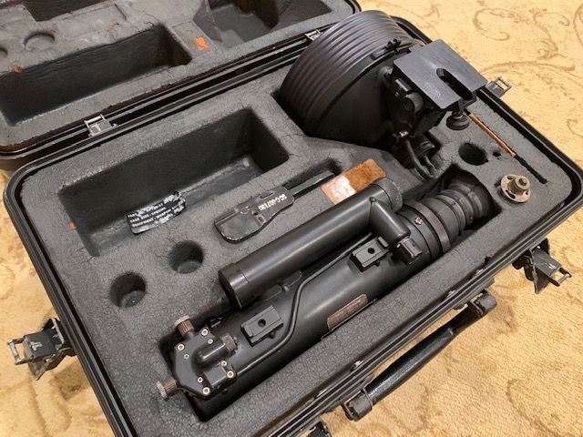

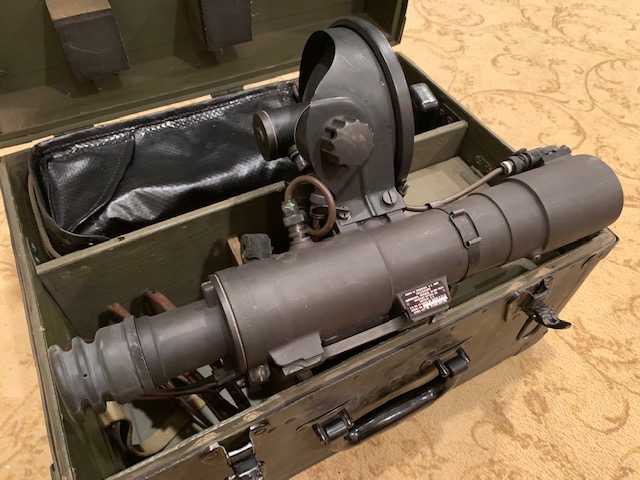

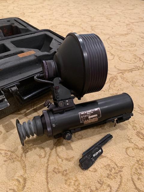

I recently purchased several night vision scopes from an estate sale and looking to see if anyone knows the value of them? All the packages seem to be mostly complete and I powered all the devices up and they do work! I have a friend who is interested but we don't know their value.
Any help would be greatly appreciated!
1) AN/PVS-1
2) AN/PAS-4
3) M1 Snooperscope?
1)
2)
3)
the anpas4 should land anywhere if complete w/ all manner of attach stuff w/ hard foam carry Box..(.oh and what reticle is in it??)...$800.00 to 1000.00.....gen II are reported to be more clear than genII+/genIII.....
the reticle is actually a small lamp that screws into the front of the mirror.....there are about eight or so different types....even one for a stinger missle

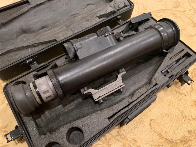

The top one is a pvs-1 a somewhat rare bird compared to the more common PVS-2. It was one of the first "starlight scopes" that used only passive/ambient light to produce images. It has internal sight manipulation and mounts on the left side of the weapon and not on the centerline. Somewhat awkward it was eventually phased out. The intensifier tube is a Varo cascade tube that takes 2 gen I tubes and mounts them in series to produce an exceptional gain and clarity. Not really anything much like a Gen I much better at the price of size and weight. The PVS-1 is rarer and commands about 700.00 in the market. With the m16 attachment you have a good unit although dated. It still rocks if the reticle is cleaned of the balsam resin that was used to attach the .50mm reticle glass that has deteriorated over time to make the view brown and discolored. The cleaning is internal to the intensifer tube not on the outside.
Never saw or sold a PVS1 , sold some 2's in the long, long ago...
PVS4 is going to be different than what you have there.

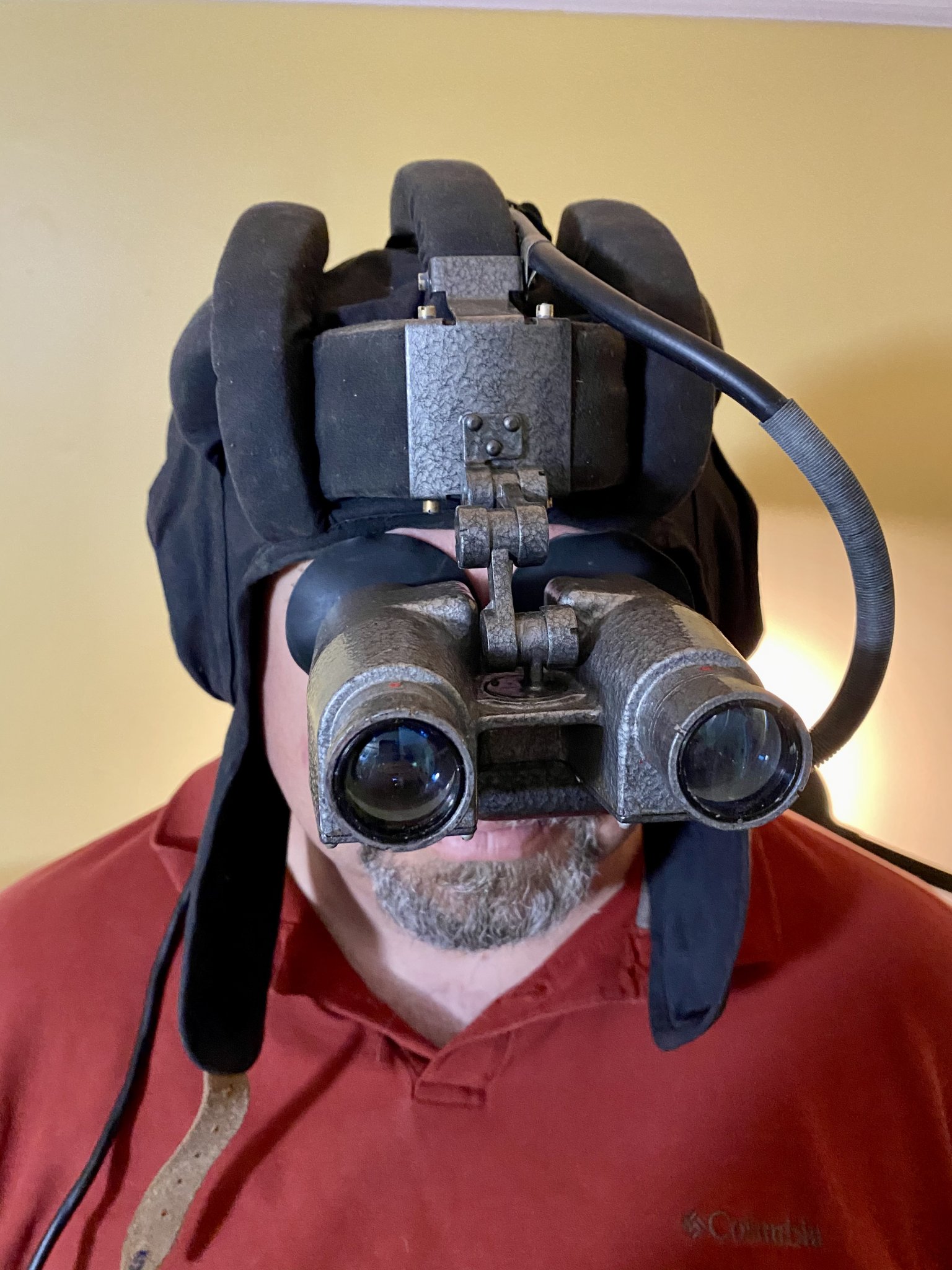

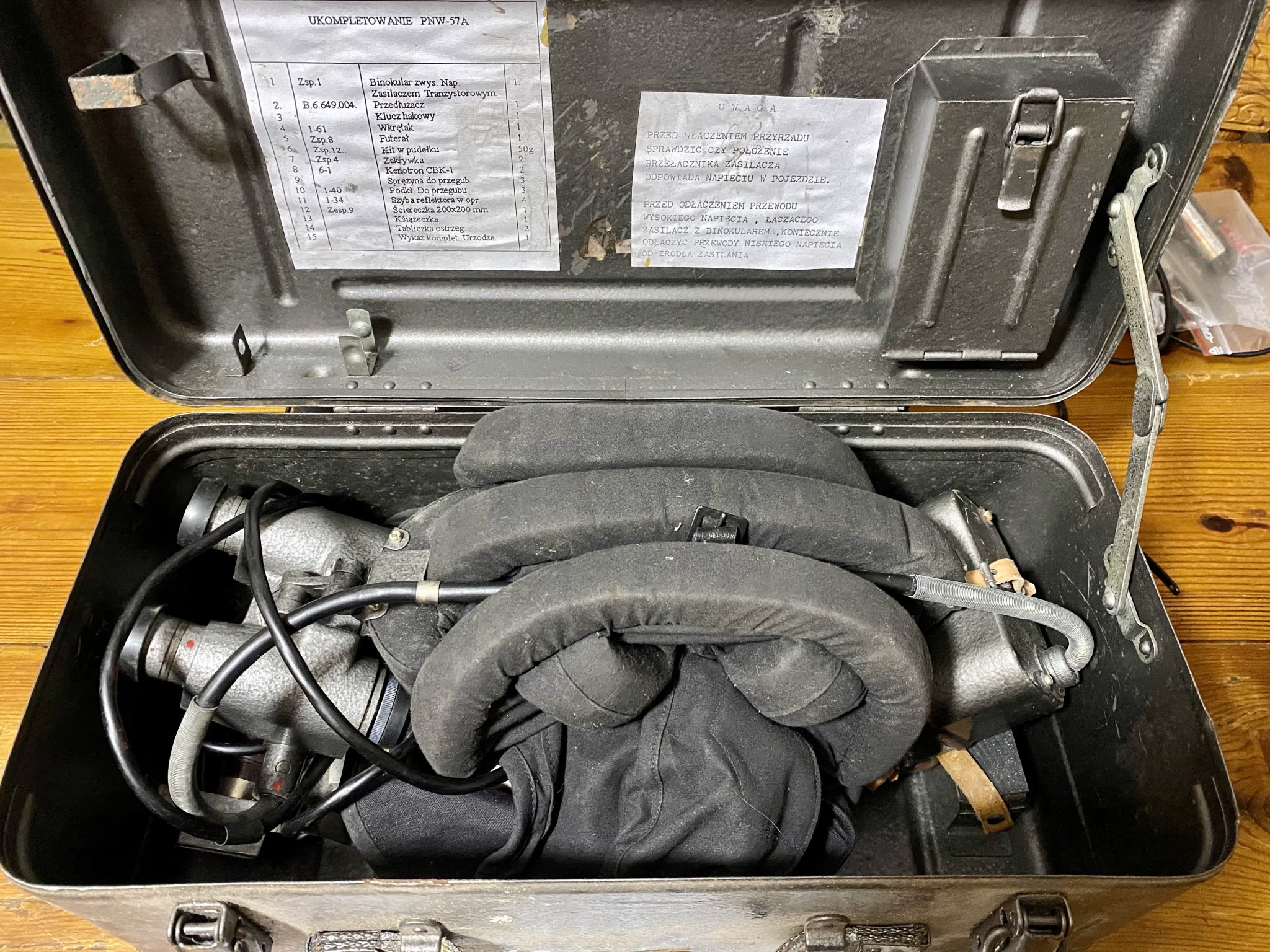

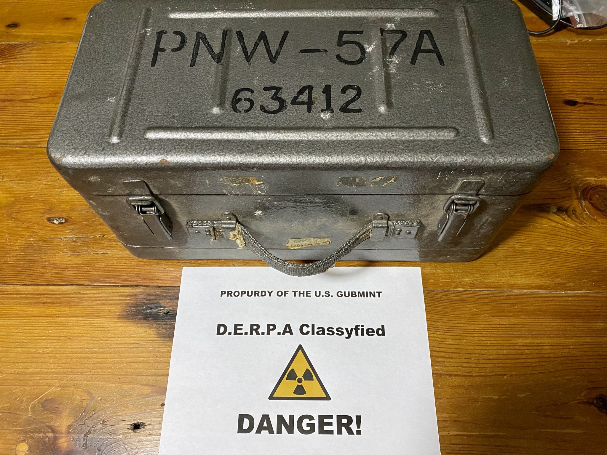

Nice score. I've got some 57E's, one tip, if your eyes start getting itchy after use, there is a very good chance they used thoriated glass on em. So I'd limit your use of em, lest you want eye cancer. If you have an alpha particle detector you can check it, but itchy/red eyes are the "poor mans" alpha detector.
Many Kodak, Fuji and Asahi Takumar lenses that were produced prior to the 1970s are radioactive.[2]
Kodak = Camera. Hell everyone had a Kodak back in the day. No wonder so many Americans die of cancer. :oops:
Aint NUFFIN SAFE NO-Mo.
Back then, a lot of stuff was considered carcinogenic. Even things like X-rays and microwaves had a touch of radioactivity to them.
Reactions: WhereNow&How
So thoriated glass is no big deal when used on the front optics of anything cameras, binocs whatever. Alpha particles are stopped by like a few inches of air, a piece of paper etc. The problem comes when they are used on the eyepiece optics and its a half inch from your eye.
High energy Xrays are a different issue and some gen0 and especially triple cascade gen1 units did generate those, not a huge deal if you are using something a few times a year for an hour or two, yes you will irradiate your noggin, but you will do that traveling on a commercial airliner or a million other ways. Most western gear eventually used leaded glass in the eyepieces or was refitted with it (PVS-1/2) to help with that.
I've seen the soviet stuff with and without thoriated glass used, so it varied, I have no idea as to why one unit would use it and another not. And to my knowledge their triple cascade stuff like 1pn34, 1pn58, etc. didn't use leaded glass.
So be careful out there kiddos.
