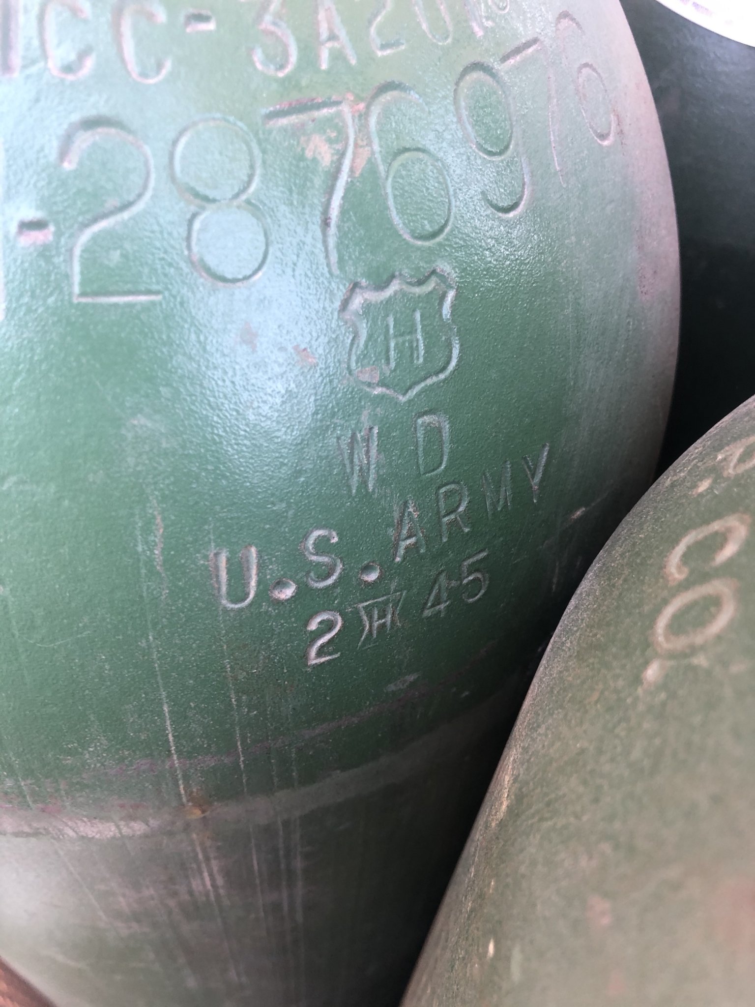

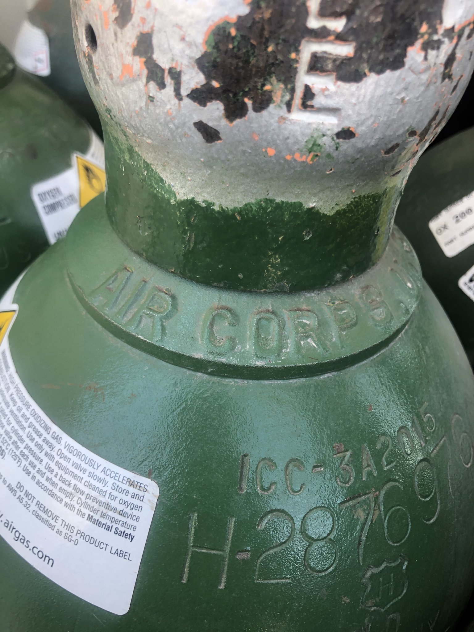

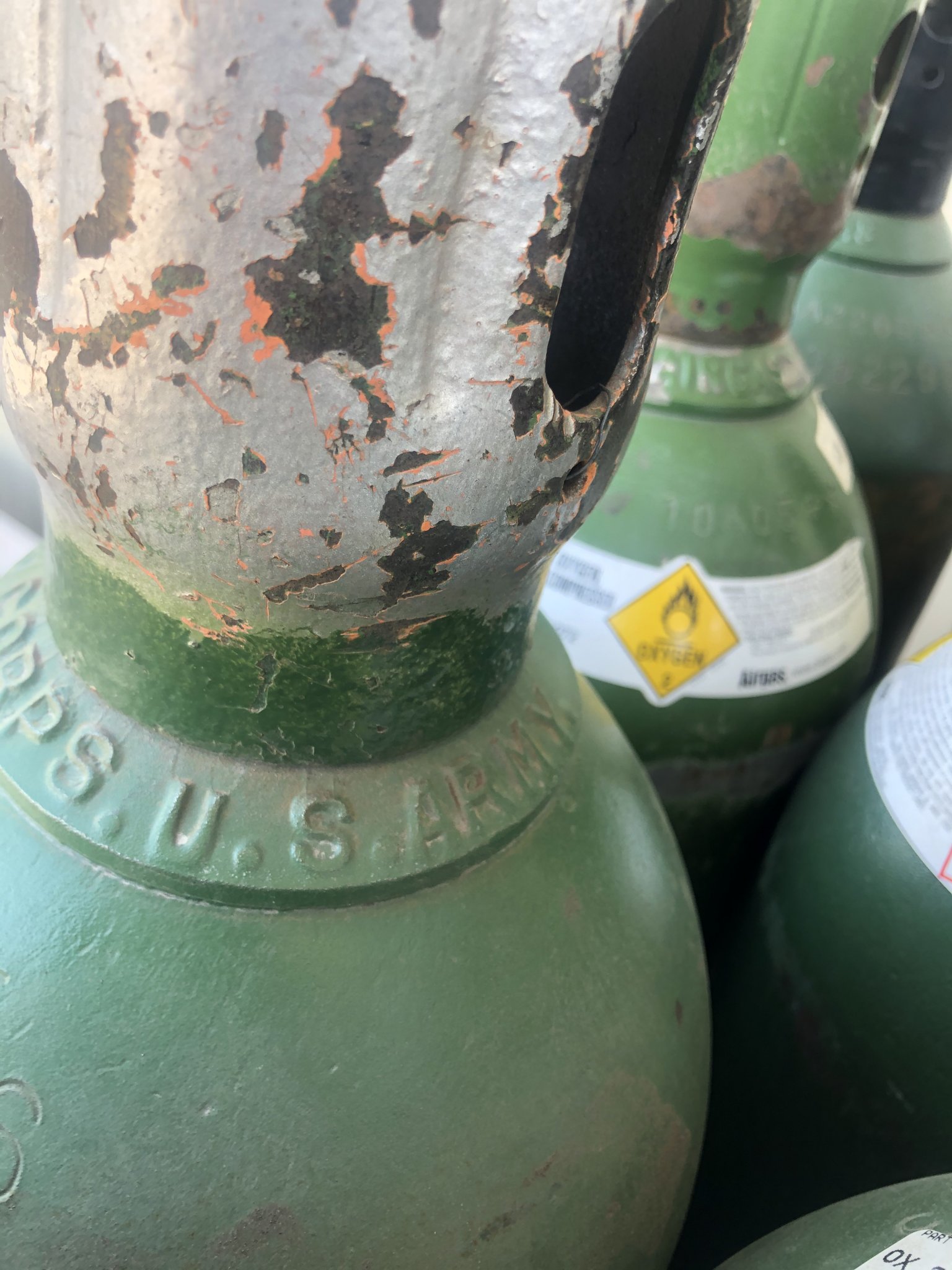

    I spotted a vintage oxygen bottle in the rack today. US army air corp. put into service in 1945.
    Neat. When I started my medical career we still used steel even though they were heavy and could rust internally if pressure was lost.
    So I guess the connecting threads haven't changed since at least ww2?

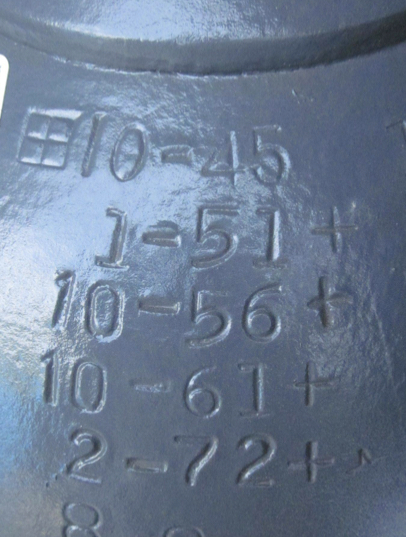

    As far as I know nothing has changed. It’s amazing how long high pressure cylinders last. I’ve seen initial hydro dates from the 30’s

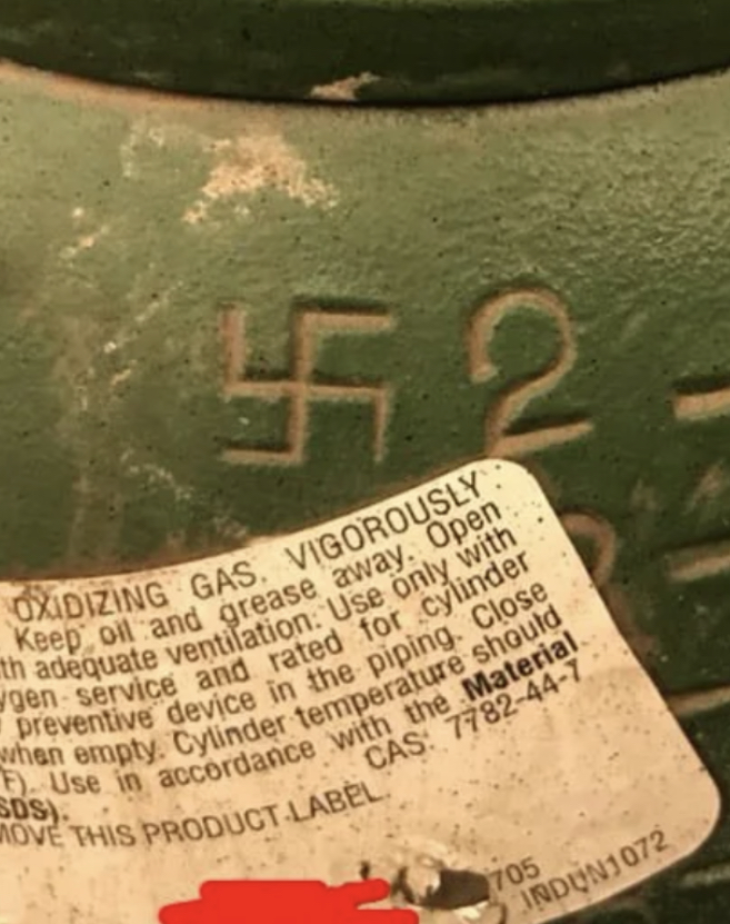

    And, I don't remember for sure, but I think the first compressed air bottles were linde, german, WW2 hits, you have swazticas on bottles.

    I've seen one ton cylinders with in-service dates as old as 1916. 150 pounders from before WWII. We use a lot of N2 at my current job, probably 50% of the cylinders are Army Air Corps or pre-war era and still perfectly fine, change the valve occasionally.
