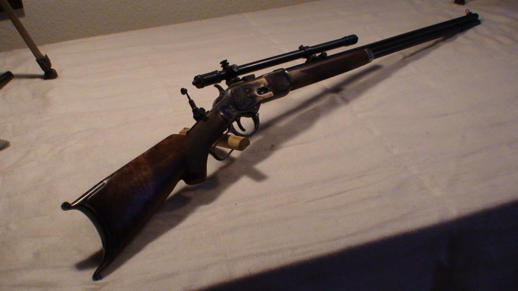

Hi, your best bet is the Leatherwood copy of the Wm Malcolm 3/4" tube 6x 18 inch length scope shown here: Winchester187345lc3_zpsb4bff57a.jpg They are $279
from Buffalo Arms. It mounts on two Unertl type bases. The long Malcolm scope that you show is fairly complicated to mount...requires a special plate that sometimes comes with the scope and sometimes must be bought separately...depends on who you buy it from...I also have one of the long Malcolm's like you show.

That rifle, by the way, is simply drop dead gorgeous!!! Love to hear more about it? The Scheutzen buttplate is phenomenal.

Thanks. I build custom guns and like scheutzen and target rifles. The gun above is an Uberti replica of a Winchester 1873. I did the stock work in 3x fancy walnut and put a case hardened small swiss plate on it. It has a 30 inch barrel in .45LC. The gun was originally a straight stock and I bent the tang and lever to fit the pistol grip. I stippled the stock, rather than checker it, and used a classic Winchester pattern. Below is a Marlin Ballard that I built. The scope is an original Sidle out of Philadelphia ca 1880. The mounts are later Winchester A5.
