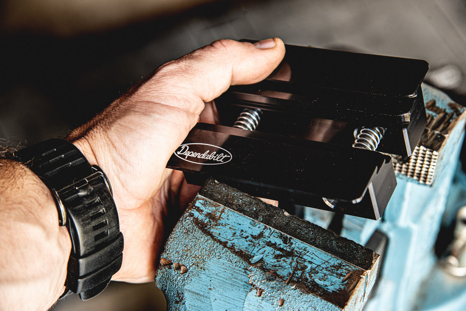

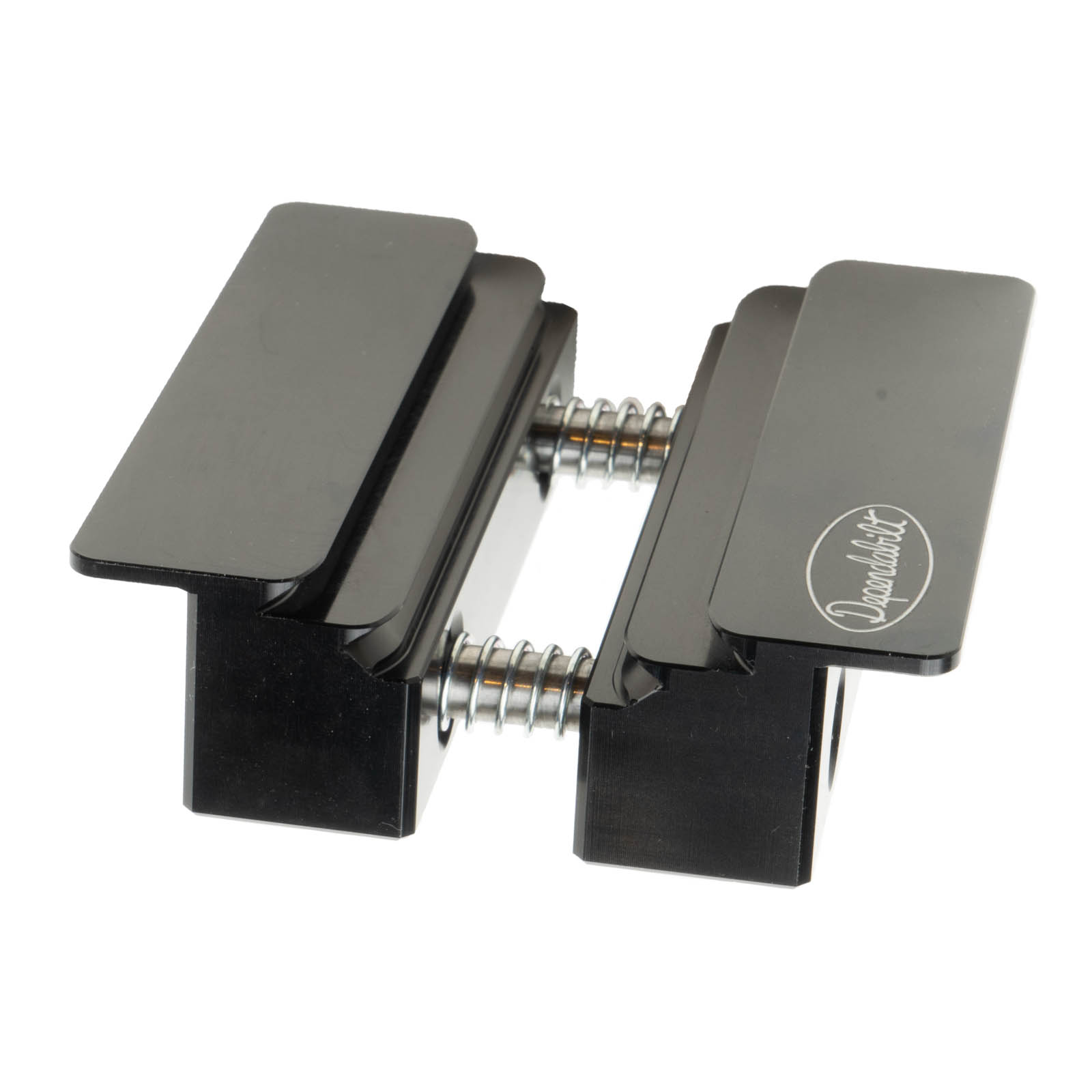

It’sa great product and I use it regularly to clean or tinker. But to get the gun level for scope mounting, I prefer to use the Wheeler jaws I posted above so I can rotate the gun to level.
Don’t know how you’d do that with the Dependabilt.

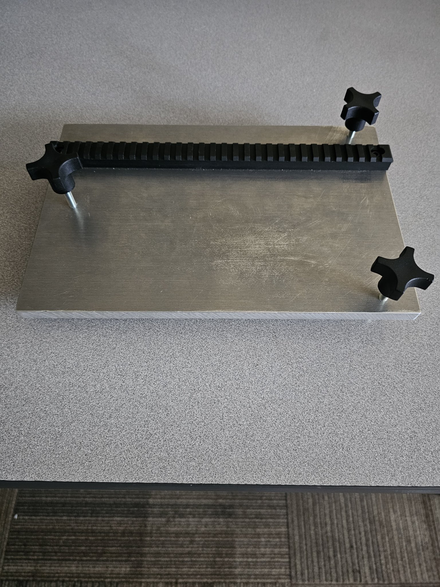

Just make a cheap leveling fixture. A picatinny is a picatinny, so you don't need the gun, just the scope and mount(s). You can get all the parts off ebay and Amazon, including the plate and taps for the threaded holes. Level the fixture, then level the reticle using a plumb line or level. Tighten it down and recheck. Done
Or you could just stack feeler gauges between the flat on the scope and the base. There's a million ways to do it. I was just offering an idea that the OP could take or leave. I apologize for accidentally touching a no-no spot
I just don't want him or anyone else who will read this to think they need to buy all sorts of equipment to do a simple job of mounting a scope.
