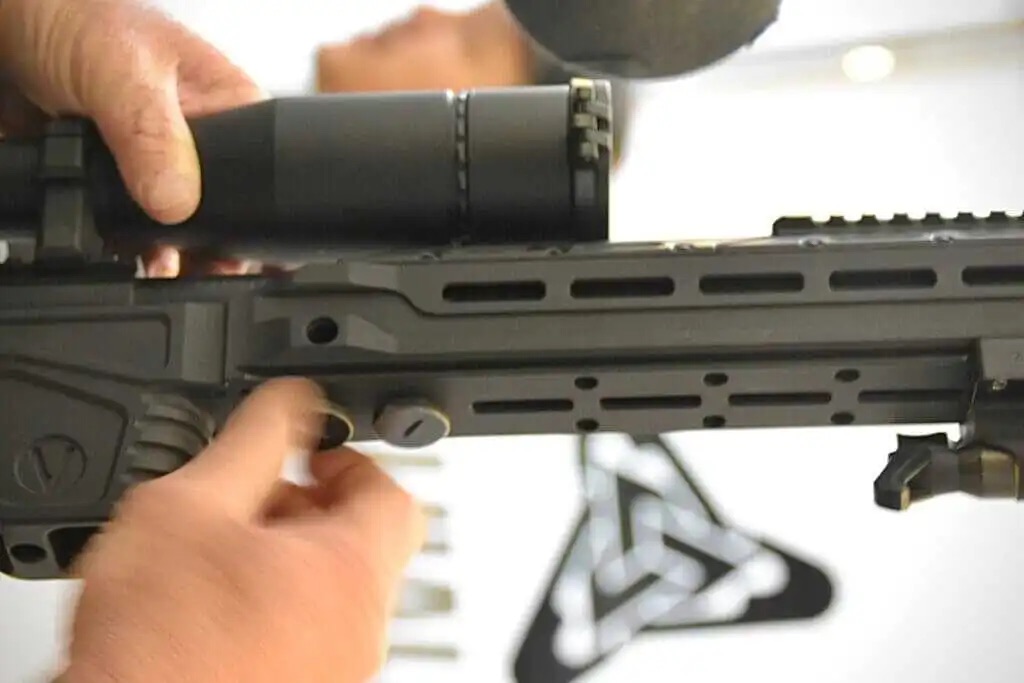

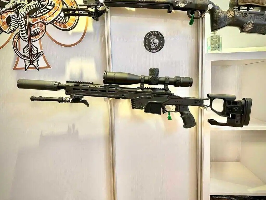

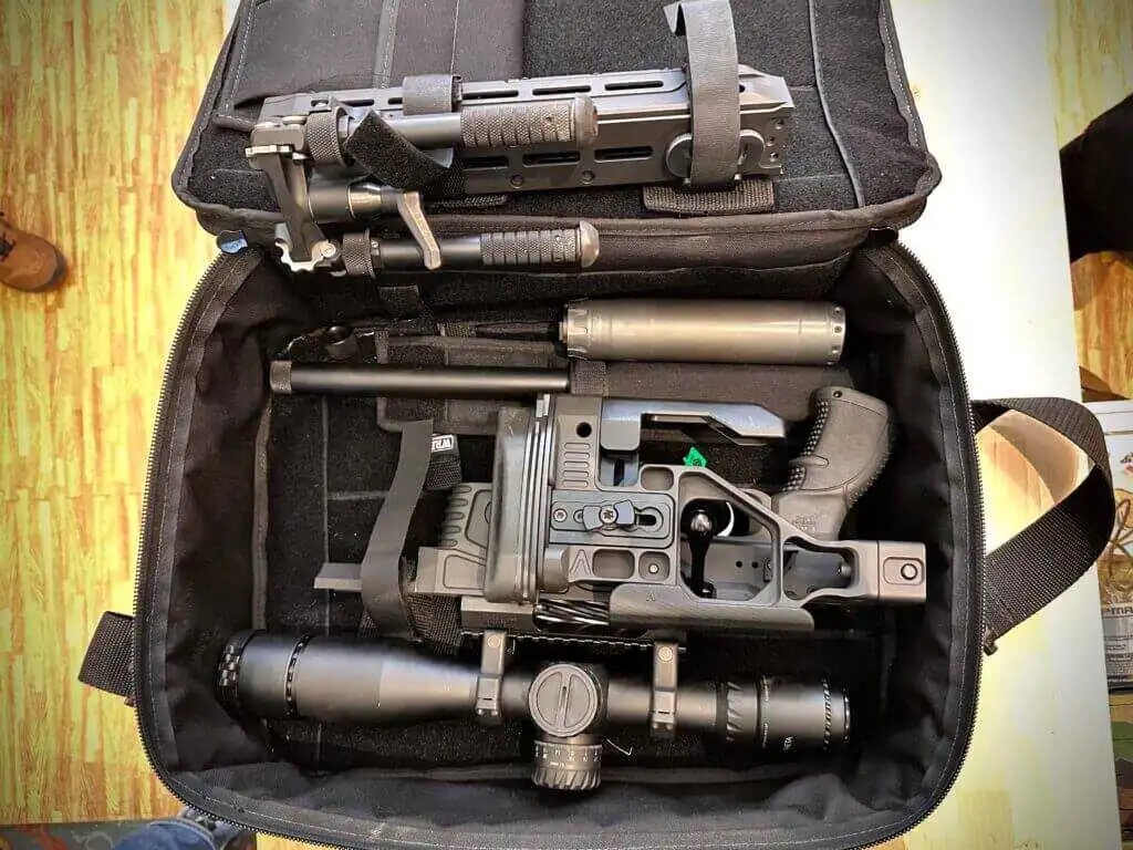

Hey Baron, thanks for the reply. In order to do what I’m thinking, I would need to machine the rear end of the chassis out to match the interface of the Whiskey 3 stock. I would basically be cutting off the rear end of the chassis up to the trigger guard and inletting it for the KRG stock attachment.
The tool-less portion I am talking about has been brought to market by B4 Armory as part of their “Tace Mortem” rifle line and I have included photos below. It basically just replaces the normal two torx screws with larger thumb screws that can be tightened without tools. It forces you to give up approx. 1.5” of Arca rail closest to the magwell where the screws sit, but offers tool-less removal and installation of the forend.
