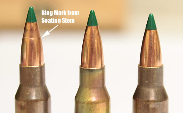

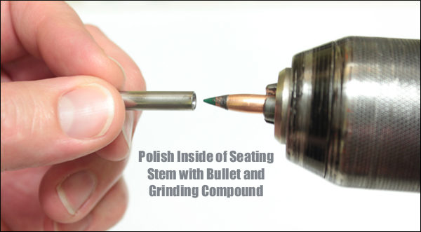

This whats happening?
Do this with some lapping or valve grinding compound over two or three bullets and youll lessen it to hopefully no longer be noticeable.
2-300 grit is much quicker than 800 which would take forever.

Damn. Not nearly that bad, more like a slight scuff mark. I’m honestly more concerned about getting even seating pressure on the bullet than I am about bullet damage, but that’s not a horrible idea. Although unless you have a mini lathe, I’m not sure how you’d guarantee exact alignment between the bullet and stem.

It’s spinning in a circle and will naturally self center itself to the lowest position taking off the high points with a loose grip. Just polishing it up basically.
If you mounted it in a lathe with both the part and tool holding rigid then you would want to worry about concentricity should you move the tool laterally an appreciable amount but even then it would require you being really bad at it to make a measureable effect on a seating stem lol
Too many people have success with basically no failures that I’ve heard of for you to worry too much about what you can mess up doing so.
