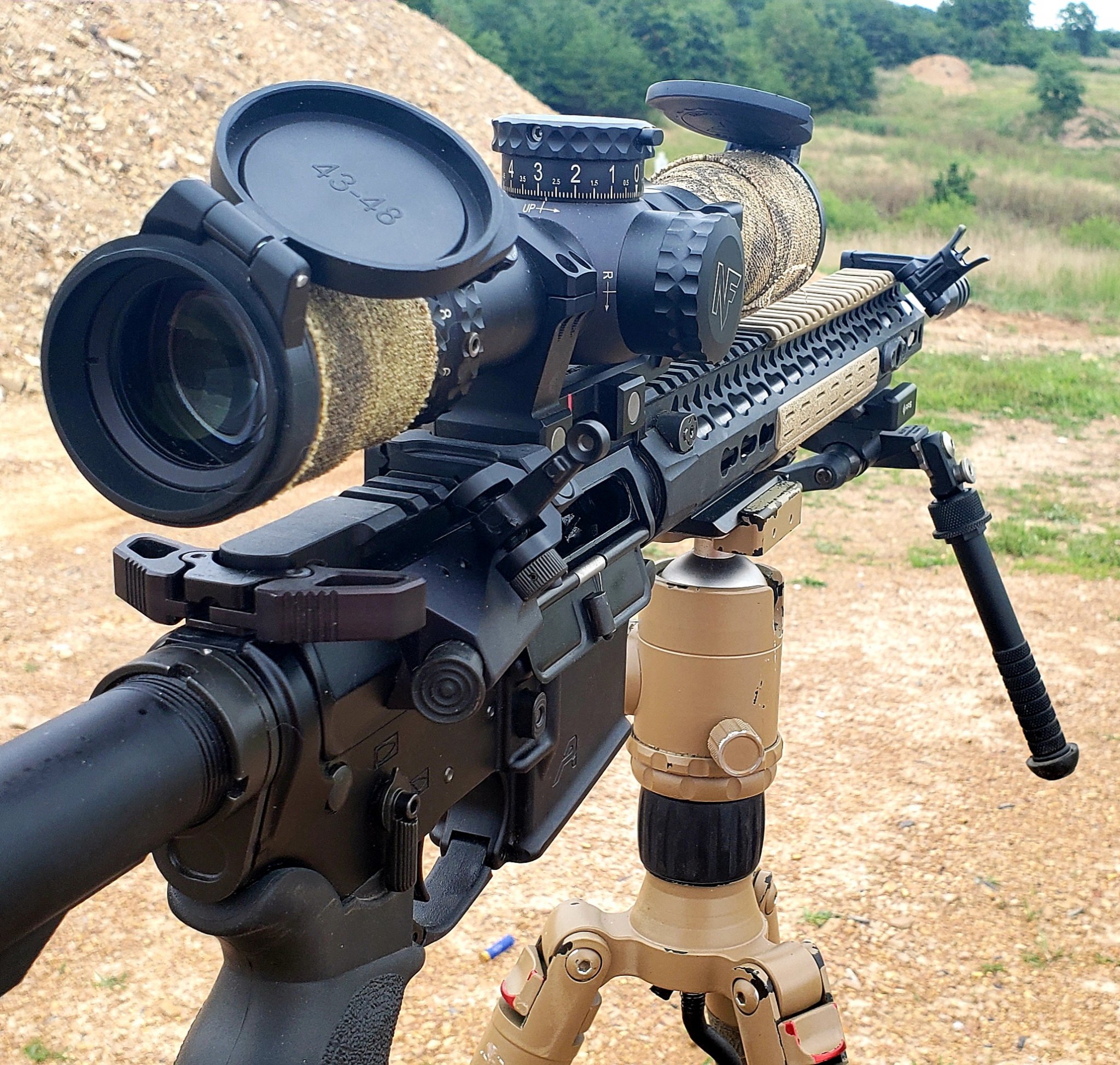

Does anyone know if there will any issue with the shape of the bolt catch on the left side and the shape of the recessed area on the Vltor MUR??

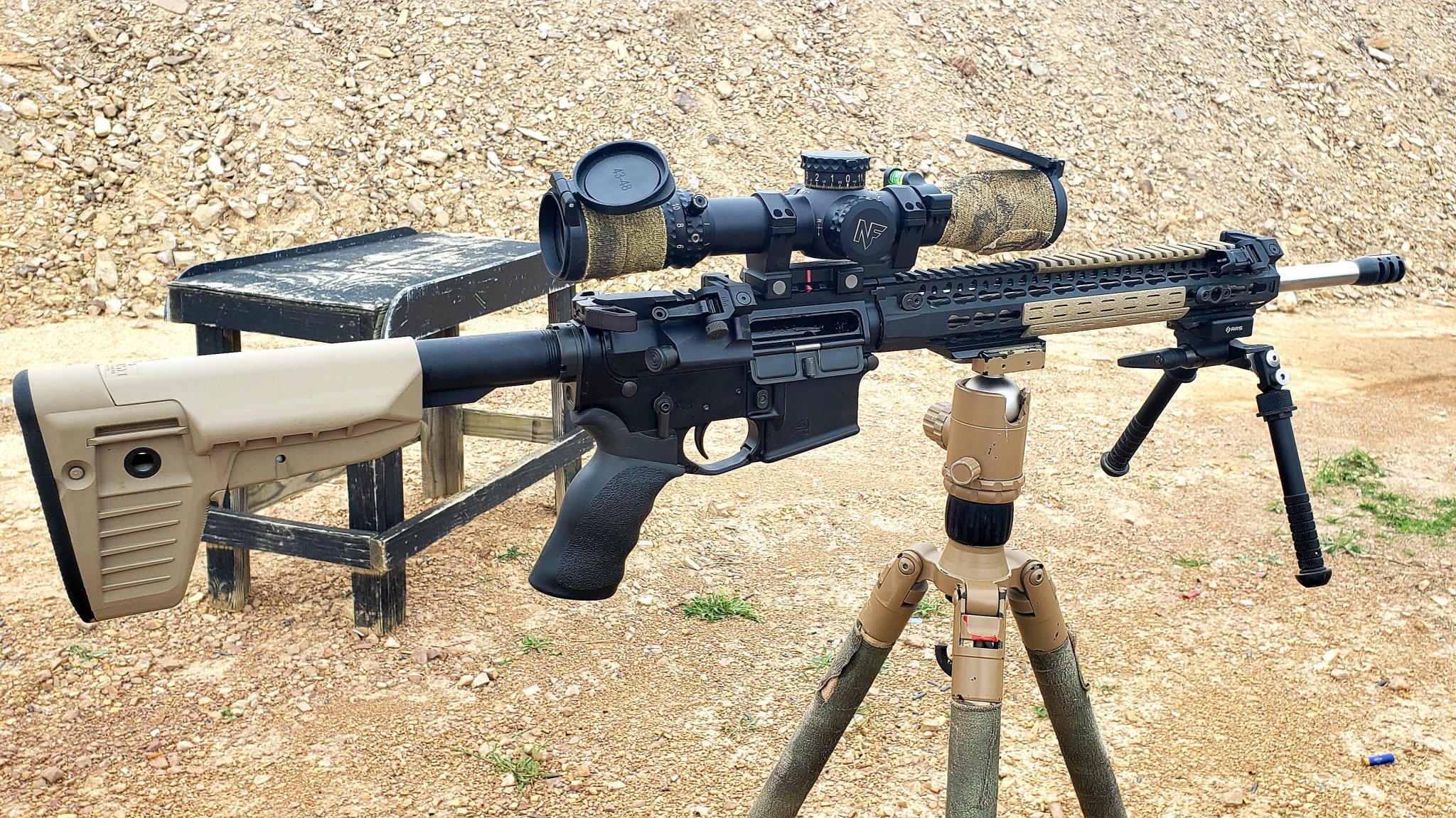

@Clayman It looks like you have the Forward Control Designs bolt catch and ambi safety on your Vltor. Was there are modification required to give the bolt catch clearance?

There is no issue with clearance on the FCD. They protrude far enough out to not touch the upper.

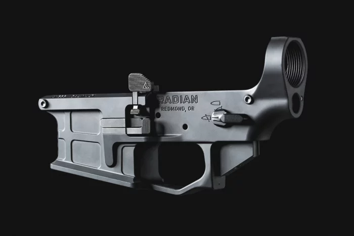

I also just tested that upper with my Radian lower. No issues either, it sticks out enough for it not to touch.

Wow.. that Radian bolt catch looks EXACTLY like the ADM one. I thought it was the ADM. Id post a pic if I knew how. Thank you for the response.
