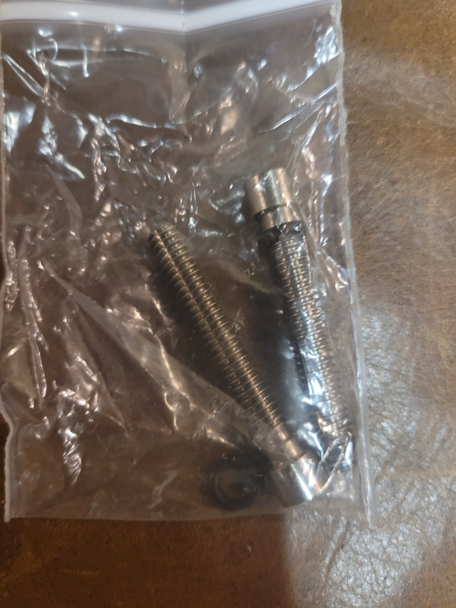

    Any of y'all run volqaurtsen action screws in non-volqaurtsen rifles? The screw is probably 3/16" shorter than factory and only has about 3-3.5 threads engaged.
    Seeing mixed results online.
    This is what I have. I think they are KIDD but not sure

    They will work as the torque setting is only around 10 in lbs for this screw. I always used a longer screw cutting it off until i had full engagement without bottoming out in the receiver. That way I could increase torque if need be. With only 3 to 3.5 threads you need to be very careful not to over torque. as these aluminum receiver threads are easily stripped!

    Exactly, who makes one with a hex head that has nearly full engagement?
