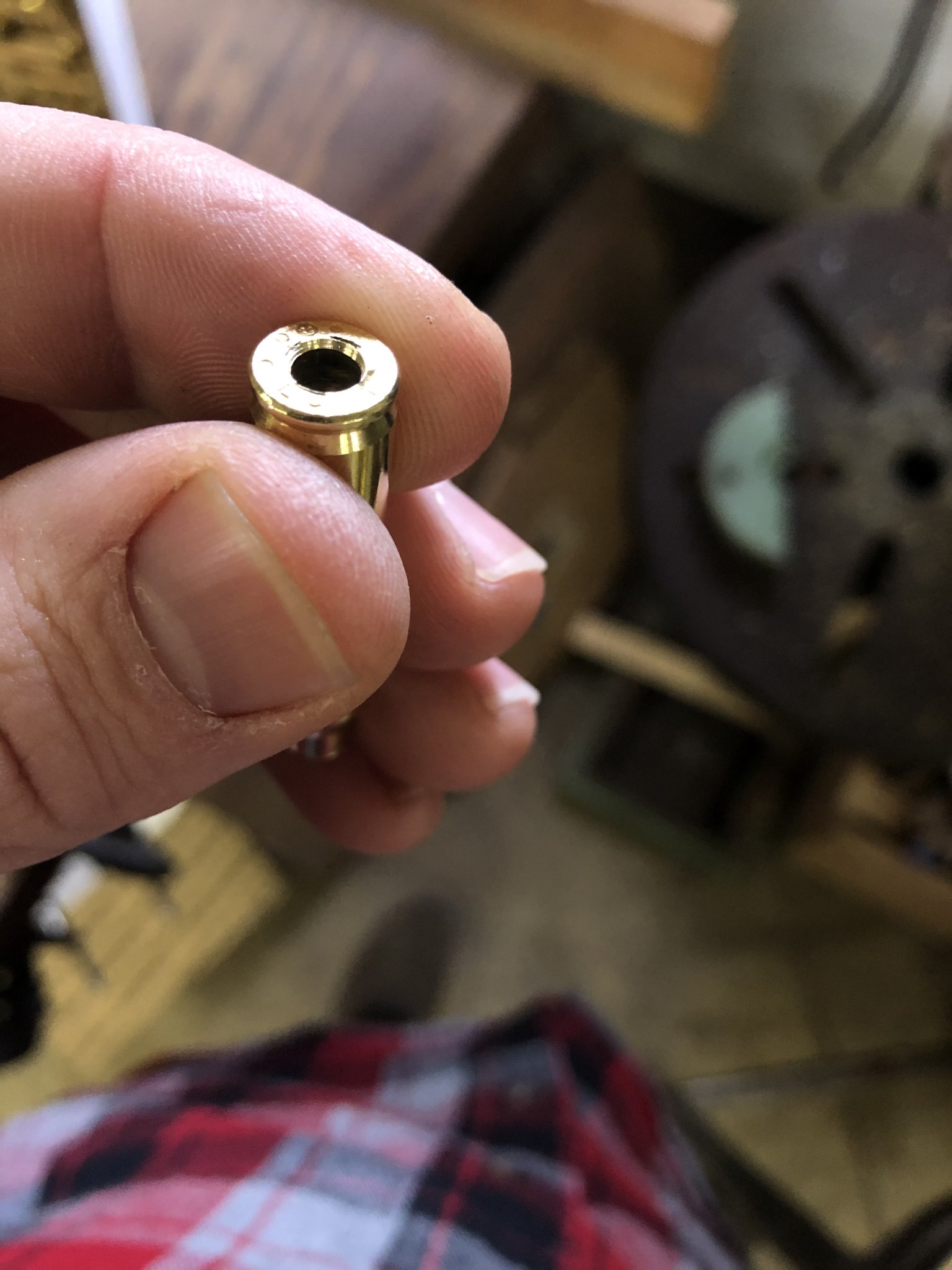

I use a rounded carbide bit in my drill press. I can do one in each hand in a couple seconds.
