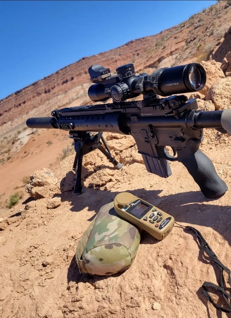

I have a Vortex PST 2-10 on my favorite 16" 556, great scope, I'd guess a RMR + 2-10 is not only less expensive, it retains the 1X at all times. $678 is a smoking deal
I like those 2.5 10 vortex pst scopes as well. Very nice bang for the buck and good features!
Don't think I really have any complaints and I've used them since the early gen ones. I do like the adjustable parallax for closer shooting as well as further out. A lot of scopes with similar features do not offer that.
If I was trying to choose between the 2-10 PST and the 1-10 Razor, it would come down to two questions. Do I NEED the 1x? Is weight a factor?
If weight isn't a factor and you don't need the 1x, go with the PST. Shoot, for that matter, if you want a 10x, look at the Leupold 2.5-10 Mark 4HD. More expensive than the PST, but lighter, and much less than the Razor and optically superior to the Razor in every way.
As for the PST, it is a joy to shoot. Any LPVO is an exercise in compromise.
If weight is a big concern, I could see the leupold, but if it isn't a primary rifle you're humping up a mountain I'd save the $500 and put it toward a clip on - the Vortex excels as a host, great for a clip on thermal at 2x-4X with the FOV.
I felt like this scope didn't make a ton of sense to be drawn to with the somewhat small objective, but I was, and after I got it I realized it is a perfect match for a clip on on a tripod - it is more than adequate for the practical distances you'll use a 556 or 16" 308 at on pigs and yotes.
I'm blessed with other rifles that tend to muscle out this 556, but with the Athlon CL35-640 clip on joining my collection I suspect this might get more use at night on coyotes. 16" Craddock barrel moves 62 gr @ 3,000 FPS.
For $678, especially if a clip on is conceptually possible - super awesome scope.

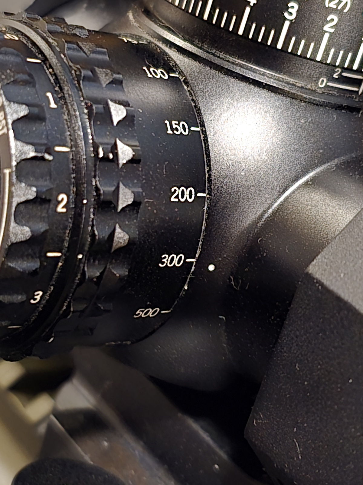

The strengths of the 2-10 (relative to the 1-10) are better image at 10x, parallax and more suited to dialling. It's weaknesses are heavy weight, exposed non-locking turrets, slower at close range on 2x (solved with the offset Acro) and a pretty mediocre reticle (it should have the same xmas tree as the PST 3-15, imo).

You'll enjoy your PST but I'd suggest always checking your windage if you're pulling the rifle out of a case as I've found it tends to easily get spun.
