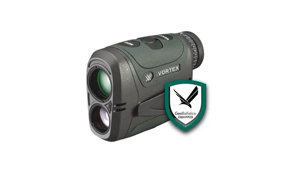

    I called Euro Optics and got Clay. Asked him about the Kestral and what he used. He told me about this thing so I ordered one. $799 and free shipping. I ordered on Tuesday it was in my PO Box Thursday morning. Thanks to @eurooptic and the USPS.
    I've only had it an hour and am impressed, looks like a kestral killer.
    You link it to the GeoBallistics App ($14.99) enter your rifle and load data push the button and up pops range and hold. Measures humidity and BP, probably a few other things I havent sorted out. doesnt do the wind but what good is a wind read where you are when the target is 1500 yds away. It has a link to the nearest airport for weather, and even a link to google Maps so you can see your location.
    Ranges deer at 2200, trees at 2500 and reflective targets up to 4k (yards).
    Will get it to the range in a day or to but so far I'm frigging impressed.
    1. vortexoptics.com › razor-hd-4000-gb-ballisticsRazor HD 4000 GB Ballistic Laser Rangefinder - Vortex Optics
      For precision shooters and long-range hunters, the fully loaded Razor® HD 4000 GB accelerates your speed to target, helping you range with first-shot confidence at pushbutton speed. Rugged. Reliable.
      • Magnification: 7x
      • Range Reflective (yards): Up to 4000 yds.
      • Objective Lens Diameter: 25 mm
      • Range Tree (yards): Up to 2500 yds.

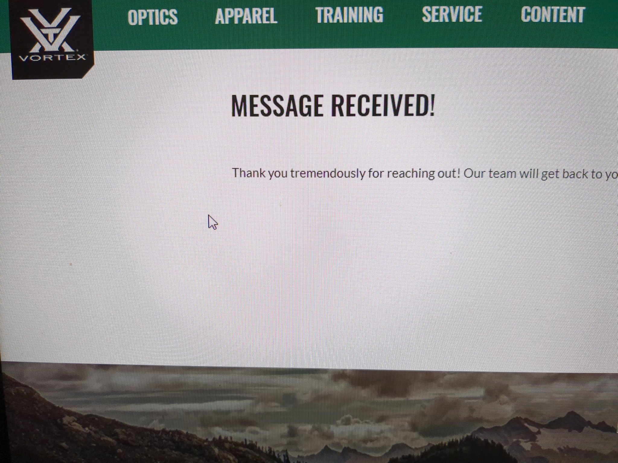

    I have sent vortex a message. CR2 batteries aren't the cheapest things. I figured the 2pack I bought would of lasted me for years, not weeks. Too bad they didn't make it a 123a battery. I have a mountain of them for flashlights and etc.
