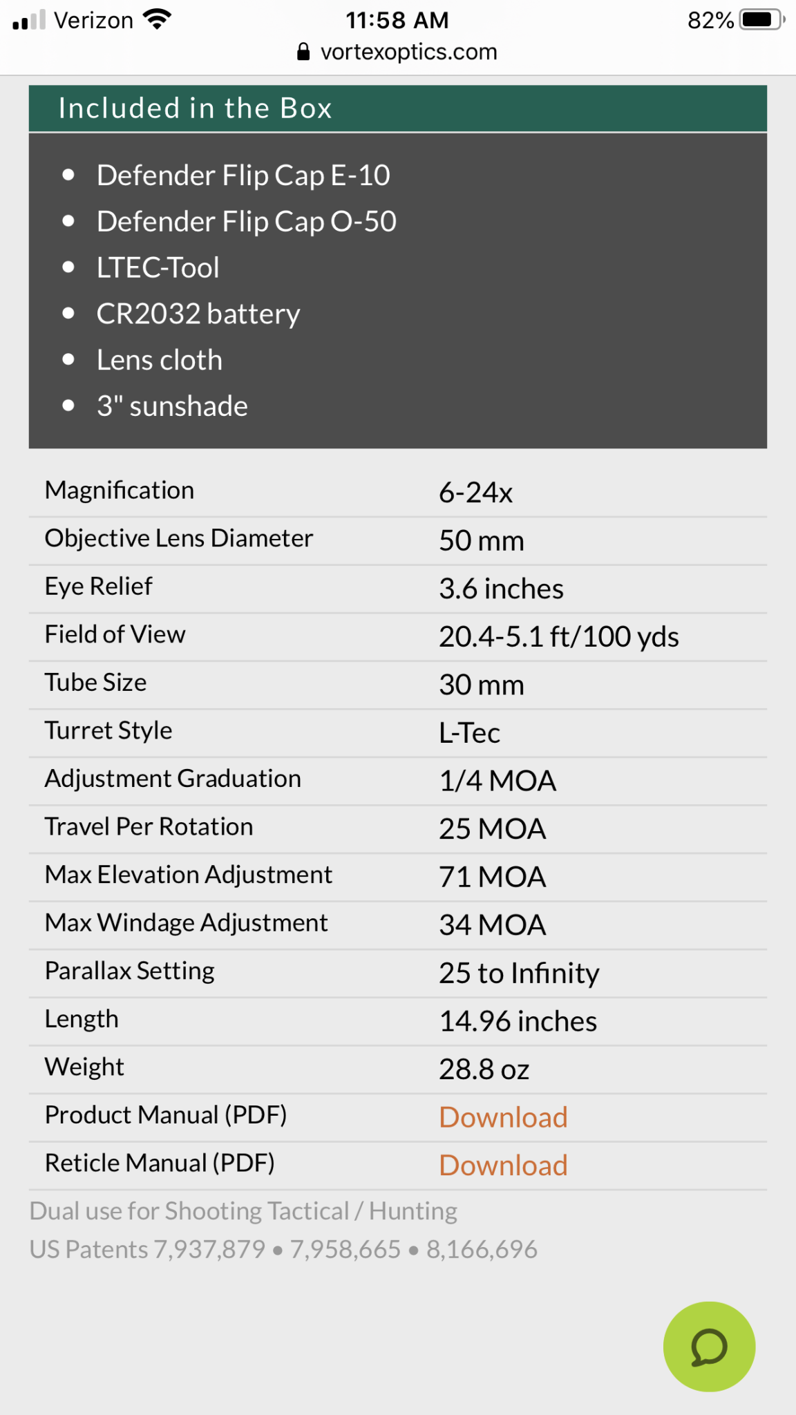

71 moa of travel.
I doubt a 100 yard zero will happen.
With 30 moa it should be perfect.
In answer to your question...the cant of your base AND rings should not exceed 1/2 of your scope's total travel. Of course there can be exceptions; an example would be where the internal travel of your scope is not truly as spec'ed but I would not count on that.
So, in your case, the scope's internal travel is said to be 71 MOA, this means you have 35.5 MOA up and 35.5 MOA down. If you want to zero at 100 yards, the combined cant of your base AND rings should not exceed 35.5 MOA. As "Steel Head" said "...with 30 MOA it should be perfect".
The internal travel of the amg isnt 71moa. Otherwise, all good info ?
I’m curious as to how much is available with the zeroing feature.
I can only go off of what they advertise.
Reactions: Sig Marine
Since I didn't have the scope in hand to actually run the turrets, I had to go off what the manufacture/Vortex lists in their specs for the AMG. This said, the travel from one scope to another can vary as well...it's best to test the actual scope for travel to know exactly what is available to you.
I was surprised a bit as that’s about what’s advertised with the 6x24 HS-T and original PST.
The amg is limited by the turrets. The internal adjustment that’s used when zeroing is more. Sadly, that’s a drawback to the moa version. The mil version has a lot more adjustment on the turret.
