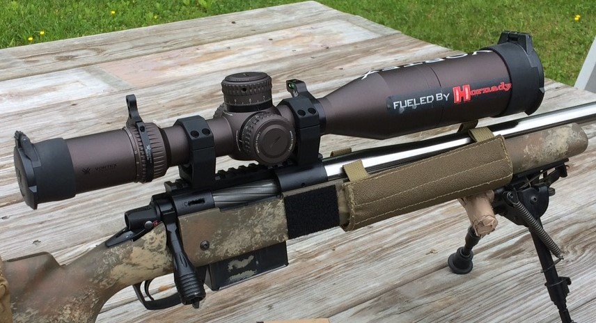

Just to give you an idea here is a Surgeon with a 4.5-27 and caps in 1.26" height rings. I got them back before the 1.1 were available and the 1" were too low with the other M24 contour barrel on it.
