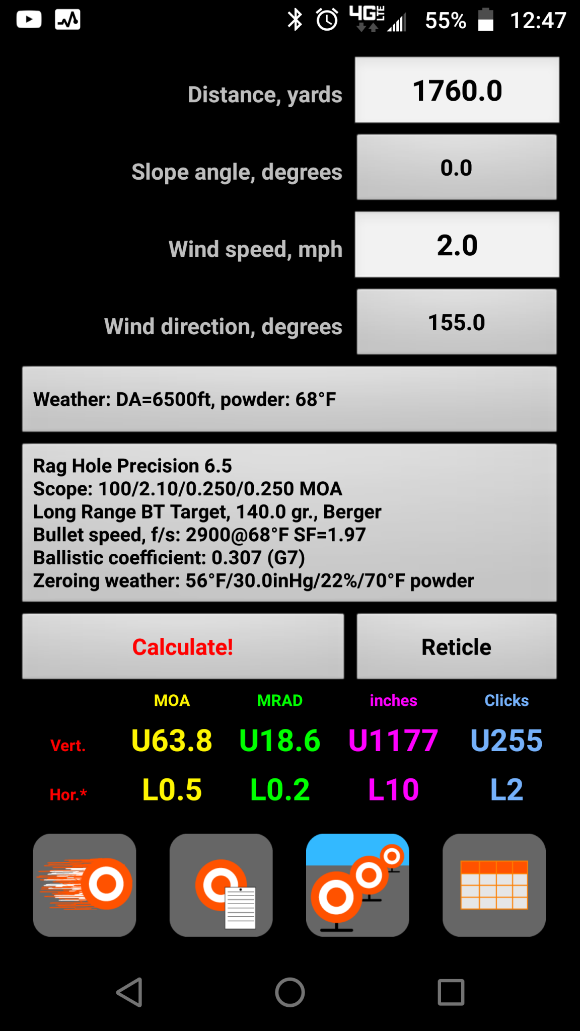

    I don't shoot mils. The PST gen 2 has 70 plus minutes of travel, I use a 40 moa rail so I can use all of it, and can dial 74+ minutes, I only need 63.5 to shoot a mile.
    And I just looked, my 6.5CM only needs 18.6 MRAD to get to a mile.
    Interesting.

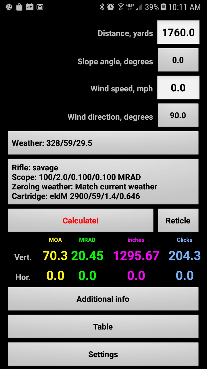

    With the Hornady 140g eldM with a .646 BC Zeroed at 100Y running at 2800 FPS my Shooter app
    says I need 25.7 mil. The web based Hornady ballistic calculator says I need 22.6. I'd have to be running it at 3050 FPS to get it there with 18.5 mil according to to Hornady calculator.
    Sounds like I'm running the wrong bullet/velocity for that sort of thing. Most of the youtube vids I saw people were using about 95MOA = about 28 mil. What bullet/velocity are you running?
    Looks like there are big differences in the various calculators. I wonder which ones are right. Maybe I should move to Sterlok for an instant range extension with my current scope.

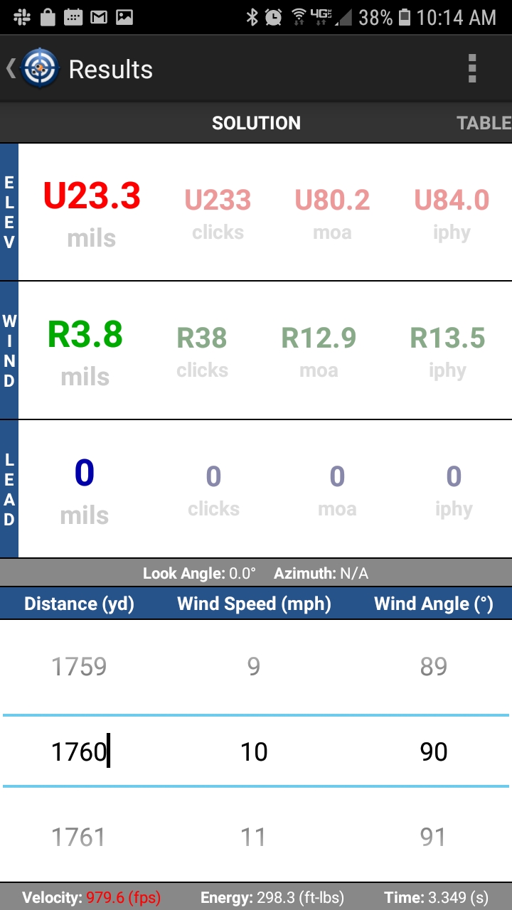

    I've only taken mine out to about 900y and the drops I get from Shooter work great. Maybe the calculators diverge beyond that.
    Here's what I get from Sterlok and Shooter. In Shooter i was using an initial vel of 2900 and G7 of 0.305
    Anyways, You've done it so I trust you're data. I'll find out how it looks when I give it a shot. I'm starting to feel bad for derailing this thread so I'll Shoosh and see what happens when I get out there. Either way, Sterlok gives me values closer to what you're getting so I'll probably use this when I go out that far and consider completely switching to it.
    At 500y Sterlok gives me 2.42mil and Shooter gives me 2.5 So it sounds like they diverge out at distance.
