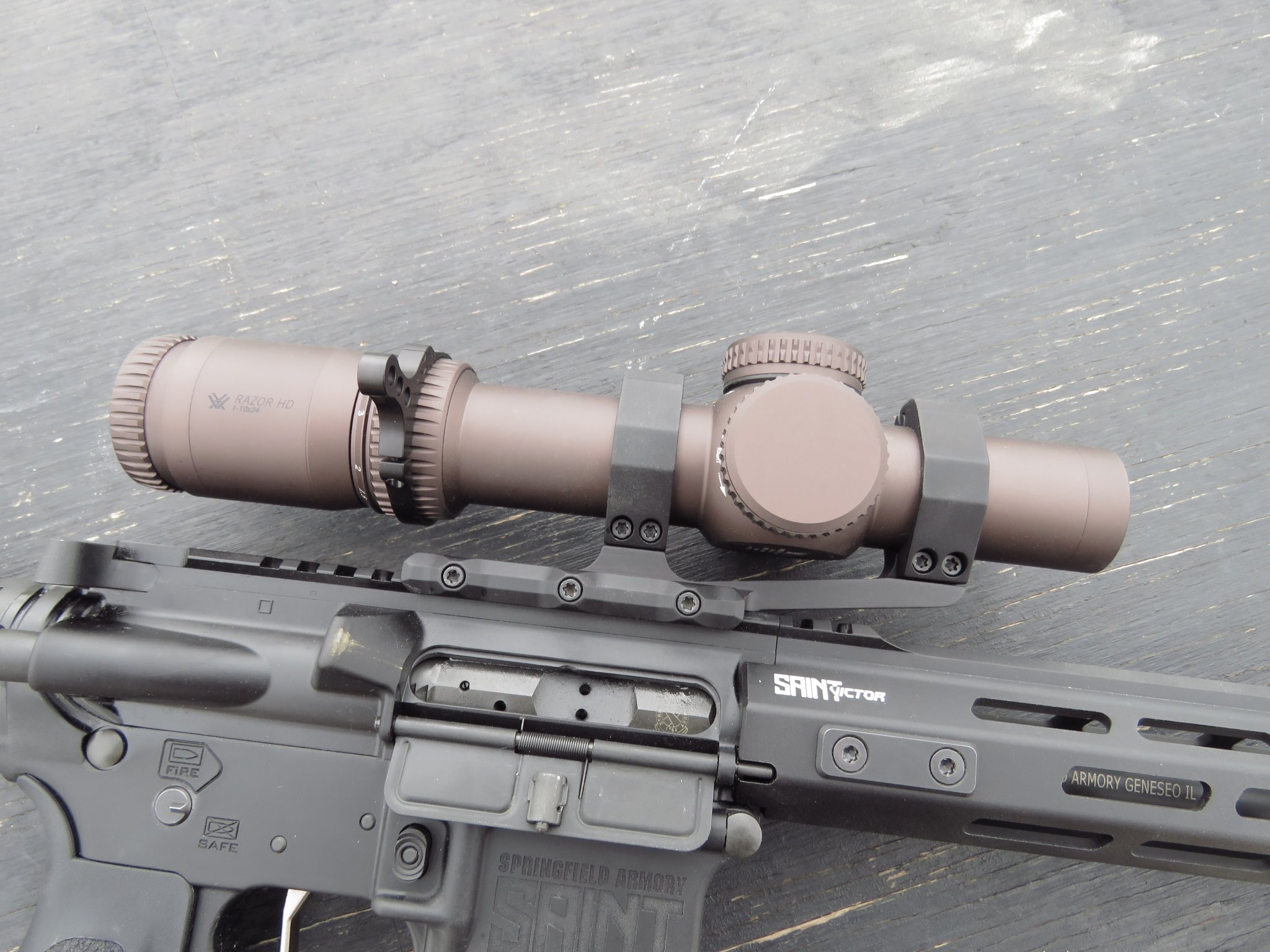

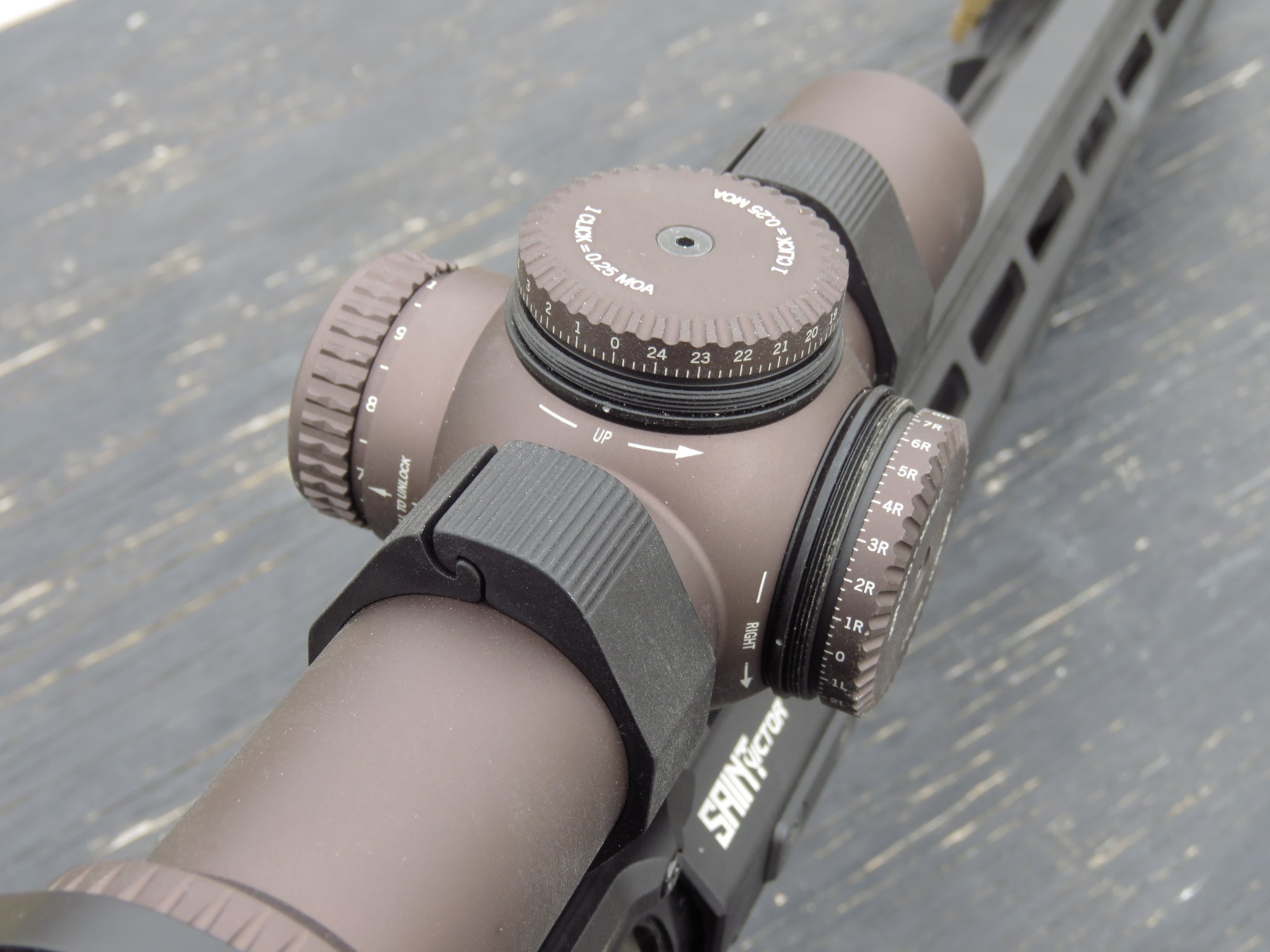

    So, I only had to do a short write up for a publication so now I’m going to offer some more comprehensive thoughts on the subject for you fine people.
    Unboxing and Overview
    I have to say that the Gen III 1-10 comes in one of the nicest scope boxes I’ve ever laid my hands on. It has a magnetic closure on the lid, fitted foam inside, and a space for everything from the manual to the sunshade.
    Lifting the scope out of the foam I immediately noticed an impeccable level of fit and finish, it exudes quality in my opinion. Nothing felt gritty, loose, or too tight for that matter, it all felt just right. The euro-style ocular adjustment was stiff but it rotated smoothly so it was easy to get the reticle focused but it’s not like it was going to get bumped out of adjustment by just taking it out of the case. Same with the magnification ring, it rotated perfectly but with a slight resistance, which is why it makes sense that Vortex included a SwitchView throw lever in the box. Mounted on a rifle, fully rotating the magnification ring would be awkward. Illumination, elevation, and windage knobs felt good, no complaints there at all. The clicks on both elevation and windage knobs were audible and tactile and quite consistent throughout their rotation.
    I’m not going to bore you with a bunch of figures but it is interesting that Vortex was able to keep the weight and length the same as their Gen II 1-6, while increasing tube diameter and magnification.

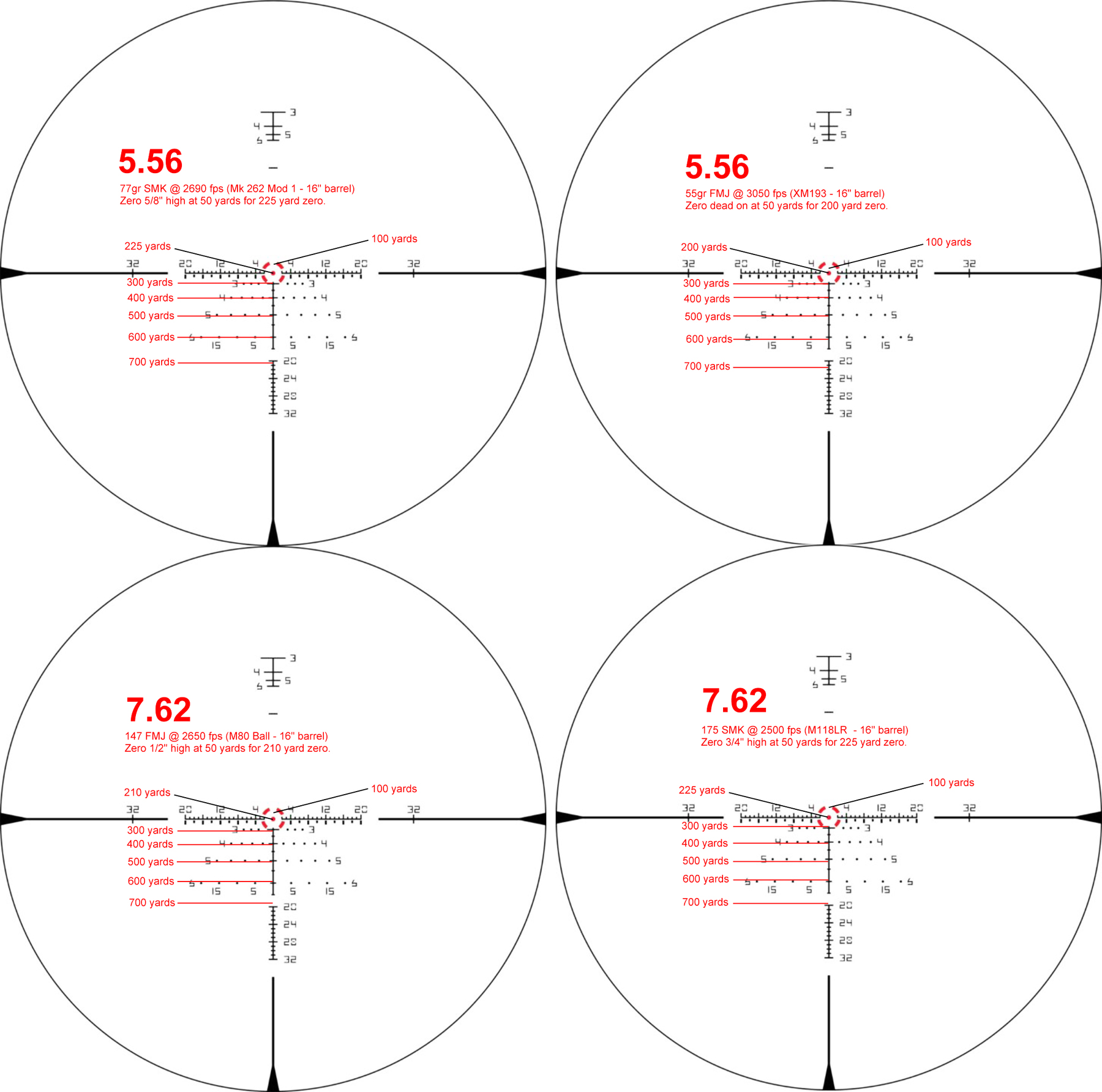

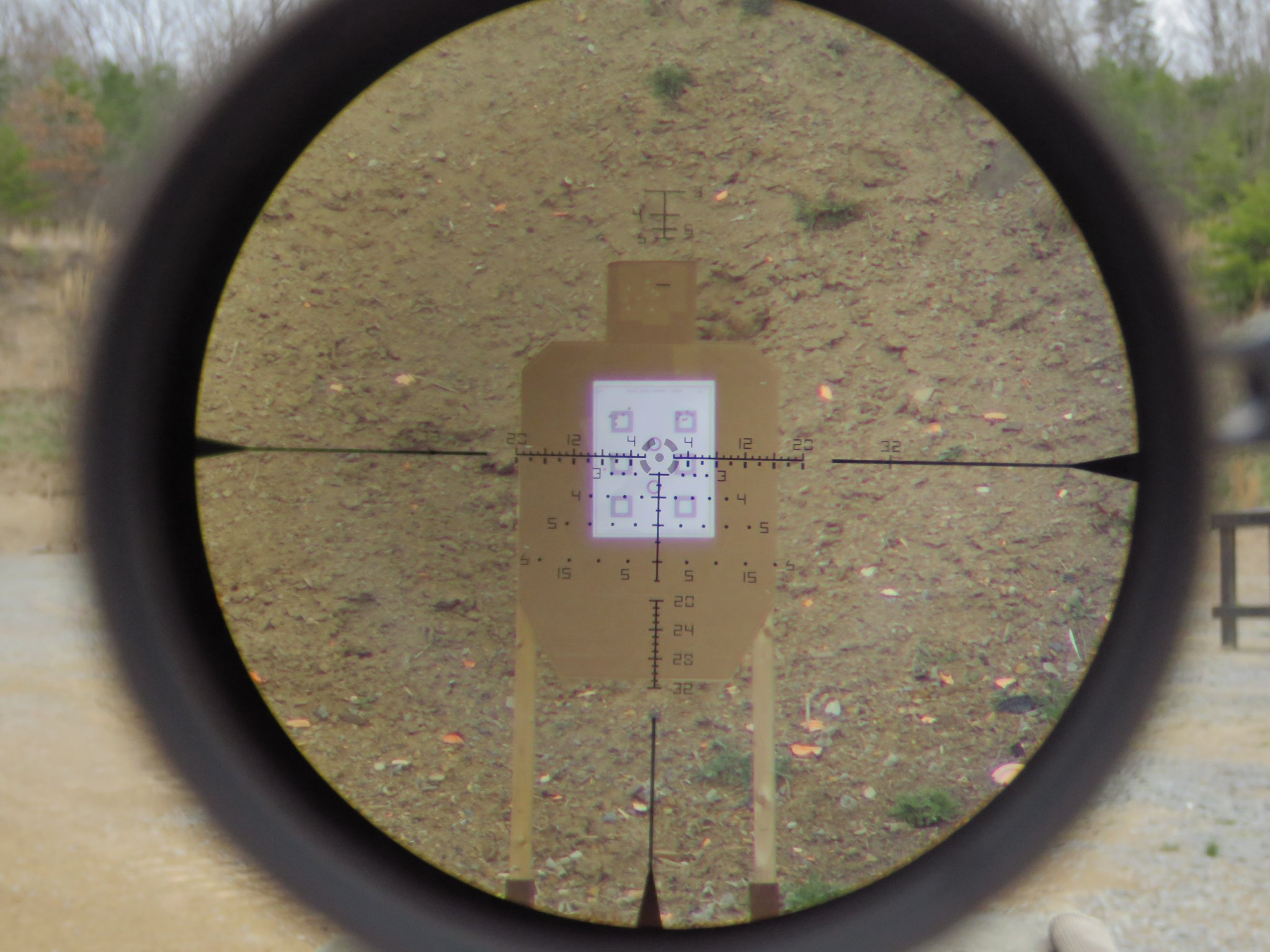

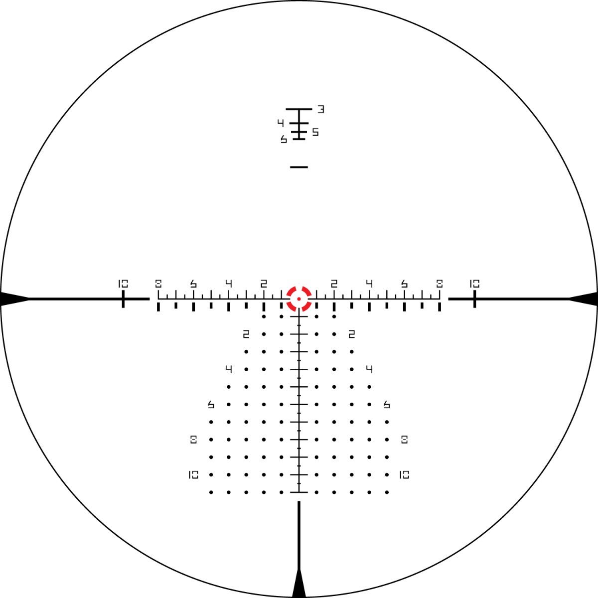

    The EBR-9 MOA Reticle
    While I’m a pretty die hard mil/mil kinda guy, I wasn’t going to turn down a chance to check this optic out simply because it had a MOA reticle. The EBR-9 MOA is actually a BDC reticle located in the FFP and follows Vortex’s general subtension layout that I’ve noticed is common amongst their different BDC reticles. This isn’t a bad thing and they’re kind enough to supply an excellent reticle manual to help you work out your drops for most common 5.56 and 7.62 ammunition types.
    That being said, instead of doing the old zero at 50 yards and hoping the hold over lines match up kinda close method, I went a different direction. I tuned my zero at 50 yards so that I could give the trajectory of the round the best possible chance to match up with the hold over lines from 300-650 yards. This isn’t going to work out perfectly in every case but it’s pretty damn close. For example, if I was shooting Mk 262 Mod 1 and simply zeroed dead on at 50 yards the actual ranges for the holdovers could be 20-30 yards off, so instead of the 500 yard line being 500, it’d be 470 yards. However, if I tune the zero to be ½” high at 50, that works out to roughly a 220 yard zero and the hold over lines are matching up to within 5 yards or less out to 600 yards. JBM Ballistics was an excellent resource to help work some of this out and I found that I could get the hold overs to match up with 77gr SMK’s, 55gr ball (within reason), M118LR, and M80 ball too.

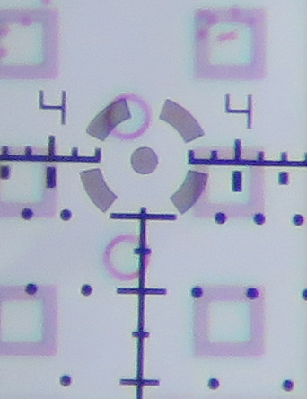

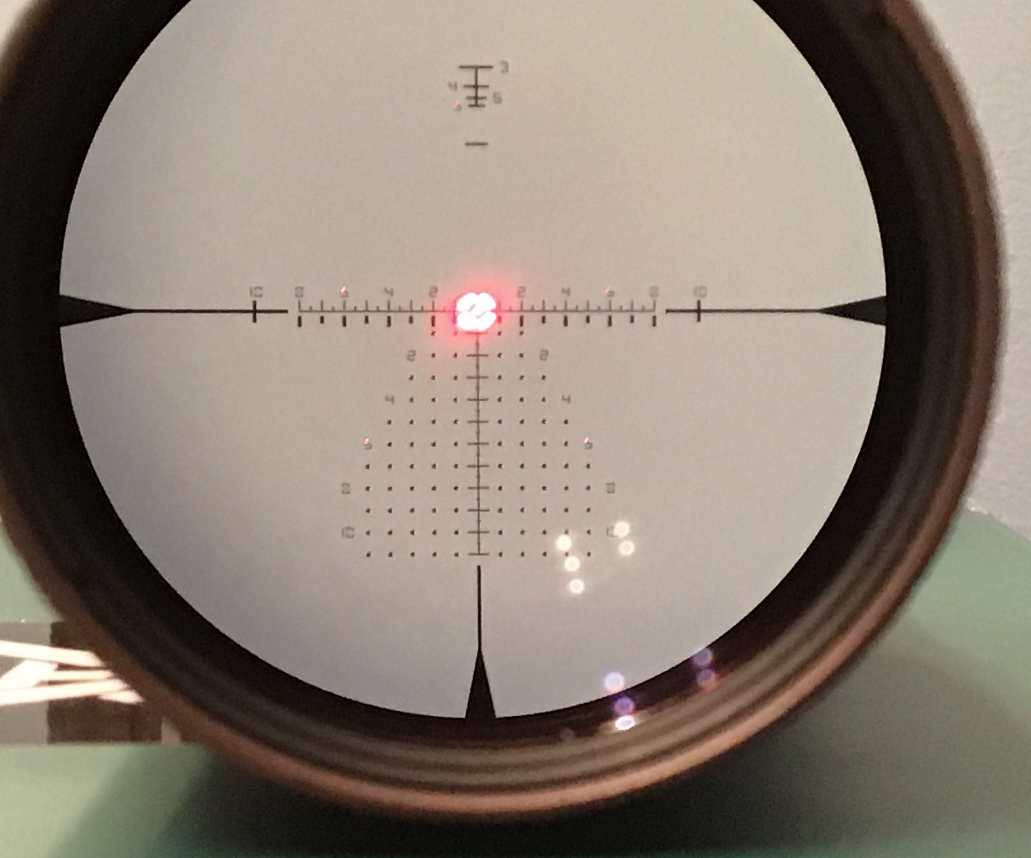

    There is a ranging feature on the reticle but thankfully it’s up and out of the way in the reticle, i think they realized that using the holdovers stadia for ranging is lost on most of us. We’re usually not engaging targets that fit the criteria for those brackets and we’re better served by windage holds. The windage dots to the right and left side are calculated for 5,10,15, and 20 mph winds, although with JBM I found they mostly correlated to a wind speed a couple mph faster. Not a big deal really, for the most part the windage holds are within 1 MOA so depending on the size of the target it will still be a hit.

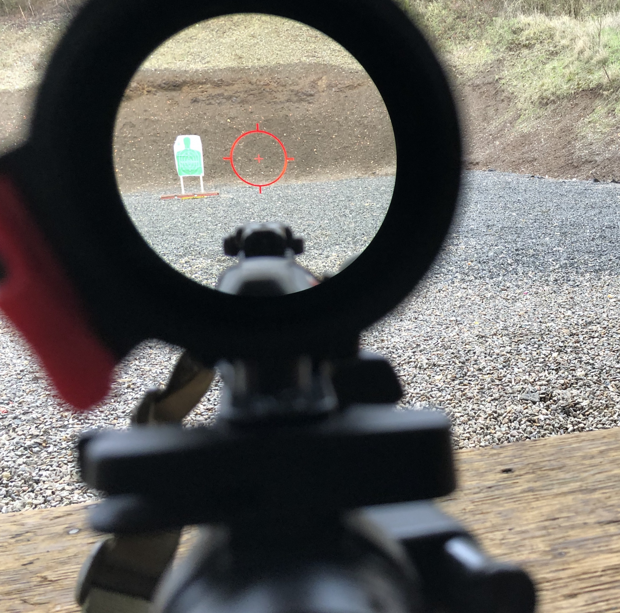

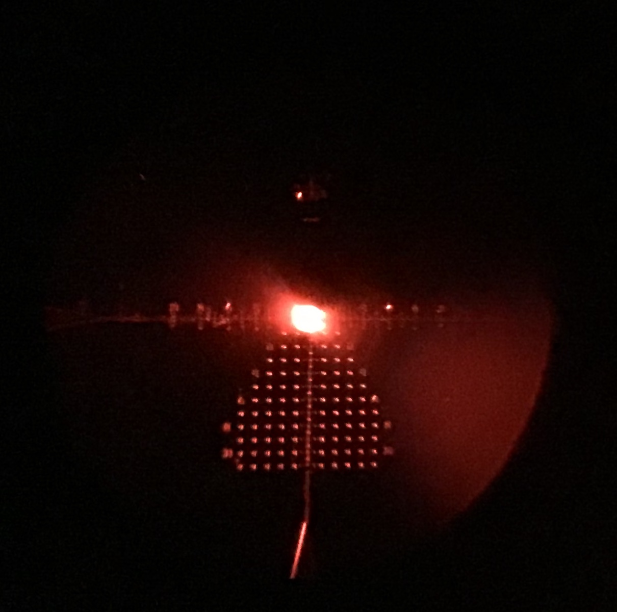

    An interesting feature to this reticle that I actually fell in love with is that the illuminated portions of the reticle are somewhat see through. Segmented circle reticles like this have normally been solid so that they can illuminate but this has caused heartburn because that tends to obscure large portions of the target on higher magnification.
    With the reticle being see through, those obstructions are a lot less evident and you can more precisely place the reticle for consistent holds. The illumination itself is daylight bright and the typical day time setting that I found myself using most of the time was “7”, in bright, bright conditions bumping it up to “9” may be necessary. The highest setting might be for shooting directly into the sun, I haven’t gotten confirmation on that but if you dial it up that high, grab your shades before you look through the scope. Down at “1” the illumination is almost too bright for night time settings but then I thought about how this scope might be used in the context of a duty or defensive rifle with a white light. If there was a low setting to where the reticle was still visible but wasn’t not so bright that it washed out the target behind it, it’d definitely get washed out the moment you activated a multi-hundred lumen light. With the lowest illumination setting as it is, you can activate the weapon light and not worry about losing the reticle.

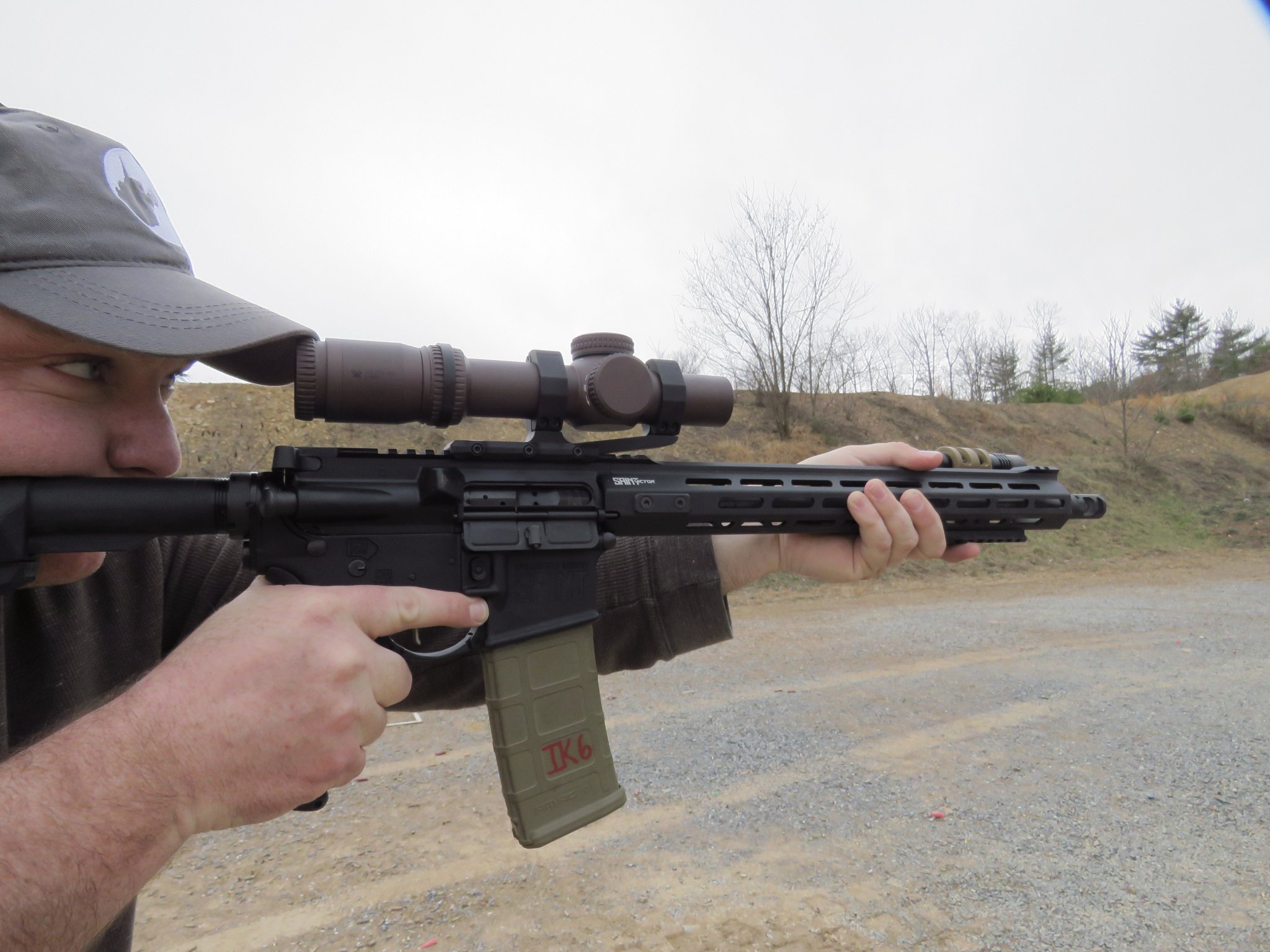

    Because of the nature of the review and current events I didn’t actually get as much range time with the optic as I wanted to get a full, in depth review. I mounted the scope in an AeroPrecision extended 34mm mount and I’m glad I went with that mount because this scope has some serious eye relief. I had the scope pushed a little farther forward than I’d normally have it. Getting the optic zeroed was incredibly easy, I was on paper in five shots but I think that was more by accident than by design. Even still, tracking was spot on, I tested the tracking up to 30 MOA and back down to zero and experienced no significant issues with the mechanical tracking.

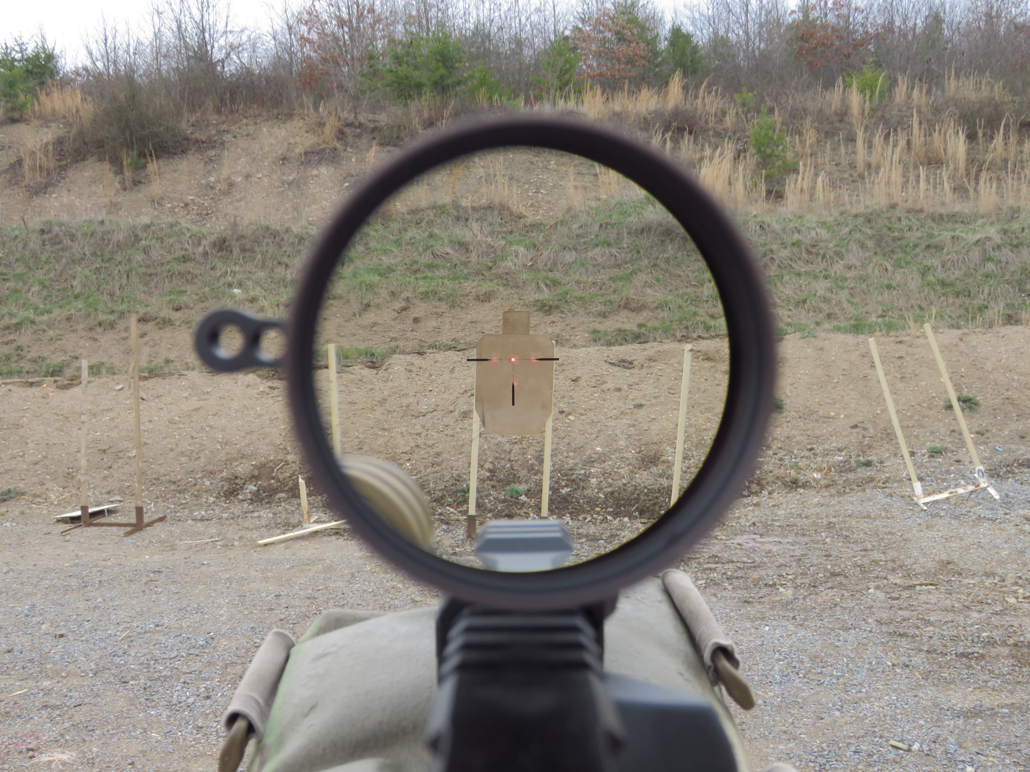

    Down on 1X I was pretty much as fast with this scope as I am with an Aimpoint. I had three IPSC targets set out, spaced about 20ft or so apart with the drill being two shots center, two shots left, and two shots right. Transitioning between all three and getting good center of mass hits generally put me in the 3’s from about 10 yards. Where I thought having this huge illuminated dot would be a disadvantage somehow turned out to not be the case at all, it was super easy to pick up and put exactly where I wanted rounds to be.
    The BDC reticle and FFP makes this scope pretty brilliant at longer distances too, especially since the reticle isn’t going to obscure large portions of the target. Being perfectly honest even though I’m a mil/mil guy, this BDC reticle is pretty bitchin’ I wouldn’t cry if that’s what I was stuck with. If for some reason you feel the need to dial out to longer ranges, the elevation knob has 25 MOA in a single turn, which should be more than enough to get you out to 700 yards without getting lost in the rotation.

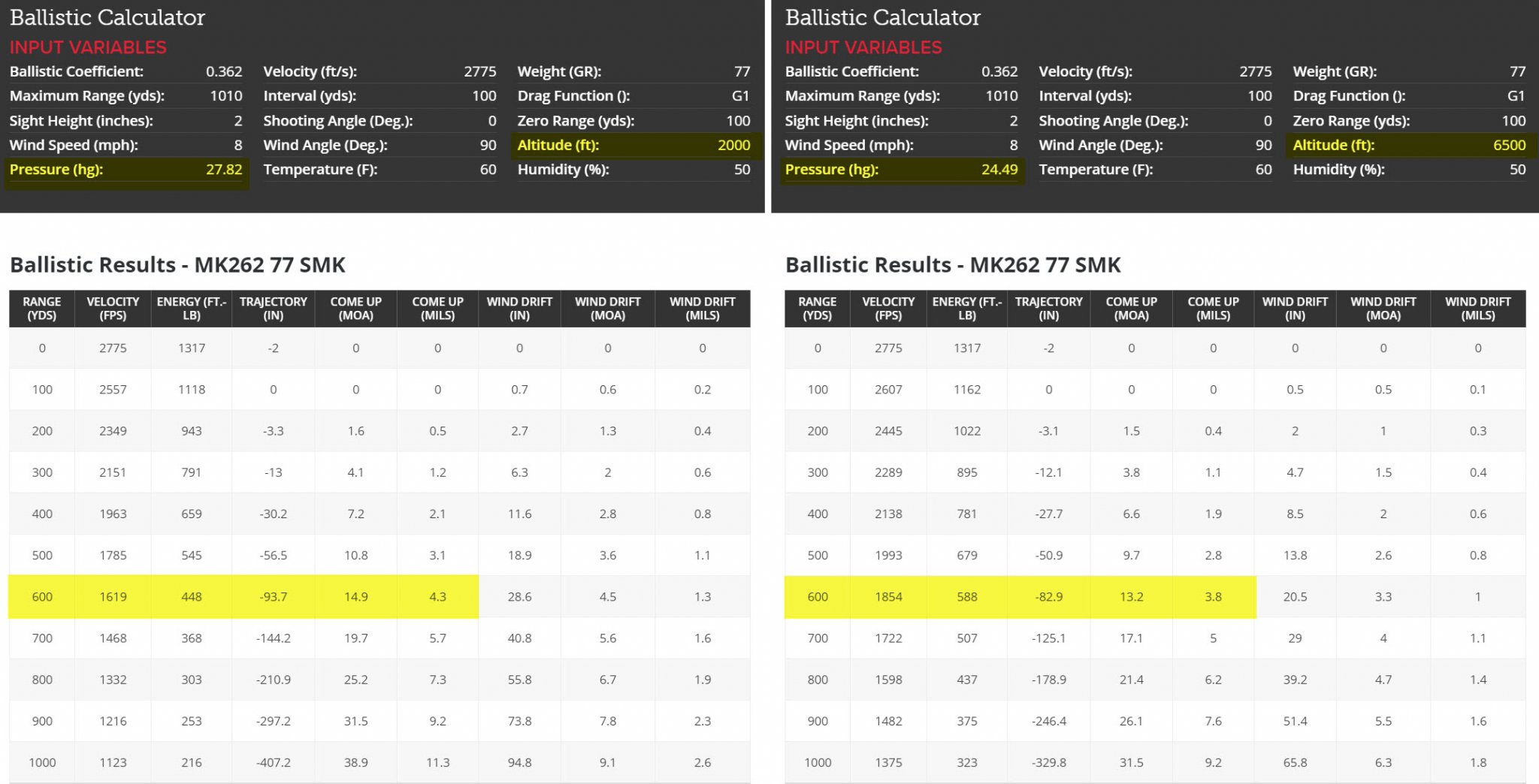

    another factor is how much would atmospherics impact at the range this scope is designed for?
    i wish they did the bdc reticle in mil...wonder why they did not
    The drops that I used in my examples were based on a 2,000-3,000' DA, which is pretty average here where I'm at in the warmer months. If I continued to use a 225 yd "zero" at higher altitudes then there will be larger differences between the trajectory and the subtensions of the reticle. I ran some numbers with the Mk 262 and if things spiked to 5,000' DA somehow I'd be about 8" high at 600 yards. Depending on the size of the target, that could still be a hit. However, if you're in an area that generally has a higher average DA then you could probably tune the zero a little to bring it closer back in line with the subtensions. Using the 5,000' DA average from above, if I bring the "zero" down to 210, about .25" high at 50, then I'm within 1 MOA of the subtension on the reticle at 600.
    I have a feeling that using the reticle manual that comes with the scope and some time on JBM Ballistics you can get the BDC reticle to work out in most conditions. Shooter and ammo dependent of course.
    Great review! I didn't notice the semi-transparent circle segments before, but that's a very clever touch by Vortex.
    For most of the country it may not be a big deal, but in my neck of the woods (Colorado) it is not uncommon for DA over 8000' where I shoot. For up to 300 yards I'd say it's not going to matter much, but once you get beyond 300 the numbers start to increase. I ran some rough numbers using 2000' as a baseline and then input my altitude and just the change in altitude (and barometric pressure) shows a difference of over 10" by the time you get to 600 yards.
    I still need to build my SPR and find out exactly what ballistics are at my elevation/atmospherics but this should be good enough to give an idea of what just atmospherics changes can do when using the exact same rifle and cartridge.
    My personal belief is because the majority of the US market is still stuck on moa and the BDC shooters will typically fall into this.
    Back to the Razor Gen III 1-10, how is the parallax doing when stretching it out beyond 300 yards, is the image still clear and parallax free?

    @wjm308 thanks for running the numbers and they were about were I expected them to be. I think the majority of shots with this will be in 300-400 yards. As you push out using the turrets may make more sense, but without a Zero stop make sure you get it back to zero properly.
    I am 90% sure I will get one of these for a 16in 308
    Reactions: Glassaholic
    A technique to overcome this is to dial the distance you care about to your DA - this is easier if your turrets are nice. Doing this with less reliable turrets, ie an ACOG, you'll want to confirm at distance, or confirm the sub-distance offset.
    If you dial up the 11'' less drop (let's just say 1.75 minutes), you'll be good at 600 yds. According to your chats: You'll be about an inch off at 500. 3.5 inches off at 400. 4 inches off at 300. 3 inches off at 200. 1.75 inches off at 100. Pretty good for a BDC. It'd be tighter if you dialed in at 500, because you'd only dial about a minute. Don't get me wrong, it's not perfect. You'll miss a face at 300 if you're 4 inches off. But you'll also miss the opportunity to shoot at a face if you take too long, and the BDC is supposed to help speed you up.
    I would agree, the BDC is more about "quick" than it is about "precise" but the more precise we can get it to match rifle, cartridge and atmospherics the better. Would like to play with it to really see how far off it is at my location and see what can be done to "dial it in" so to speak.

    My scope showed up today. No shipping notice or anything. I had planned to order my mount when I got shipping notification...oh well...ordered that today. In the meantime, I opened up to play with it a bit. When I turn on the illumination I notice a strange pattern and I was wondering if it’s supposed to be like this/there for a reason.
    I apologise for the poor photo, but it’s the best I could get with my IPAD. It was set at about 9 on yhe brightness in this photo, but the “pattern is visible at all settings. It is visible at all times the illumination is on (daylight/darkroom).
    MRAD reticle
    What I am seeing is 5 points and the angled line at the bottom. The 5 points seem to correspond to the top of the tails on the number 6 at the various locations, so the points are not on the “crosshairs lines”. The angled line corresponds to the left side of the “arrow” at the bottom of the crosshairs line.
    In the poor photo you can only distinguish three of the five points I am referring to, the ones in the tree aren’t making it it in the photo.
    So, is here a reason for these points and the line to be there, or did I get a bad reticle?
    Yes. Even at lowest setting in daylight. That is actually when I noticed it, the brightness in the picture above was just the only photo I could get. I’m able to see it when the Christmas tree gets large enough, starts at around 2 1/4 power for my bad eyes.
    I was just able to get a lights on photo that you can see the 5 points in.
    The center point looks brighter and blurry in the photo compared to actually looking through it. Again, my poor photo due to iPad.
    I noticed a similar condition with the one I reviewed but I took it as a byproduct of having a daylight visible red dot in a FFP configuration. When I ran it down to 1X it was not noticeable, only at the higher end of the magnification range, where I doubt I'd be running the illumination on anyway.
