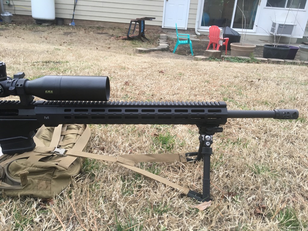

20 MOA is 6 mils’ish. I don’t think you need 40 MOA personally. 20 is more than adequate. As long as you don’t have a full top rail on your RPR the 1.5” rings will be fine with a 56mm objective (I think). I have a full rail and a 50mm objective on mine with room to spare and scope caps

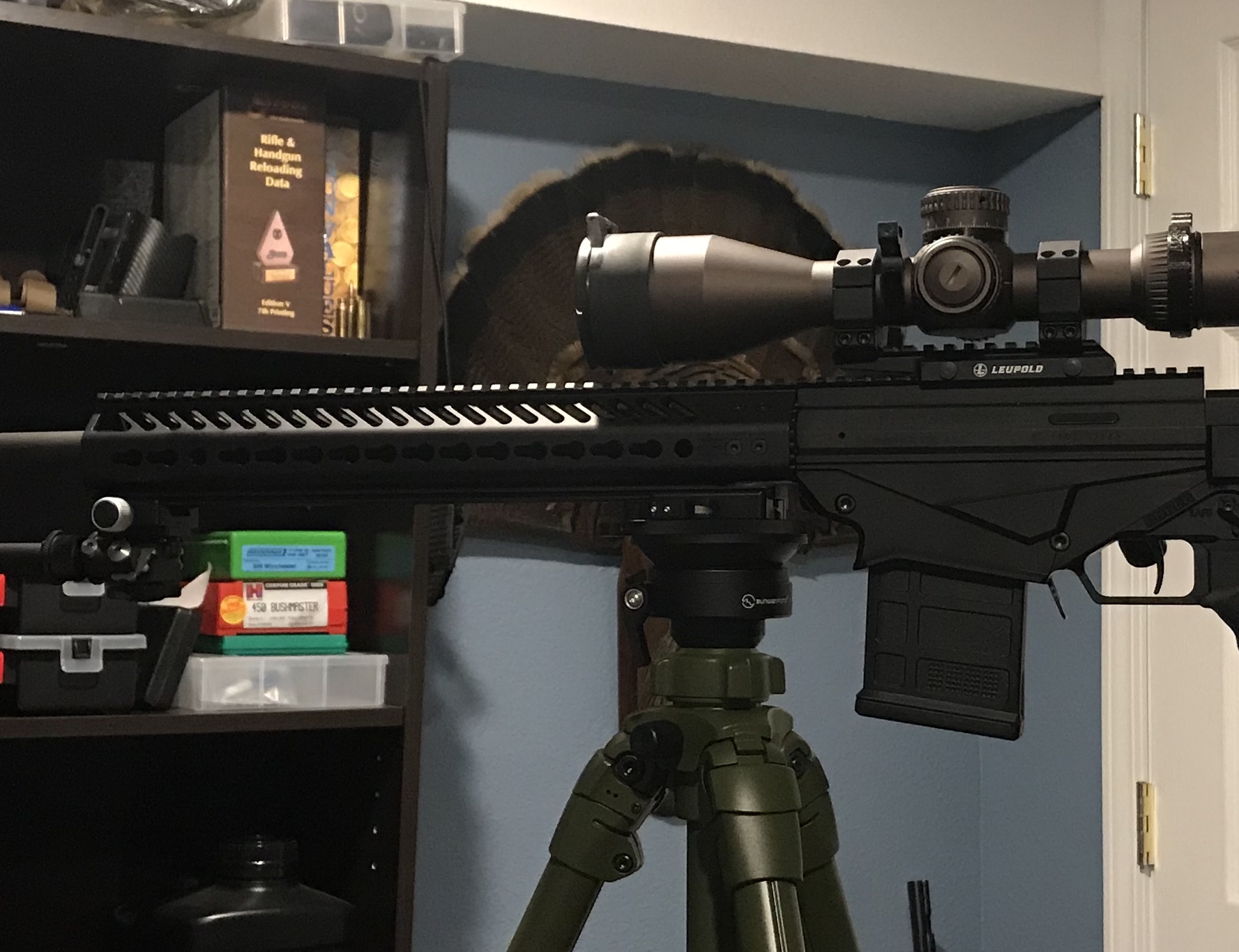

I have a Tikka T3X TAC A1 which has a full rail out front and I have the Razor Gen II. I used the Seekins 1.45" rings and there was just enough clearance for the Vortex Defender scope caps.
Note the rail on the Tikka is 0 moa so if there were any tilt like on a 20moa pic rail you might not have enough clearance for the scope caps.

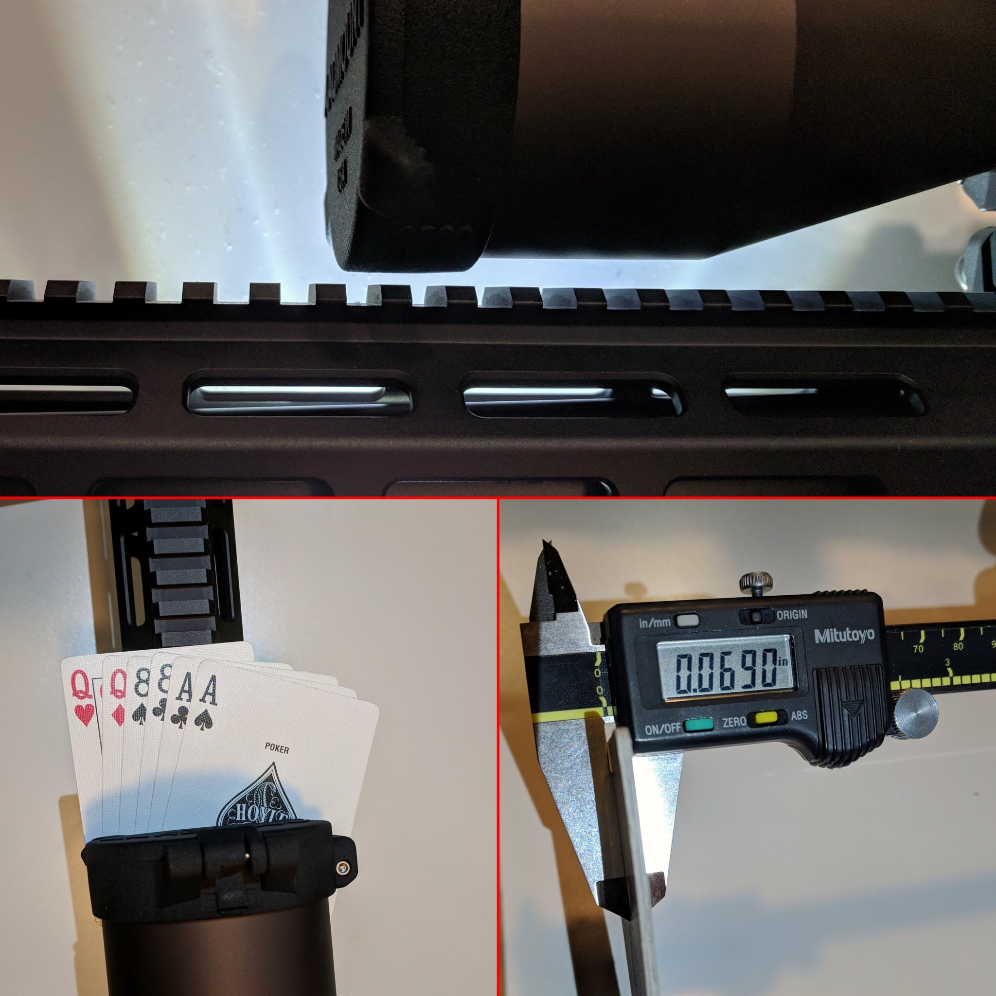

Here's my Vortex Razor HD Gen2 4.5-27x56, with AADMOUNT caps, on a Spuhr SP-4603B mount on a Tikka T3x Tac A1: Rail is 0MOA, mount is 38mm (1.496") high with 6mil (20.6MOA) of rake.
The AADMOUNT cap clears the rail by 1.9mm (0.075") -- 6 playing cards (0.0690") will fit in the gap, 7 cards (0.0805") won't.

It'll be very close. If your front ring is at the same location on the scope tube as mine, but the center of your ring is 0.046" lower and your rake is 20MOA vs my 20.6MOA, you'll end up with 0.030" (0.76mm) clearance between the rail and a cap like mine. Thirty thousandths of an inch might be enough to absorb the manufacturing tolerances in the scope, cap, rings, and rail... But if I were you I'd be looking for taller rings or a thinner cap.

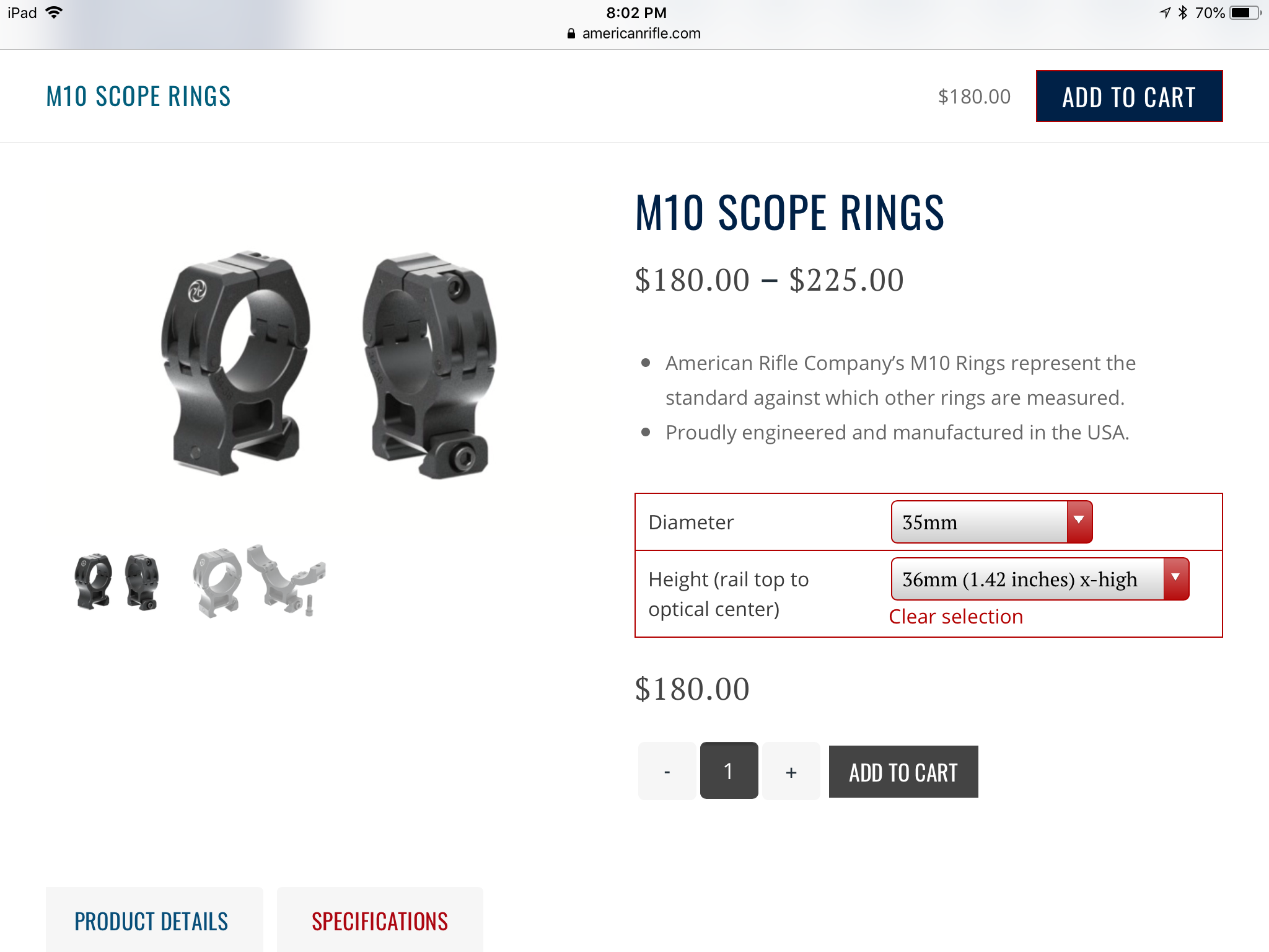

I'm not seeing any 34mm rings higher than 1.45 outside of the Burris signature whatever they are that I'm using now. They're 1.5. I have 30MOA in the rings from the inserts in addition to the 20 MOA base. What can I say I want all up elevation lol
