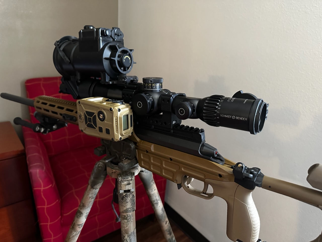

I guess I'll pump out a mini-review. I bought the Impact 4000 and then went on to get the Razor 4000 GB to complement it.
I procured the Impact 4000 first and have just recieved my Razor 4000GB. TLDR: I would buy both again, and I did.
THE RIGHT WAY TO MOUNT IT

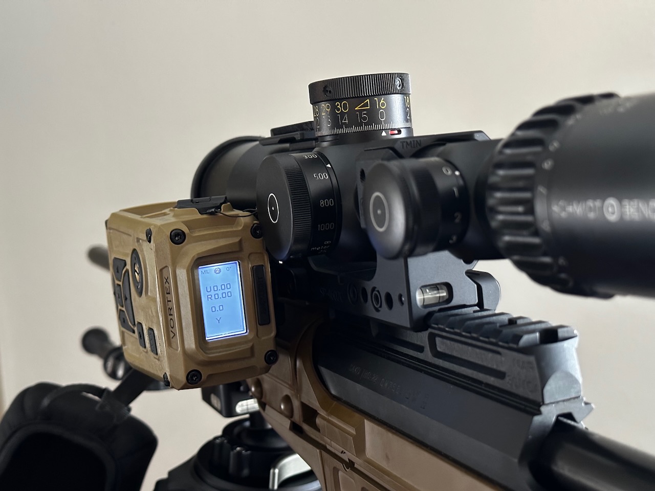

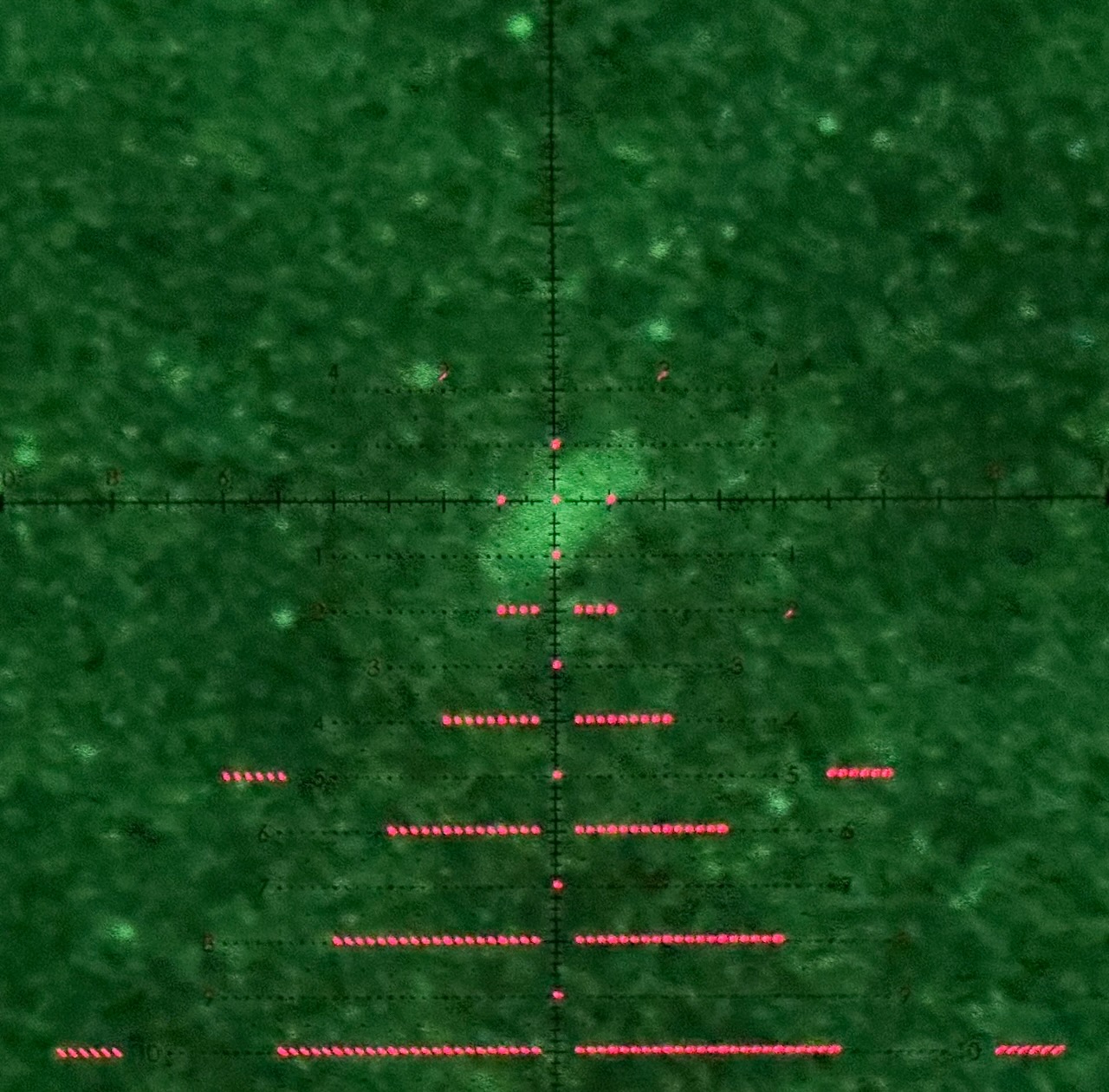

3MILx3MIL LASER SPLASH DOWNRANGE
~905nm laser. Expected at this price, but 1550nm would have rocked
~It has a slash-shaped beam pattern. 45-degree angle from bottom left to top right. No idea how that is supposed to work well.
~ The application had difficulty connecting to one unit for a moment
~The idea of a network of devices to provide data/solutions/etc is neat but complicated. Especially since it auto-joins other devices in a network, or at least it did in our testing. I wish it was able to be switched on with "advanced" mode.
~I would have preferred a "Laser Fire" button where the vortex logo is. Why? With gloves, I have a distinct different place to push to get a laser actuation. Instead, I'm always fighting the menu buttons too.
~Not as small as the competition (the $11,000 competition mind you...)
-One of 3 units died every time you fired a round. I polled the massive group of shooters I participated with and our number came out to be 24 in hand, 2 dead. So not awful.
-The display screen updates slowly when cold. This IS an issue if you have to go menu hunting for something.

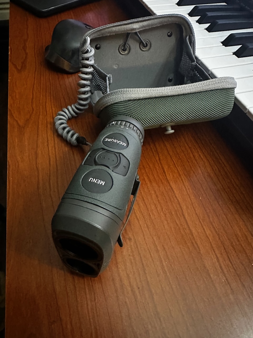

+The case showed that they were listening. Hard

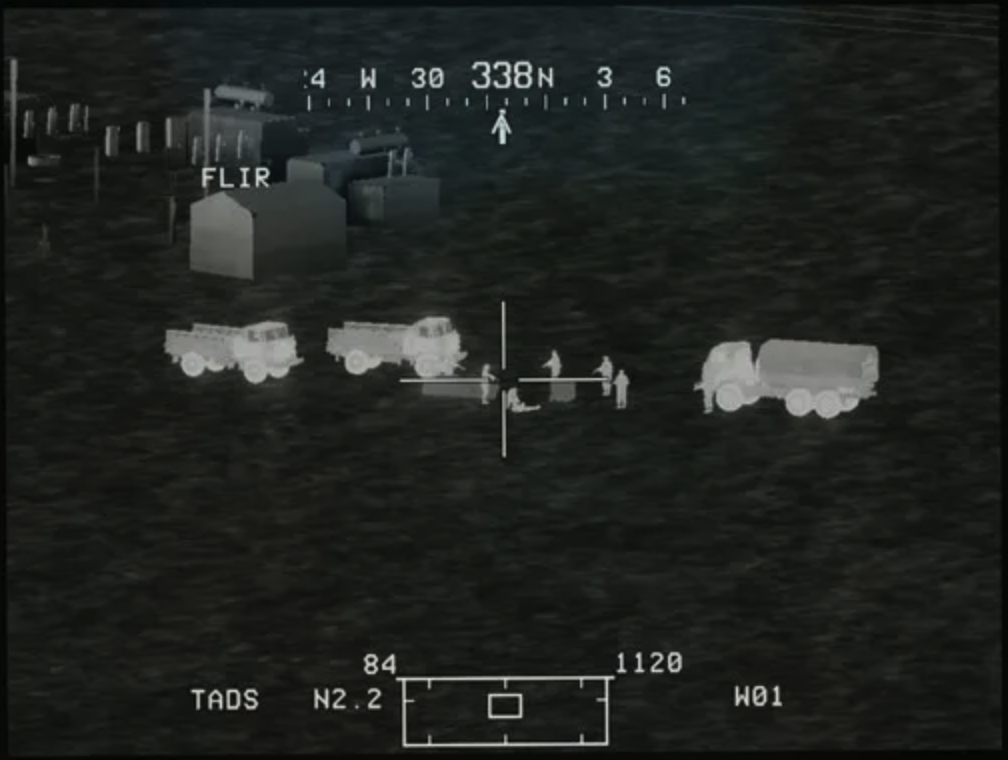

One Thing
One thing i would love to see is the ability to coordinate between the two units as to what I'm pointed at downrange. In the HUD in the app.
I have a compass and inclinometer and GPS data and and and.
The M-TADS system in the Apache for example has a box at the bottom that tells the other person where the designator is pointed vs the gun:

It does and this does work. But I like the HUD type thing that shows azimuth and bearing better than trying to look at a map and figure out where the thing is. Well, really I want both and have one of the two.
Imagine I say take a picture of the AO with my phone...then laser something and drag a pointer onto it on the picture. then that becomes the caliberation for a cursor that moves with the laser.

@MinistryOfTruth when zeroing it did you have to use a vertical and horizontal offset when using it? I’m running a piggyback dot and wanted to run my impact 4K 90* offset like yours but was concerned about ranging accuracy.
You can run offset to your reticle or you can zero the impact to your scope reticle at a distance that is close to the farthest distance you'd be shooting/ranging at.
I personally like zeroing the impact to my scope reticle at 1100-1500yds. I feel this method is more precise than measuring an offset at close range.

So if it 1000 yards, do you dial the scope to zero it. I would use 1000 yard dope and zero it that way?
No, you wouldn't want to do that. If you did that you would need to dial your 1000yd dope everytime you wanted to range something. You want your scope at its zero range. For most of us that's 100yds. I am using the 1000yds or farther target to get the rangefinder aligned to my reticle at its 100yd zero. This way my laser is aligned with my reticle at 100yds out to all of the distances I'm shooting and quite a bit farther. The absolute farthest the laser will be off inside of that distance is at the muzzle. Which would be whatever the offset between the scope reticle and the laser is, but thats such a small amount that it's inconsequential.
