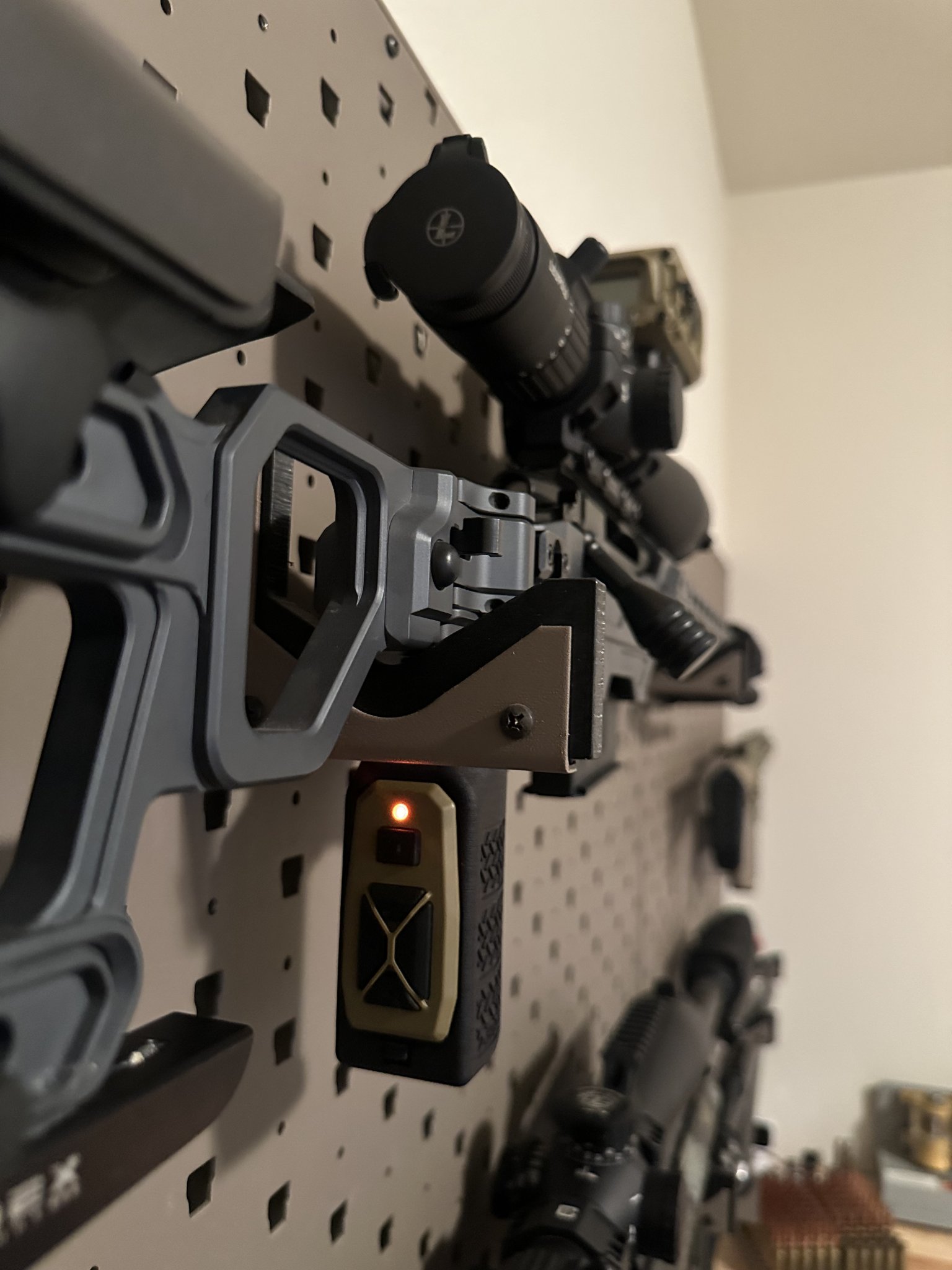

I got in the Big Dog Steel grip for the remote and it’s been awesome once I got it fitted up.
This is slick, gives me an idea about putting my remote for my thermal in the grip like they have for the Imp. 4k

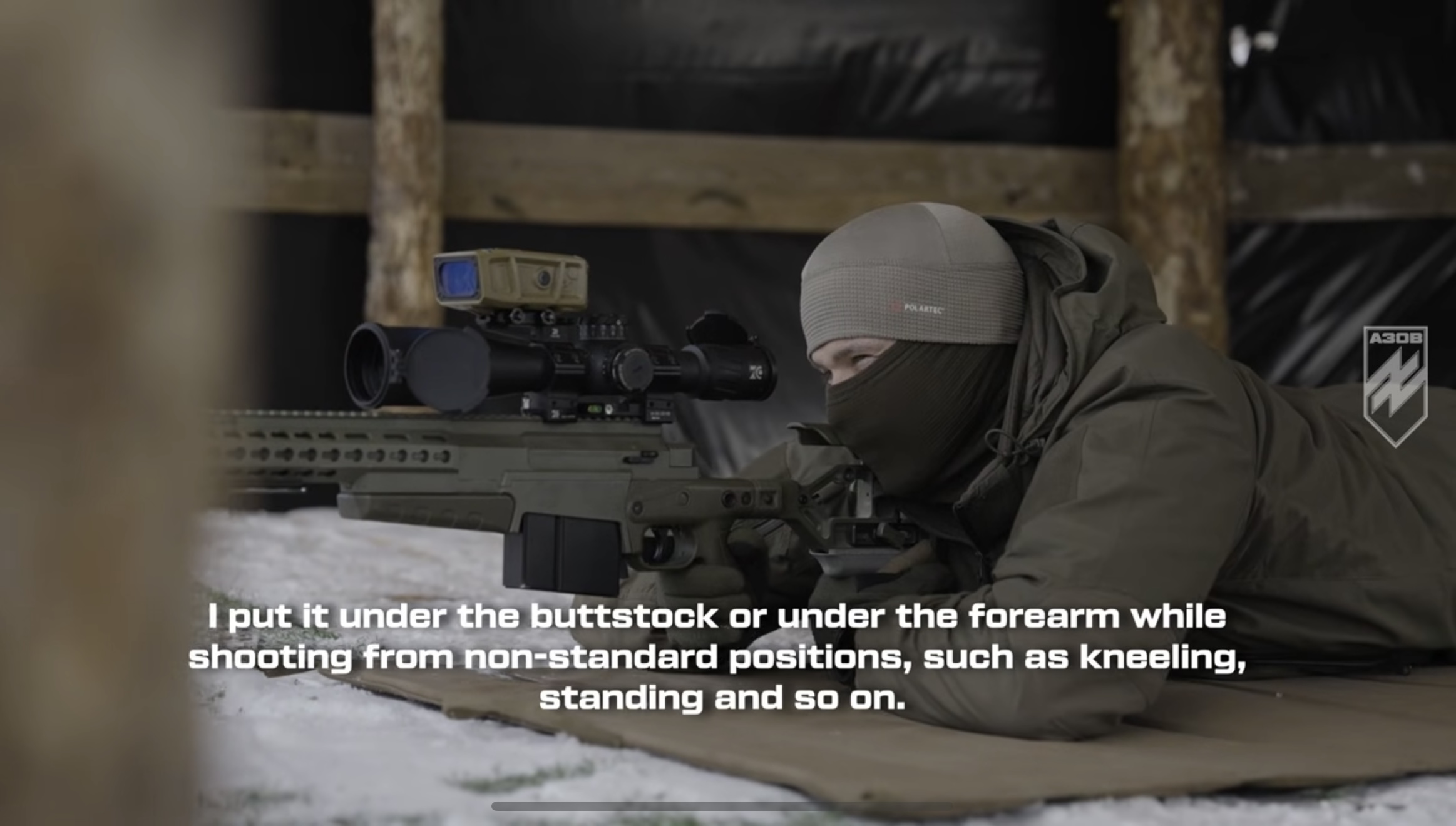

It should work fine, the Ukrainians are using it with their ZCO scopes in the cold and that’s combat.
I dunno about that man (but it should work fine for @hafejd30 in the summer). Perhaps they used them early in the war, but check this out. I wrote about it and also posted a link to the YT vid.
In that same bit they also talk about “aperture detection” at 1:06:20. The Sosna-N anti-sniper robot system sounds scary as shit with it shooting lasers into your scope (and into your eye) while pin-pointing you on a map for enemy snipers to pop you.
Sounds like using any optic over there is risky and requires an ARD. Shooting a civi laser around would also seem to be like hoisting a big “kill me” flag over your head.
