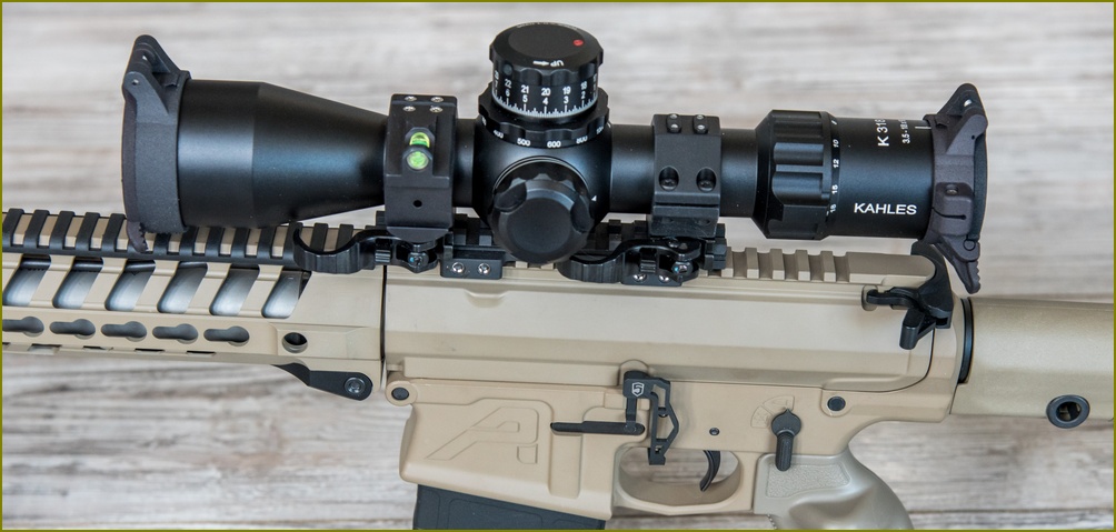

A large percentage of the custom rifles you see pics of have nightforce rings with the anticant in the cap. There is definitely a demand for it. You think somebody would make one.
One issue with this design is that with the bubble at the very top it is extremely difficult to see that bubble without breaking cheekweld (unless you're a hammerhead shark), it also means your scope must be mounted perfectly perpendicular to your rings/base and some shooters like to mount their scope based on their natural hold which will cant slightly. Also, if you're a shooter with presbyopia then anything on that first ring is a blurred mess and if you put it on the second ring furthest from your eye it will be behind the turret again making it difficult to use. Outside of those issues the design is cool, but I like what ERA-TAC has done with an option for a bubble off to the side of the ring, see image below
7071678
Did you try it on the rear ring instead? Seems like your illumination knob would make it tougher to see, but hard to tell for sure from the pic.
Nice rig too...I have several Aero builds. I have Noveske and some other big name rifles, but none I like better than my Aero stuff....big name brand quality at manufacturer direct prices.
It sits just above the illumination knob at normal cheek weld, not as visible as my scope mounted bubbles but not bad either. What’s a bummer is because of my eyes I can’t have it mounted close and I purchased the doctor optic adapter plate for the era-Tac as well but don’t want that close either, I can’t have both obviously off the same ring.
