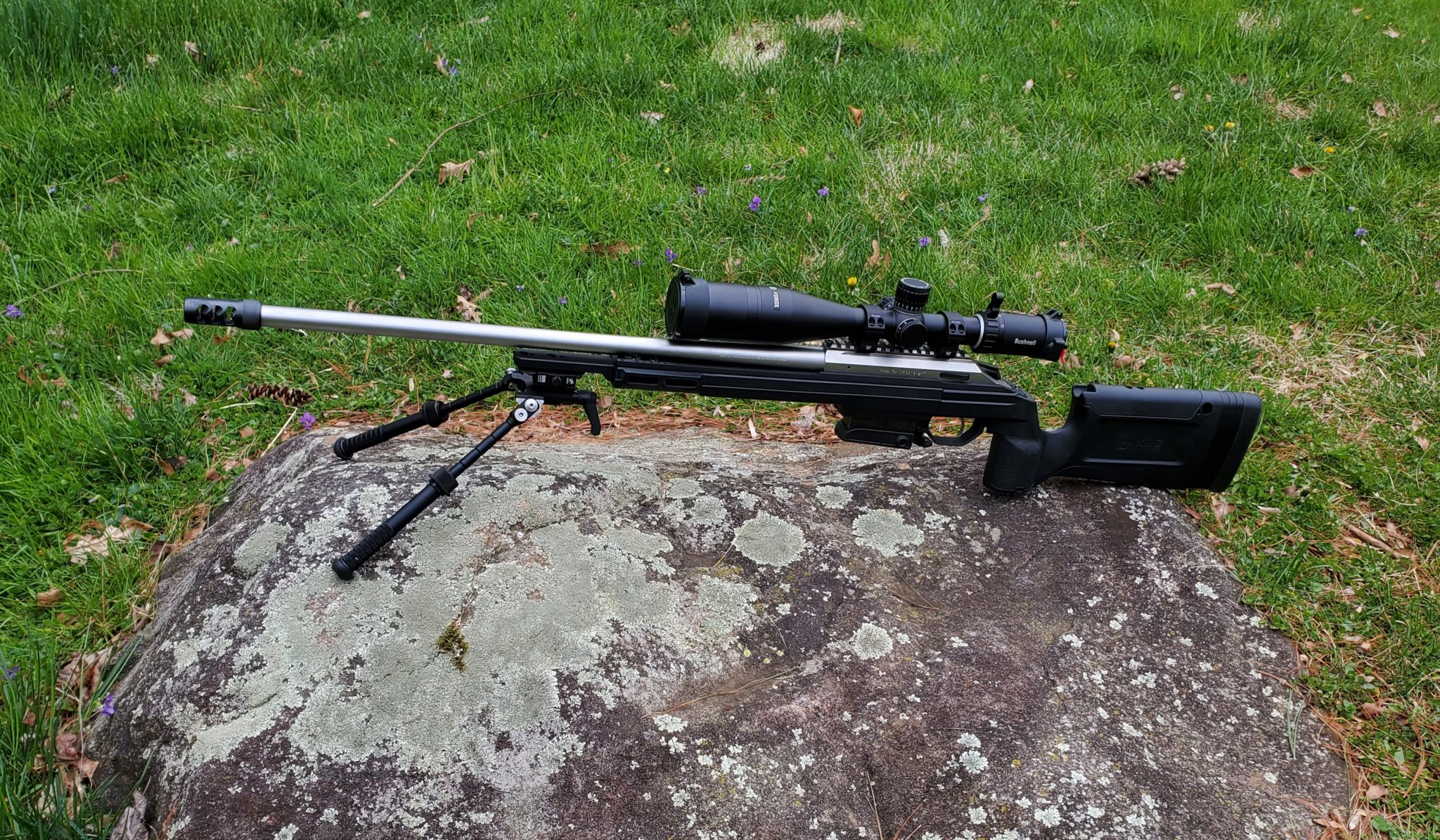

For now the rifle will be used for target shooting/hunting.. looking to upgrade to an amg soon. Want some better rings and 20moa base. Still trying to figure out what height rings I would need with the pmr's
So you will have to add height as that base now looks like it is integral to the action. Is that true?
Then I would go a little higher than you have now. I have my AMG in .97" height rings on a 20 MOA base and it had plenty of room but not too high. A good height in my opinion.
Reactions: Qwkcrss
My advice from owning several Tikkas would be to get your 20 MOA base first, not all bases are machine the same and so you may actually be picking up some extra height depending on which base you buy so I would get the base and swap it out then check how much space your current scope and rings have over the barrel and then you can make the decision of whether to go up or down in ring height from there
