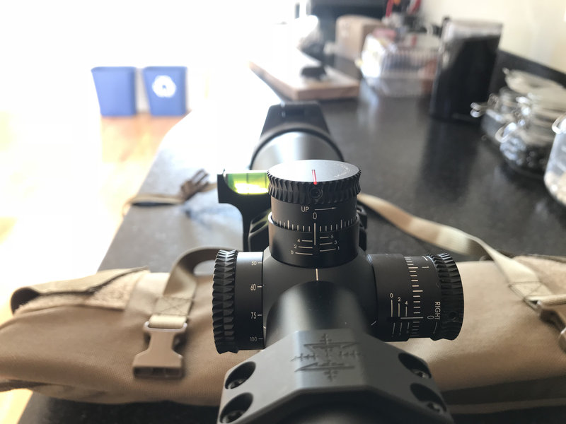

I zeroed my new Bergara HMR yesterday and went to set the CRS zero stop. I shimmed it per the instructions, but had a question regarding the elevation zero reference lines on the scope body. Mine will not go below around the 3 mark. Should it go down to 1 or 0 instead? I've done a search on the web for this and watched the Vortex zero stop video a few times and theirs goes lower than 3 when being set.

Mine is just a tick above the "1" on the scope body. This is zeroed with a 20 Moa base. Viper pst gen 2 5-25x50. No shims though, I must have a different zero stop. It involved set screws and such. I know right out of the box the directions had me turn the elevation a complete rotation down I think before setup. Could missing that step come into play here?
Have you figured up the total elevation adjustment you have available to you?
Also, does it move with each click or are there segments where you can turn the turret and not have any movement taking place?
