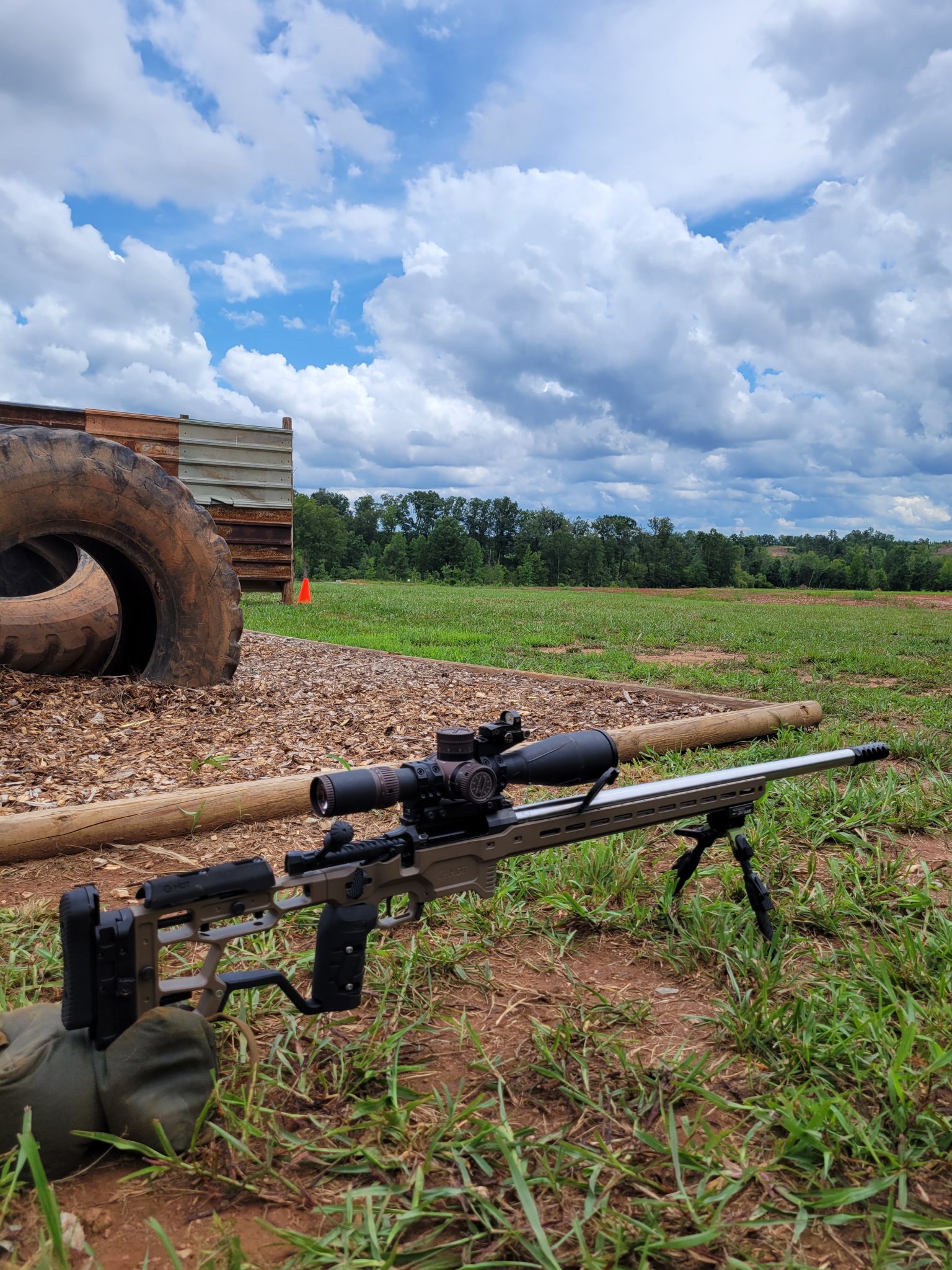

The Spuhr you want is a 4002 (1.5" (Discontinued)) or the newer model the 4002C which is also a 1.5"
