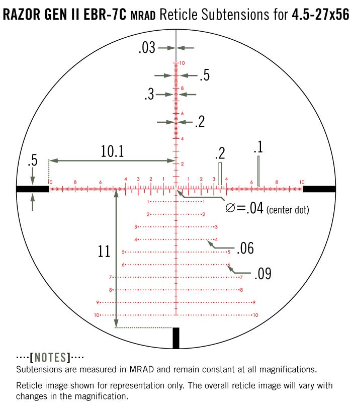

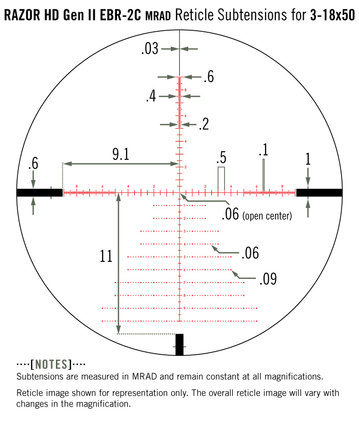

Vortex customer service got back with me today:
Good afternoon,
Thanks for reaching out!
A couple of us from Consumer Sales met with two of our top riflescope engineers to discuss your question. In digging through designs we found a discrepancy in what is published on our website today. In fact on the 3-18x50 EBR-2C MRAD, the vertical stadia thickness is .04 MRAD and on the 4.5-27x56 EBR-2C MRAD it is .03 MRAD. This is being validated by our engineering team but we're confident it is correct. Naturally, we're going to have to work with our website team to get this information updated.
As for the EBR-7C. Because the new reticle has a floating dot with a thickness that matches the width of the vertical stadia, we're pretty sure that this error did not carry over from the EBR-2C. Having said that, we're doing some additional cross checking. However in looking at the design drawings, some potential discrepancies were discovered with the stadia thicknesses as well so we're checking into that.
Thank you for bringing this to our attention! I would like to send you some swag out Wade...what size shirt do you wear? Can you pick a hat from our website - https://vortexoptics.com/more-products/apparel/mens.html
Please let me know!
I was correct and was spot on with the .04mil thickness in my observations.

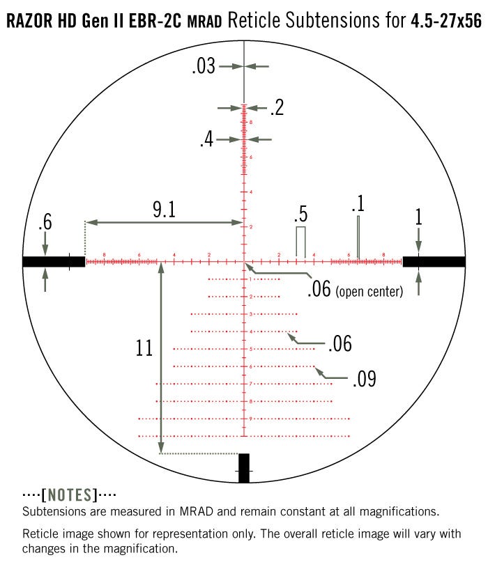

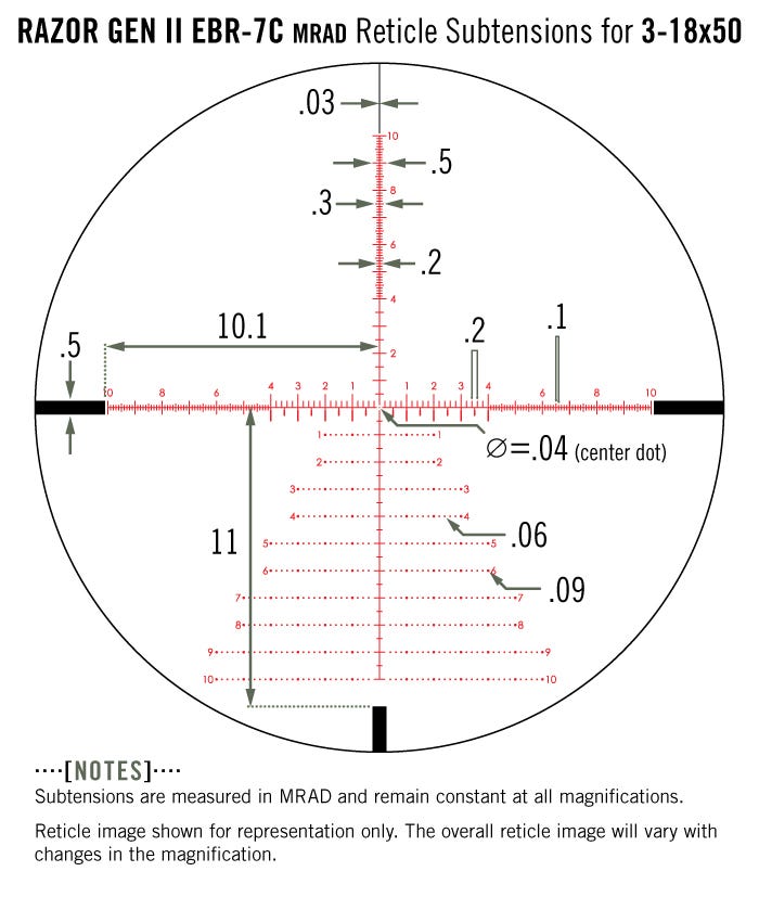

The EBR-7C reticle on both the Razor HD Gen II 4.5-27x56 as well as the 3-18x50 have a primary stadia weight of 0.03 MRAD thick. When compared to the EBR-2C reticle, the primary stadia also has the same weight of 0.03 MRAD thick. I have attached images to reference. Something to note is on the EBR-7C the vertical lines moving left and right of the primary vertical stadia at the bottom of the horizontal have slightly heavier subtensions every 0.5 MRAD out to 4 MRAD. This is to help retain viability at lower magnifications and is a useful aid when engaging moving targets. I hope this answers the question.
Reactions: 1911hombre
So to wrap it all up, do the EBR-2C reticles in fact have differing sub tensions between the 3-18x and the 4.5-27x?

The weight of the primary stadia lines of the EBR-7C on the 3-18 and 4.5-27 are the same (0.03 MRAD). The only subtension lines with heavier are the hash marks described in my previous comment. The photos supplied in that comment should provide the info you are looking for.
I was asking specifically about the EBR-2C. I give up.
Reactions: wade2big
My apologies. Please see attached. The line weight is still 0.03 MRAD on both. I hope this helps.
