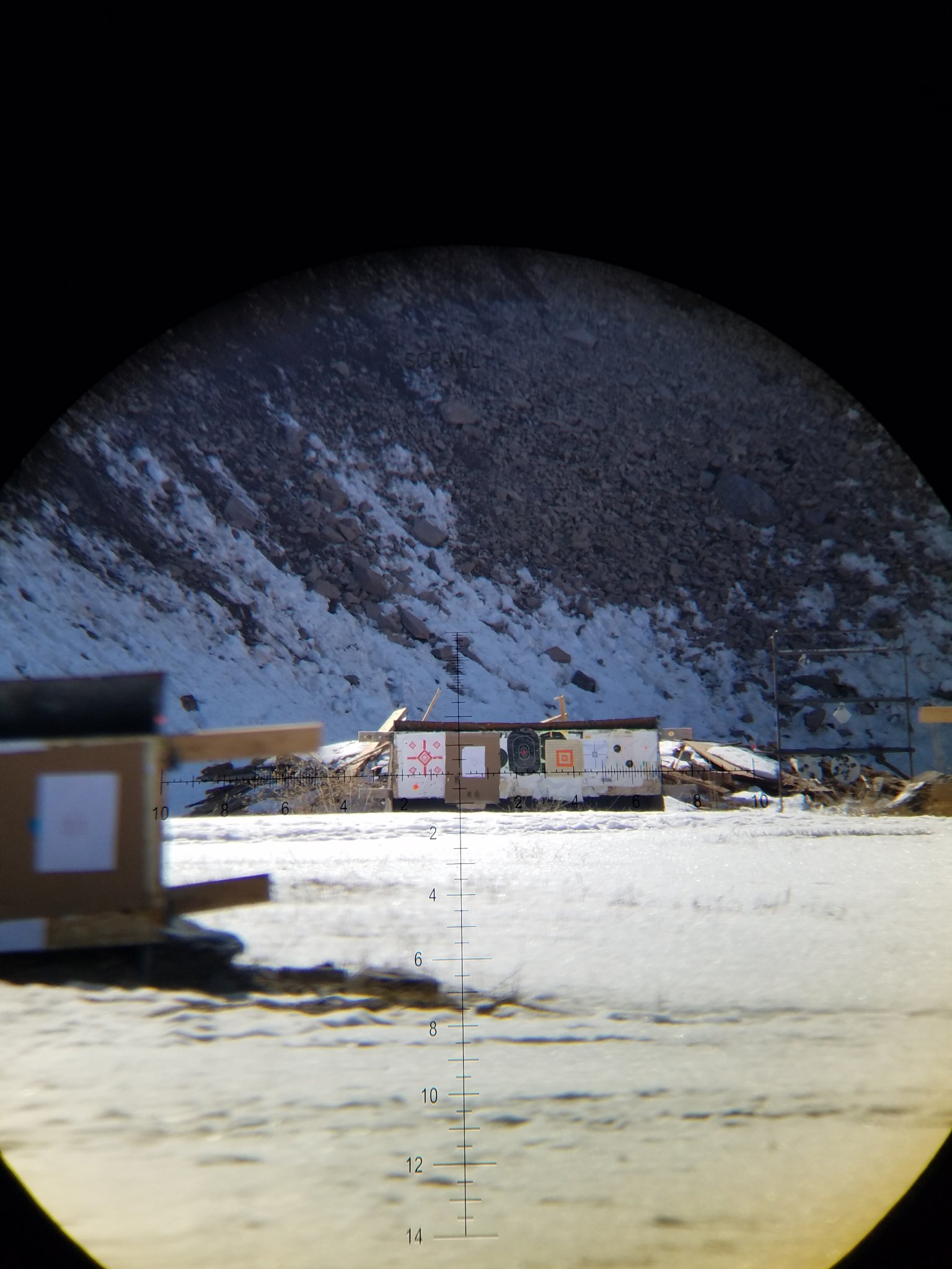

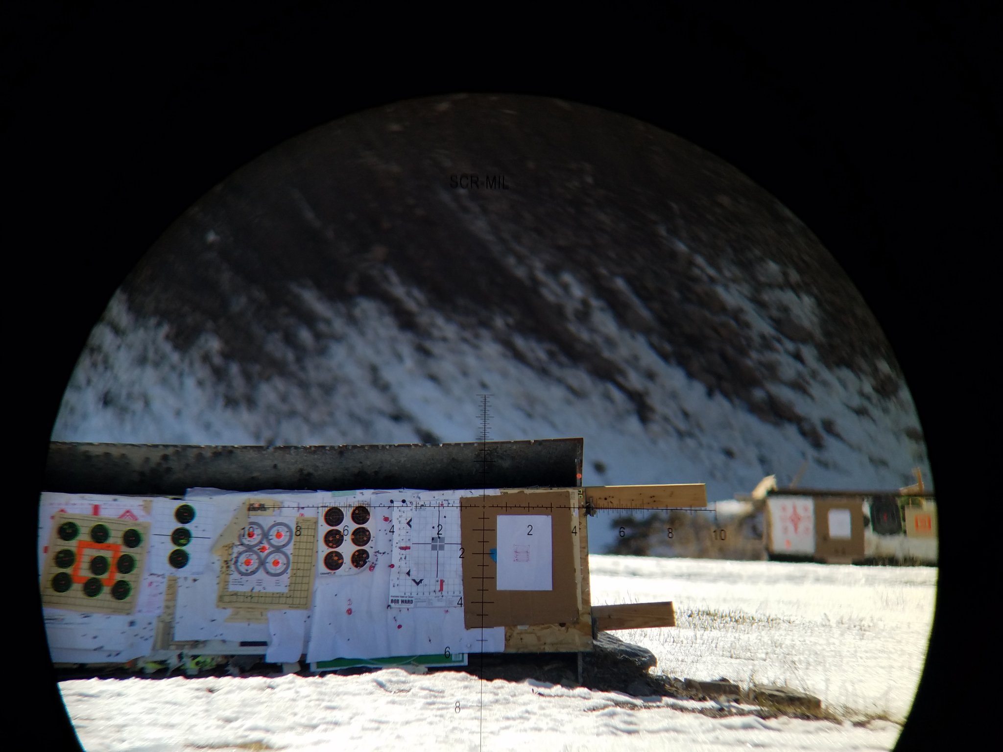

Thought I would share.
I tried the Burris eye piece (Burris 626201 Spotter Eyepiece, 30X WA, Scr Mil) on my Vortex Razor spotting scope (RZR-A1). I did a simple test at the shooting range. White printer paper at 100 and 290 yards, well that’s what my range finder said.
I didn’t spend too much time but it seemed to look just as good between eye pieces, at least not noticeably worse. I would say it works.
I am sure the pictures don't do it justice, but to see if the reticle is true.

Not sure if this helps. But using the picture. 8.5inch wide paper measures .8 mil so 295 yards, rangefinder said 290. Accurate enough for me to estimate range.
