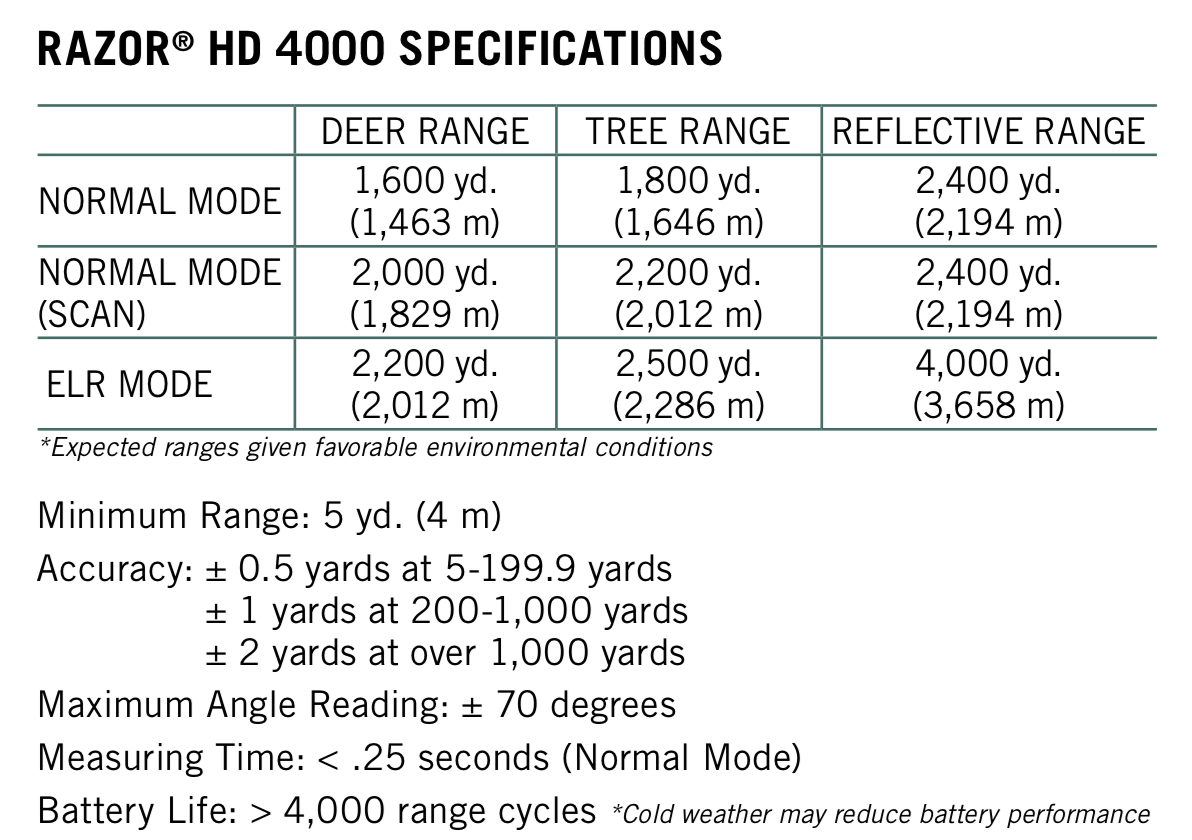

Priced right. Just called and the beam divergence is 2.0x1.0
Why come out with a new rangefinder and have it already behind
some of the competition?
They should know that most will be ranging steel or some targets
at extended ranges, ( 600-1500 yds. )
Leica 2700 and 2800, the new Leupold 2800 have half that
I really like their products, but seems like a waste of time
in a already crowded market.
Hi everyone,
I just want to clarify what might be a typo above. The beam divergence is not 2.0x1.0. It's 2.0x0.1 ("zero point one"). So, it's a very thin line. While 2.0 on the long edge may seem like a lot I have used and tested this rangefinder extensively as I oversaw the team that developed it. We also had no trouble hitting 1M sized targets at over 4000 yards and beam divergence was not an issue precisely picking up 1M sized targets from clutter around the target. We also used a stop sign (about 0.75M) since we knew customers use street signs to test sometimes and had no trouble with beam divergence. It is absolutely a completely new rangefinder and recycles nothing from our previous offerings. The optics are by far the best we have ever had in a rangefinder and from our analysis rivals or beats any other handheld we have looked at for optical quality. Ranging performance is phenomenal. We actually got over 4000 yards on reflective targets. I personally took a prototype out to Montana for the Unlimited Sheep hunt last year. I was pretty much ranging anything in sight. I hit trees at 2300 yards on a single momentary press in normal mode (no scanning necessary), with instant returns (0.25 seconds is the normal return rate unless in ELR mode and scanning...see our video for more explanation on the various modes). For hunting it was stunning. I thought to myself, "there is no way I would ever need more range performance than this for hunting anything." I was also hitting deer at around 2000 yards (unfortunately I was not hitting sheep with my laser). It's slightly less range on animal hide than trees but still does fantastic. The display is also a completely new type of illumination technology which makes this display able to go brighter than anything else on the market in a hand held rangefinder, to date. It's bright enough to see the red display against snow on a bright day. The display is also a lot more energy efficient so even at the highest brightness setting we are meeting or exceeding battery life of our previous rangefinders or other models on the market. A couple of other tidbits: Magnesium body, buttons are much more ergonomic and work awesome even with gloves.

Dave, I called and received an email from Vortex. And only posted this
after receiving the two. This does change my original post and sorry to anyone
that might have been swayed, but I can only relay accurate info given to me
at that time. The 2.0 is still more than Leupolds 1.172 round and Leica's
2700 .5x1.2 I know the Leica is more $$ but Vortex should have come out with a
industry leading range finder in that price range.
I'm not bashing Vortex, I own and like all my Vortex item, just saying, if coming
out with something new, make it better than everything else in it's price range.
Everyone is entitled to his or her opinion, just mine. Take it or leave it.

The long edge is horizontal to the unit when held normally. If you need to range between narrow tall objects you could turn the unit sideways...or better yet you could use the first mode or last modes. Speaking of which, often times the desire for a smaller beam divergence is to discriminate a target among "clutter" either in the foreground or the background. The "first mode", "last mode", or "normal scan mode" can be used to help with this. Here is a video explaining these modes, how to use them, and how they work on the Razor HD 4000:

.1 itself is amazingly small, I wonder if it is 2mils wide and .1 in height for PRS or just shoot’n steel out in open country. I know for me at least 2 mils wide or high is a no go for anything I do here in the Rockies.
I had a tough time with the 1.3 round of the 2400 ABS, had to scan around target desired and eliminate the surroundings by visual evaluation.
I cannot afford to be off by 10 yards on a longish shot because I ranged the tree next to and in front of the Bull.
I went to the Leica 2800.com primarily because of the .5 high x 1.25 wide. I carry a card with me for beam size at yardage. I believe I recall Bryan Litz said that most missed shots are due inaccurate range.
