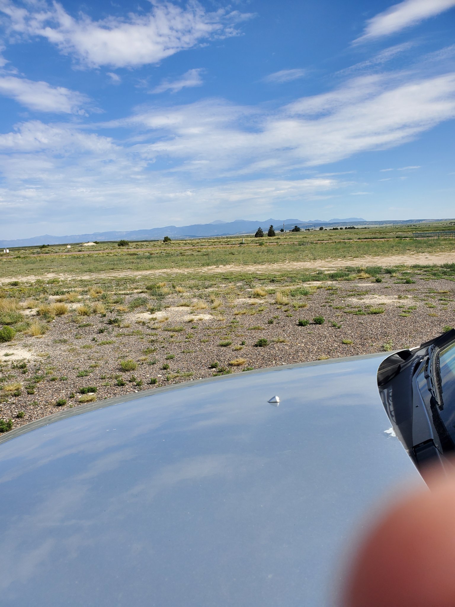

Just got mine and got to use it this weekend. Impressive. Shot steel to 1980 hand held. Stabilized it on truck window and got better readings, but damn. This thing is fast and accurate. A few others got to use it too, they were equally impressed. We all got same readings on multiple targets out to 1080 without any support or tripod, just hand held. It is worth the $$.

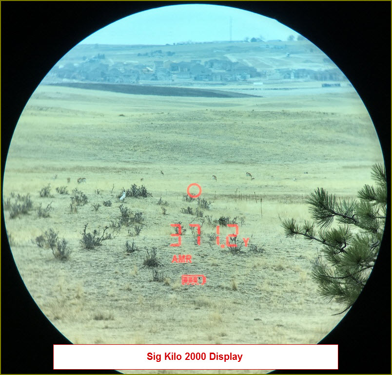

I currently own two range finders: a Leica 2000B and a Sig 2000 that I bought when they were first released. My issue with them both is ranging steel at distances greater than 700 yards or so. I have no problems ranging a big ass water tower at 1830 yards, or a rock at 1100, or a house at 985, etc., but as soon as I shrink the target down to a 3/4 IPSC at 750 yards, or a 2.5 MOA target at 1080 yards, or a 10" gong at 925 yards, I can't seem to get a good, repeatable distance. Perhaps I am exceeding the capabilities of the devices, which is a possibility., but I haven't found a range finder that can reliably handle smaller semi-reflective targets, especially if that target has been shot up by the four or five squads ahead of you. What sized steel targets have you ranged with the Razor 4K and at what distances?
Reactions: John Glidewell
I sold my Sig Kilo 2k for same reasons you outlined. The steel I was ranging was 17" and we ranged it at 1080 by hand and 1980, but we had to stabilize in truck window to get consistent readings. Steel at all closer distances were no bigger than 14". The Vortex Razor HD 4k is a great range finder. I did not even have to use the ELR mode.

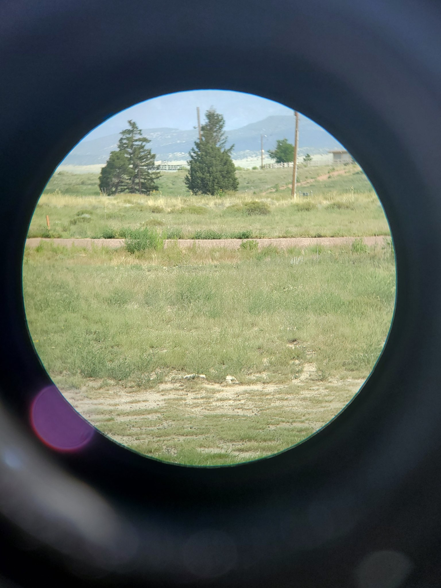

Ranged black/brown power line polls to signage in the area. High 85-90deg F with plenty of sun and mirage.
I started off ranging from the power line poles to the signage. Then hiked back and ranged from the signage to the power line poles.
I was able to get the same reading on multiple attempts. I’d let the unit turn off, come off the target, get back on the target, and re-range. Minimum was 5 range attempts.
My offset is at the 11 O’ clock position right inside the circle. Literally on the left hash of the vertical line and inside the circle.
Power line pole #45 to park sign 593yds
Park sign to power line pole #45 596yds
Power line pole #46 to park sign 724yds
Park sign to power line pole #46 726yda
*The difference in yardage is due to me standing a couple yards off of the power line pole and in the trail
There were some ranges I could not range back due to traffic and neighborhoods.
Power line pole #45 to traffic sign 650yds
Power line pole #46 to traffic sign 778yds
Power line pole #46 to furthest power line pole 1312yds

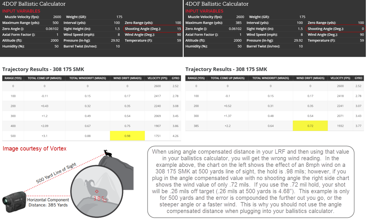

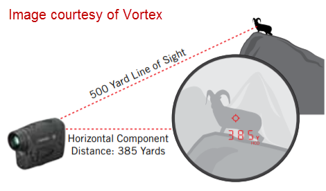

For those with the Vortex HD 4000, I’m too lazy to read through the manual, I do not like HCD mode because it can throw off wind values so I’m wondering if they have a mode that does LOS and also shows the angle value?
What does it do to the wind?
I'm glad you asked because I think a lot of shooters don't realize this. In fact, I didn't realize it until Frank mentioned it in one of his podcasts and I had to rewind and listen again and then it dawned on me - "of course, the angle compensated value is going to be shorter than the flight path of the bullet". So if you use an angle compensated distance it will give you a reading that is different from LOS because it is compensating for the angle; however, that distance is different from what the actual distance is and when shooting long distance the wind has an effect on the bullet the entire path. Take the example that Vortex gives in their manual:
So if we use these values, go to your ballistics calculator and punch in a distance of 500 yards, then punch in a distance of 385 yards and put in a value of say 8mph wind, now look at the resulting wind values between both, you'll notice there is more holdover for wind on the 500 yard results vs. the 385 yards. So if you use the HCD (or whatever the mfr calls their angle compensation algorithm) and then you punch that into your ballistics, you will get the wrong wind hold value.
Edit: I decided to throw together this graphic as an example, it's going to be different for every condition and cartridge, but this serves as a baseline to explain why using angle compensated distances in your ballistics calculator can give you an incorrect wind hold value:
BlBennett1288 - were you lazing the skylined parts of the poles, or the bottom parts with vegetation background?
