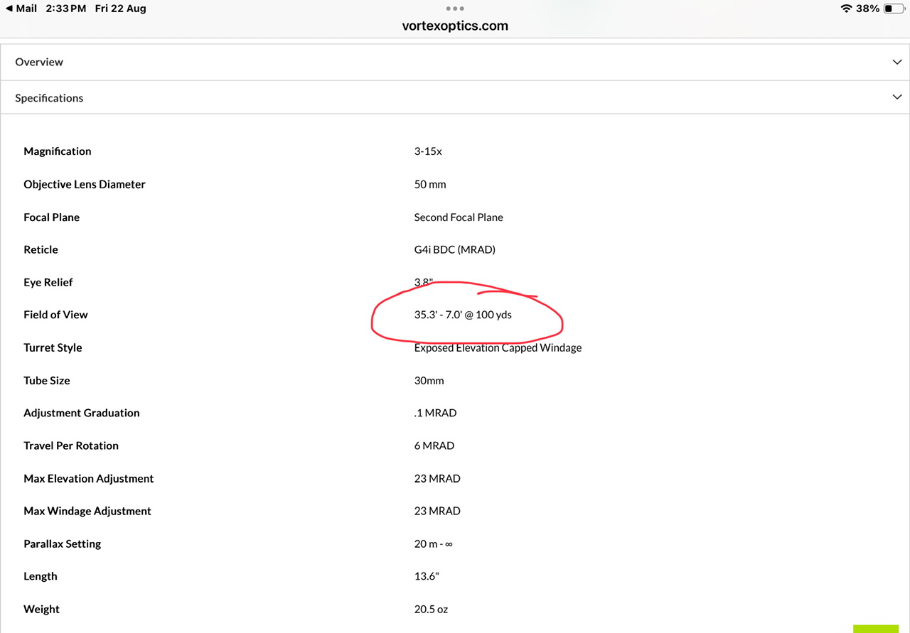

I was looking for specs on these scopes and couldn't find the one I am looking for. Does anyone know if the apparent field of view is the same on the 3-15 LHT and the 4.5-22 LHT?
The Vortex Razor LHT 3-15x50 and the Vortex Razor LHT 4.5-22x50 have different field of view (FOV) ranges. Here are the specs:
  • Razor LHT 3-15x50
    • Field of View: 35.3 – 7.0 feet @ 100 yards
  • Razor LHT 4.5-22x50
    • Field of View: 23.5 – 4.7 feet @ 100 yards
the 3-15x has a noticeably wider field of view at the low end compared to the 4.5-22x.
shameless plug :)
Apparent field of view isn't on there unless I am missing it.
It is listed under specifications. Scroll down on the link above to under where they show the scope with measurements and you will see specifications. Click on it and the drop down below will be shown.
That’s field of view, not apparent field of view.
Apparent is linear fov/magnification and is a function of the eye piece rather than the objective. The angle you are seeing vs the linear measurement at a prescribed distance.
So 35.3/3=11.767 and 7/15=0.467 degrees

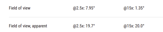

Do you happen to know the Maven RS1.2 2.5-15x44 AFOV off the top of your head? I'm definitely curious now.
Believe it or not, Maven actually lists standard FOV, angular FOV, and apparent FOV in the specs... that's awesome, and I wish more manufacturers would do that! I believe this is the first time I've seen all 3 FOV specs on a scope manufacturer's website.
20 degrees AFOV is a bit on the narrower side for today's optics, but right in line with the LHT. Also, almost no tunneling (probably nearly if not totally imperceptible to the user) as the AFOV only changes 0.3 degrees between 2.5x and 15x.
