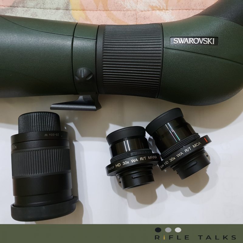

I ran across a birding article/post etc. the other day about putting the Vortex Razor eyepiece on the Swarovski bodies and vice versa, seemed like they were interested in using the Swaro wide 25-50 on the Razor scope body. However, it seemed hit and miss from various posters if it really worked depending on the Swarovski model.
Has anyone verified the Razor HD reticle eyepiece will fit on the Swarovski ATS/STS bodies and yields the correct subtended moa/mil marks? Might be a cost effective way to get a reticle into a lot of older swarovski spotters for guys. Still rather have a STR-80, but for $3000 less the Razor HD reticle eyepiece might be worth the gamble to try on my STS-80HD
If you are referring to the gen 1 Razor HD ranging reticle, then yes. I currently utilize a Zen Ray and it works fine. After purchasing the Zen Ray, I took the Ranging reticle to my local dealer and we tried it on the Swarovski. Not sure of the model number. It worked fine. All subtended Mil marks appeared to work fine. I see you are in Pa. I currently reside in the Carlisle area. If you are close and the Coronavirus subsides, let me know if you want to try it. Good luck.

Only Vortex that fits Swaro is the first gen. And they're hard to come by, anymore....

I have both moa and mil vortex reticle eyepieces bought in 2018 from norway and they fit my swarovski ats 65. What i want to know is whether they would also fit the swarovski STS80mm spotter as i would like a slightly larger objective than the 65mm
