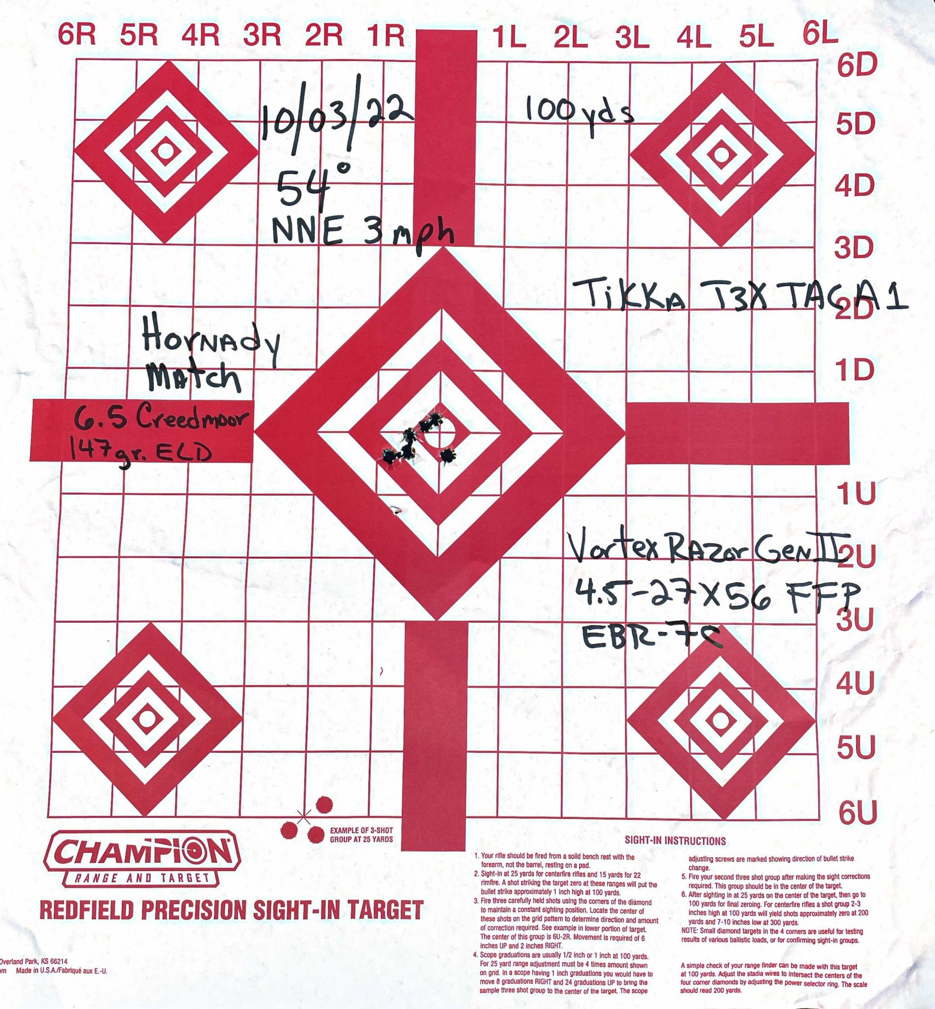

Thanks, it will help me as well. I just zeroed a new scope today. Vortex Razor Gen II 4.5-27x56. Now I have to reset the zero on the scope. Thx
