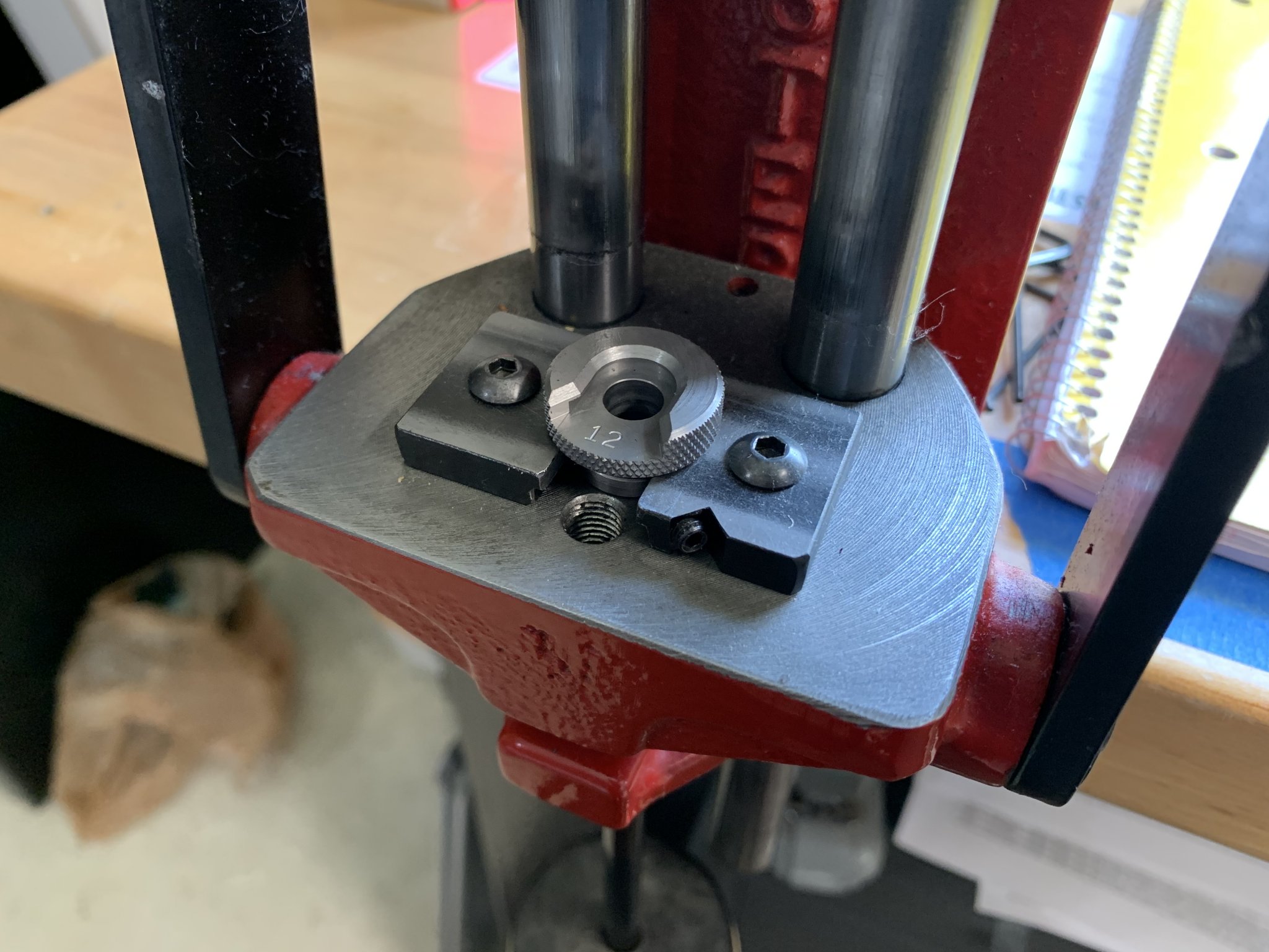

    I never had any issues with the standard jaws on mine. I retro’d It to use shell holders a long time ago though. I like to use Redding comp shell holders for adjusting bump, much simpler and more consistent. (The shell holder pictured is not a Redding comp)

    Where did you get the plates to
    Hold the shell holder? I love my Redding Comp shell holders and that is the ONLY thing I’m not excited about with my new coax.
