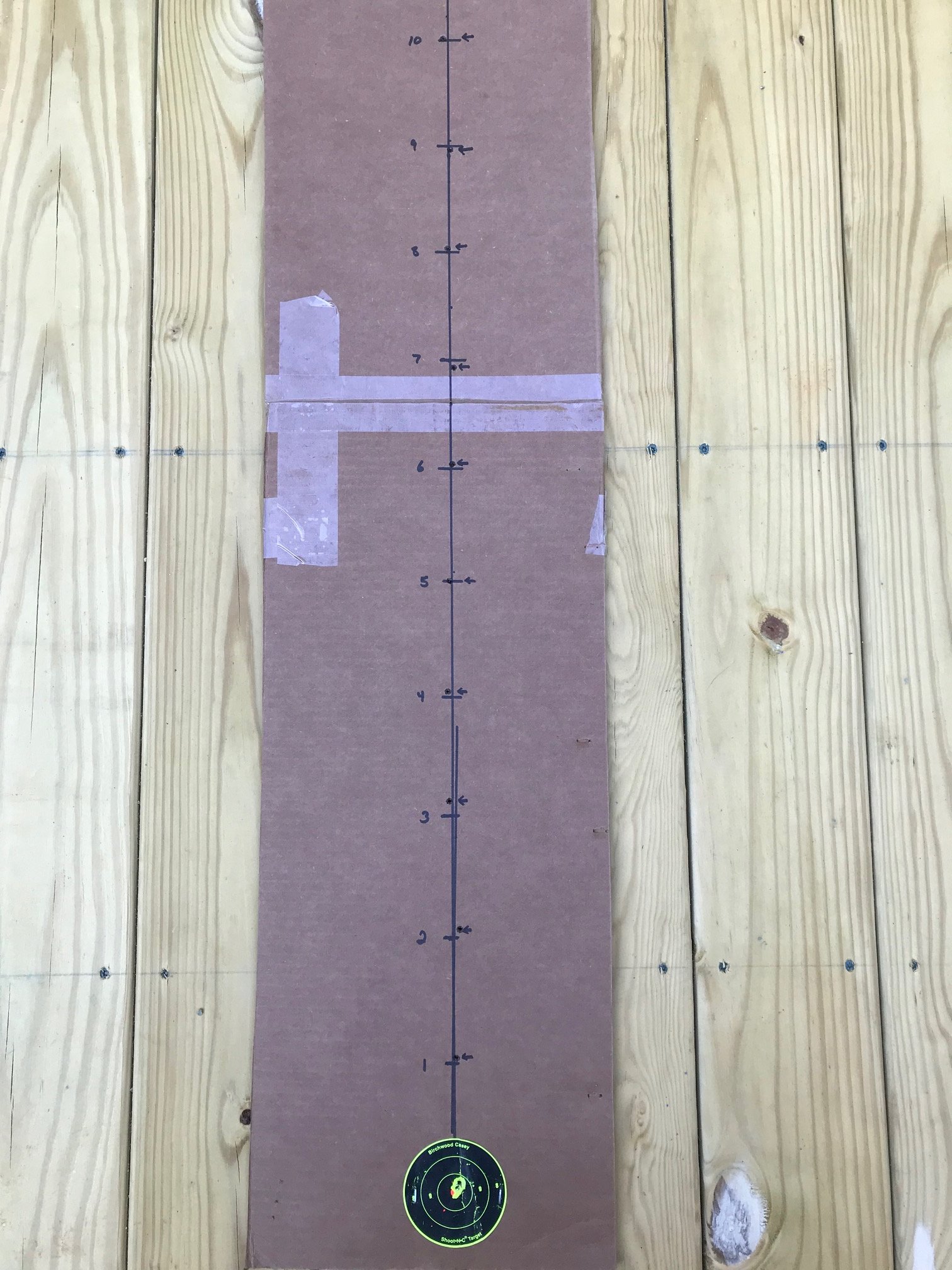

Can't watch the vid(my issue). How was the tracking?
I have not done a tall target test or box test, but have dialed to and from 16.5MOA and back and in the middle several times. This being done with verified velocities and solutions from my kilo 2400ABS. I'm sure there are some errors, but for the distances I have shot so far, it has been good. I plan on doing a tall target test soon. I will post when I do.

I took my usual 100 yard tracking target and put it at my 50 yard range at home. Laid the reticle against it and it was right on. Then I shot the target. Being at 50 yards each space is 2 mils so the 10 mil mark is 20 mils. I dialed up to 20 mils at 2 mils each. I think it did pretty good. As you can see from the bottom before and after the zero was a little high to begin with but after dialing back to it it was right there for return to zero.
