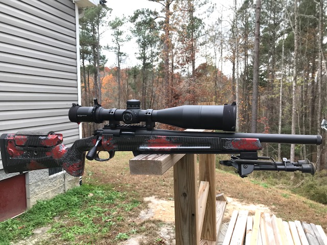

I bought a set of used Warne rings when I got mine and they are about 1.1" in height and look like this with the Strike Eagle on my Vudoo.

Are those the Warne Mountain Tech 34mm, Medium Matte Rings, model 7221M (1.07" high)? I'm hoping your answer is yes, I have a set of that model that I'm planning to mount my Athlon Cronus BTR Gen 2, 4.5-29x56 scope on top of my Vudoo when it shows up in a couple months.

Yup Warne Mountain Tech and I believe those are the height. I was looking for some 1" high rings but these came up for sale and I figured they would work and they did.

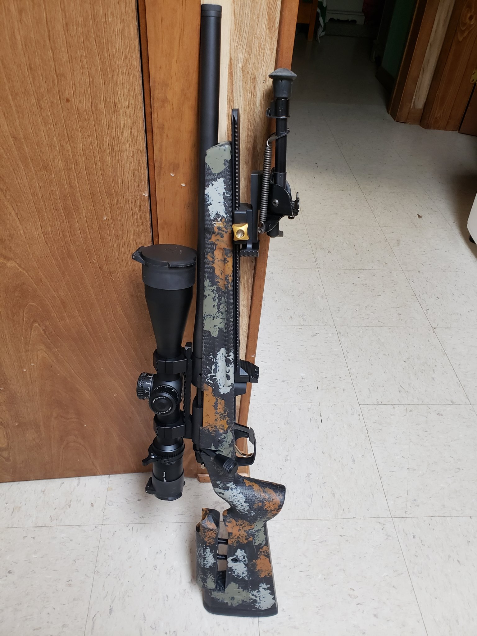

Here's a Stike Eagle on a Warne Skyline medium height mount.
glad to see a strike eagle in a warne skyline medium mount. just ordered one last night for my strike eagle. Will temporarily live on my 300 PRC until i can get a MK5HD on it, then the eagle will get moved to more of a plinker. Your rail to barrel distance looks closer than mine on my 110 FCP so i should clear by about 3/8" more than you do. How are you liking the mount so far. It checked a few boxes i was looking for 7075 instead of 6065, no large nut to tighten to rail. Aesthetically pleasing.
I have 4 of these mounts, on 22LR, 17hmr, 6CM and 6.5CM. I haven’t had any issues with the mounts loosening or any kind of shift in my zero and I don't baby my rifles. I frequently carry and move my rifle using the scope. When you use the PRS discount it is a greatoint for the money👍
PRS discount? I got mine on a ebay auction. Won the auction at $140.18 shipped. Should be here in a day or two. New still in the original box, far less than i see them for sale anywhere else.

Is that a KRG chassis? I am trying to avoid buying a Vudoo and failing but am stuck at few options available ASAP. No mid priced chassis are available only KRG Bravos or Accuracy Internationals.
Either way that looks sharp.

pretty sure that is one of the Manners competition stocks. Looks like it's the MCS-PRSIT

Thanks but as mentioned it’s a Manners but the PRS2.
